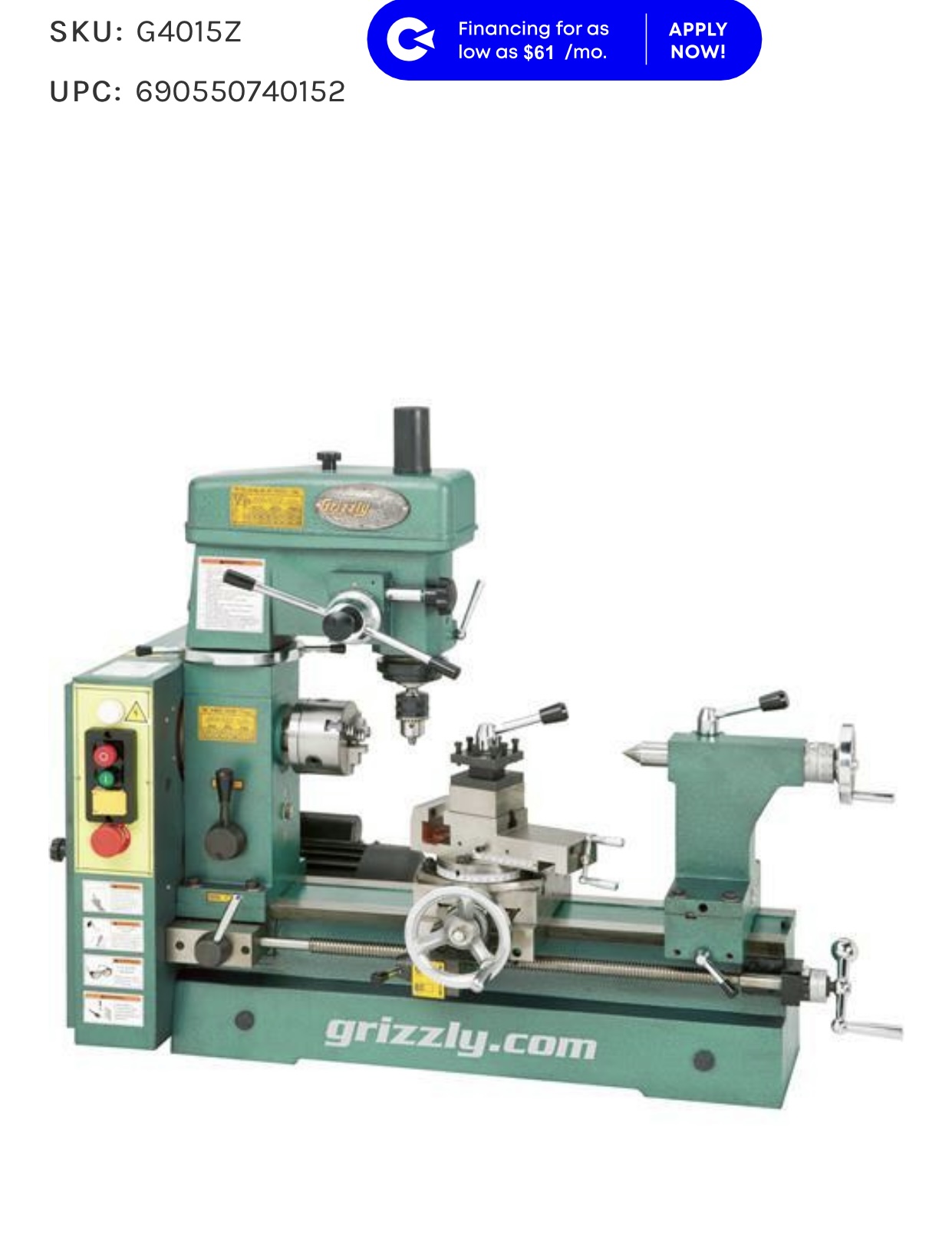

Go here and see an example of a mini combo unit by Grizzly:
It's only 10" between centers, so that would limit the length of any bbl's you might want to turn, but you would have the capacity to turn many small things such as firing pins, etc. At the same time you would have the capability to mill just about any part you might need. (y)(y)(y)

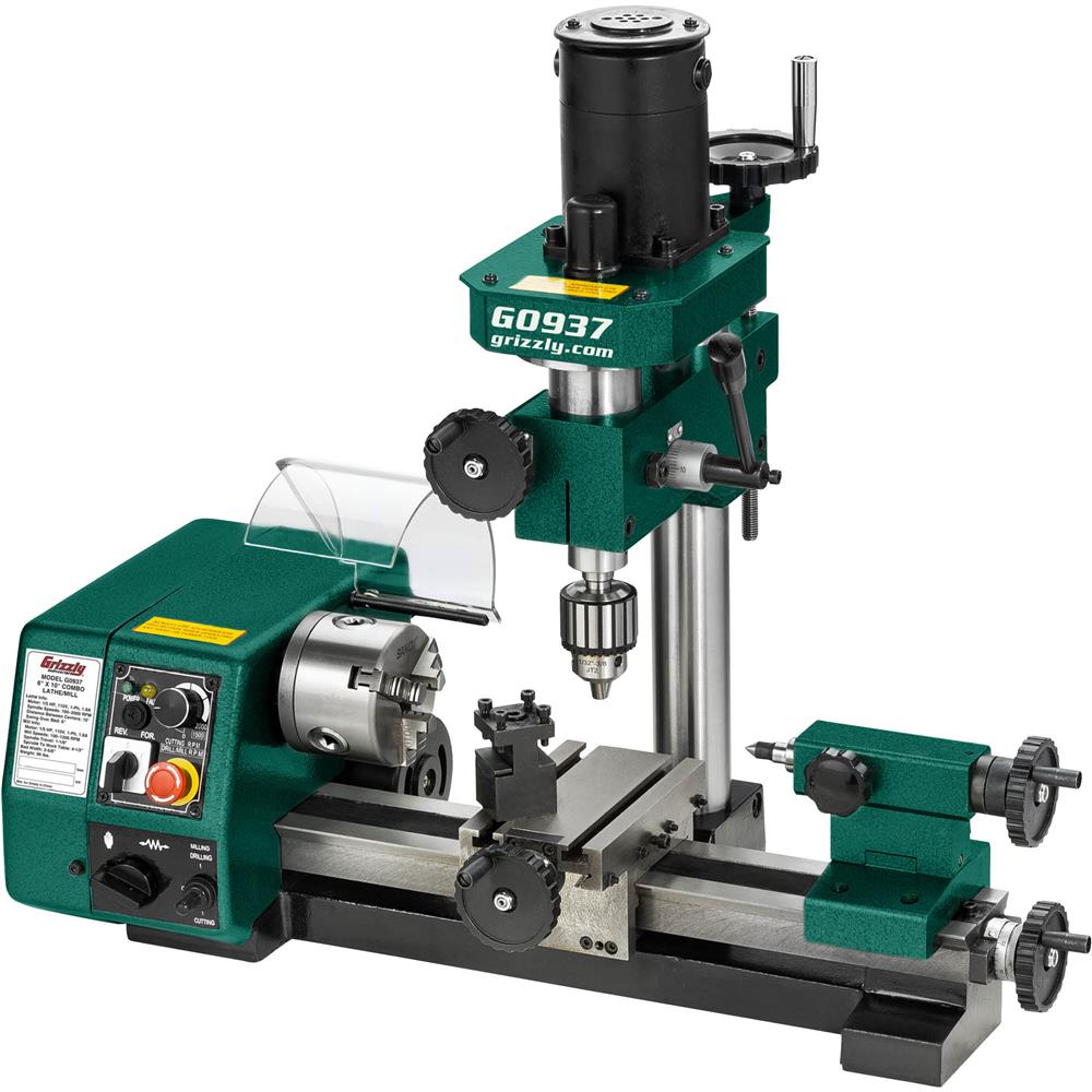

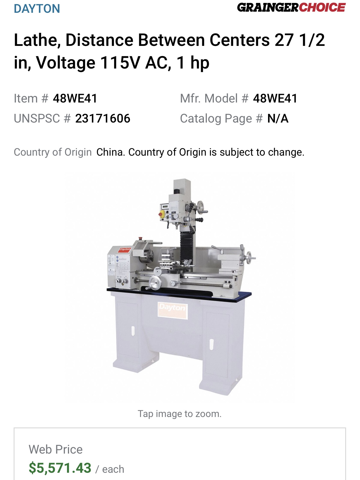

Or look into combo units.
