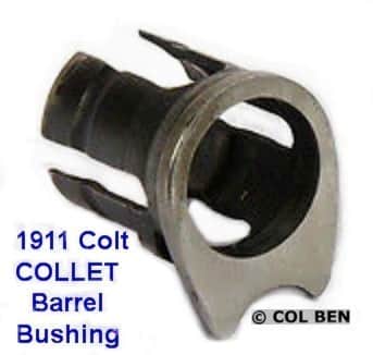

I had the barrel bushing on a 1911 shear the two lower “ears” off, was pretty much decided it was a metal fatigue issue.
Was it the bushing with the 4 fingers, series 80? If so, they were prone for breakages, like the one here?
I always kept spares of these, they would break all the time.
Nope; it was a standard GI style on a Norinco.
A few folks knowledgeable in metallurgy looked at it, said it appeared there was a stress fracture on one of the ears, and the other let go when the first sheared...possibly one sheared first, then the second let go a few shots later. But one side appeared “torn”, which was the second one, most likely.
Replaced it with a Ed Brown bushing and didn’t worry about it....and I now mainly use it as a .22 with a Kimber conversion slide.
