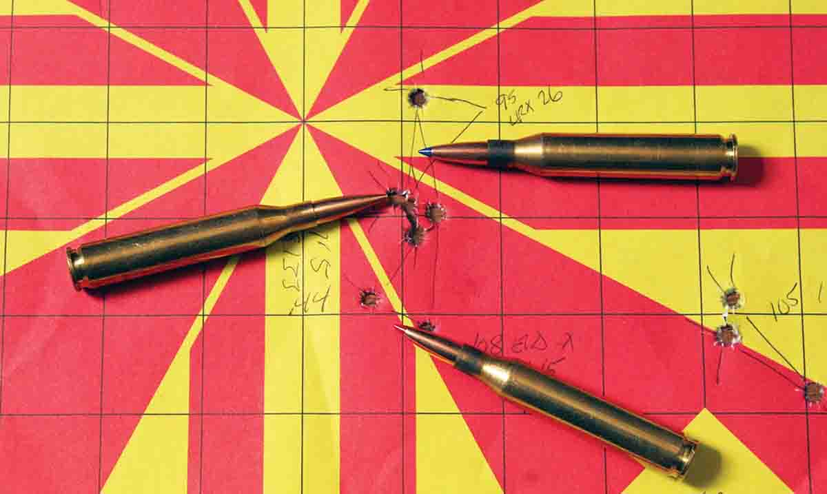

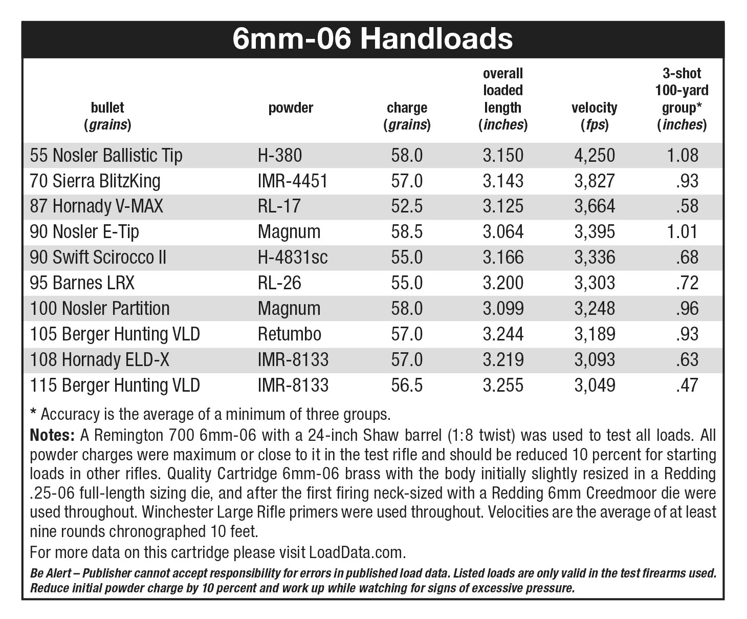

Modernizing the 6mm-06
New Powders and Bullets make it sing.

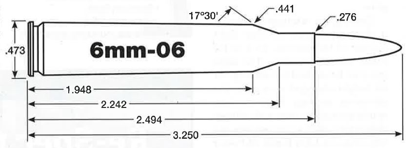

Somewhere in the wildcat universe, the 6mm-06 wildcat appeared, but apparently never became very popular. In fact, the wildcat section of my modest collection of Cartridges of the World, ranging from the 1979 to 2013 editions, does not mention the 6mm-06. Neither does P.O. Ackley’s 1962 Handbook for Shooters and Reloaders, probably the most complete compendium of mid-twentieth-century wildcats, but it does include the .240 Super Varminter, the .270 Winchester necked down, essentially the 6mm-06 with a longer neck.

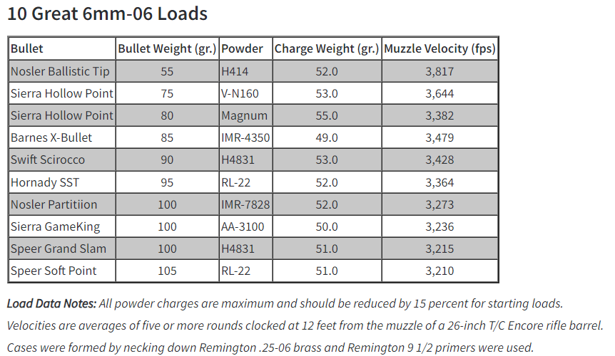

The 6mm-06 By Chuck Hawks

I built mine on a 7tw Kreiger. Shoot 115 Berger. I used re26 and have great luck. I will have to get my log for numbers. I started with 25-06 brass but wish i used 270.
