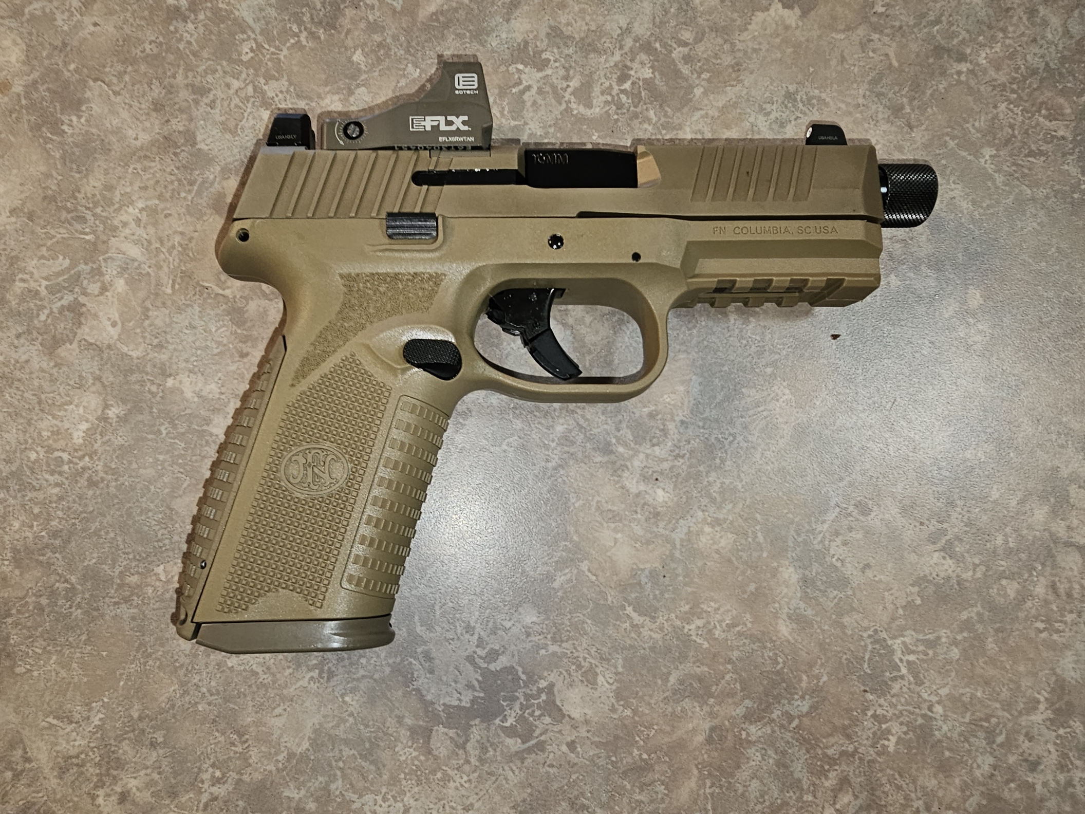

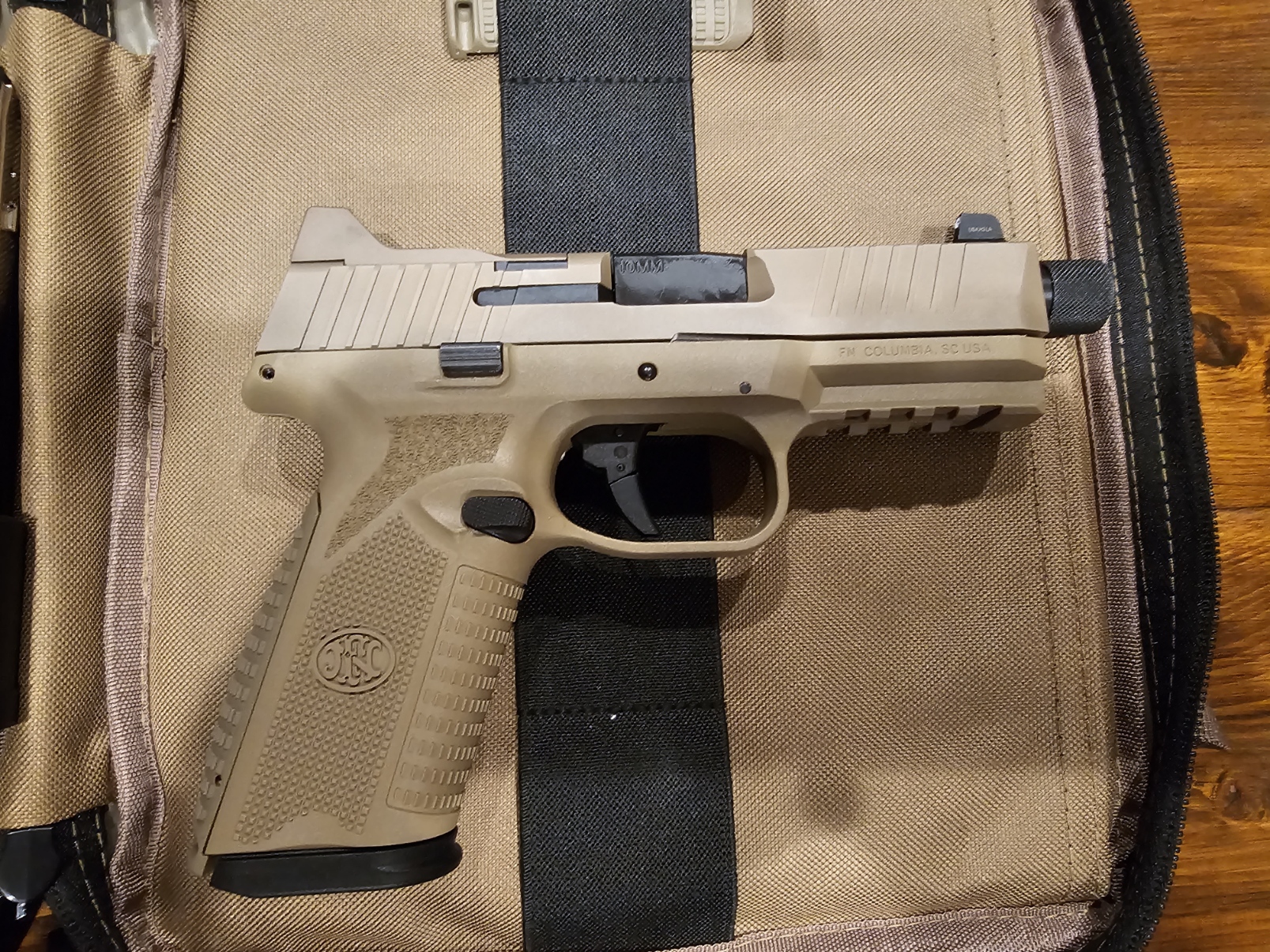

So I got me a FN 510 to go with my SA XD-M Elite OSP 10MM.

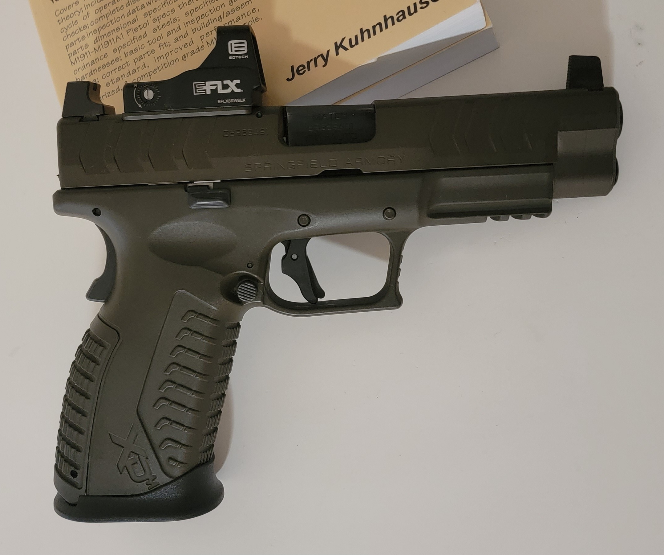

BTW, since I liked the Sportsman Warehouse exclusive OD Green XD-M 10MM, but can't get one since I am in MD, I cerakoted mine in OD Green, but over the entire pistol, not just the slide...
Love the 510's FDE, but can't help to notice the unsightly contrast of black.

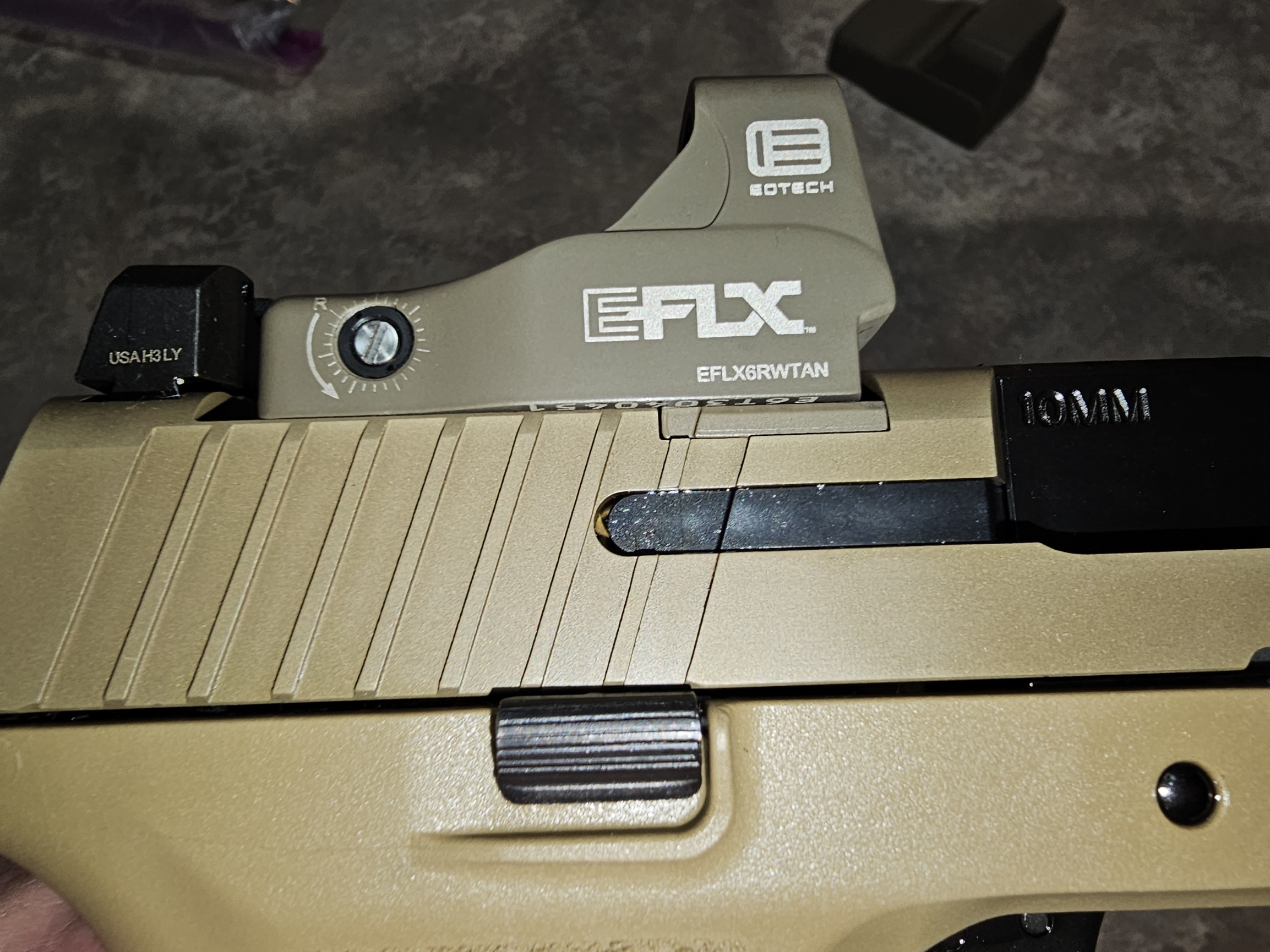

I also fitted it with a EOTech EFLX now available in FDE, but a different shade than the FN...

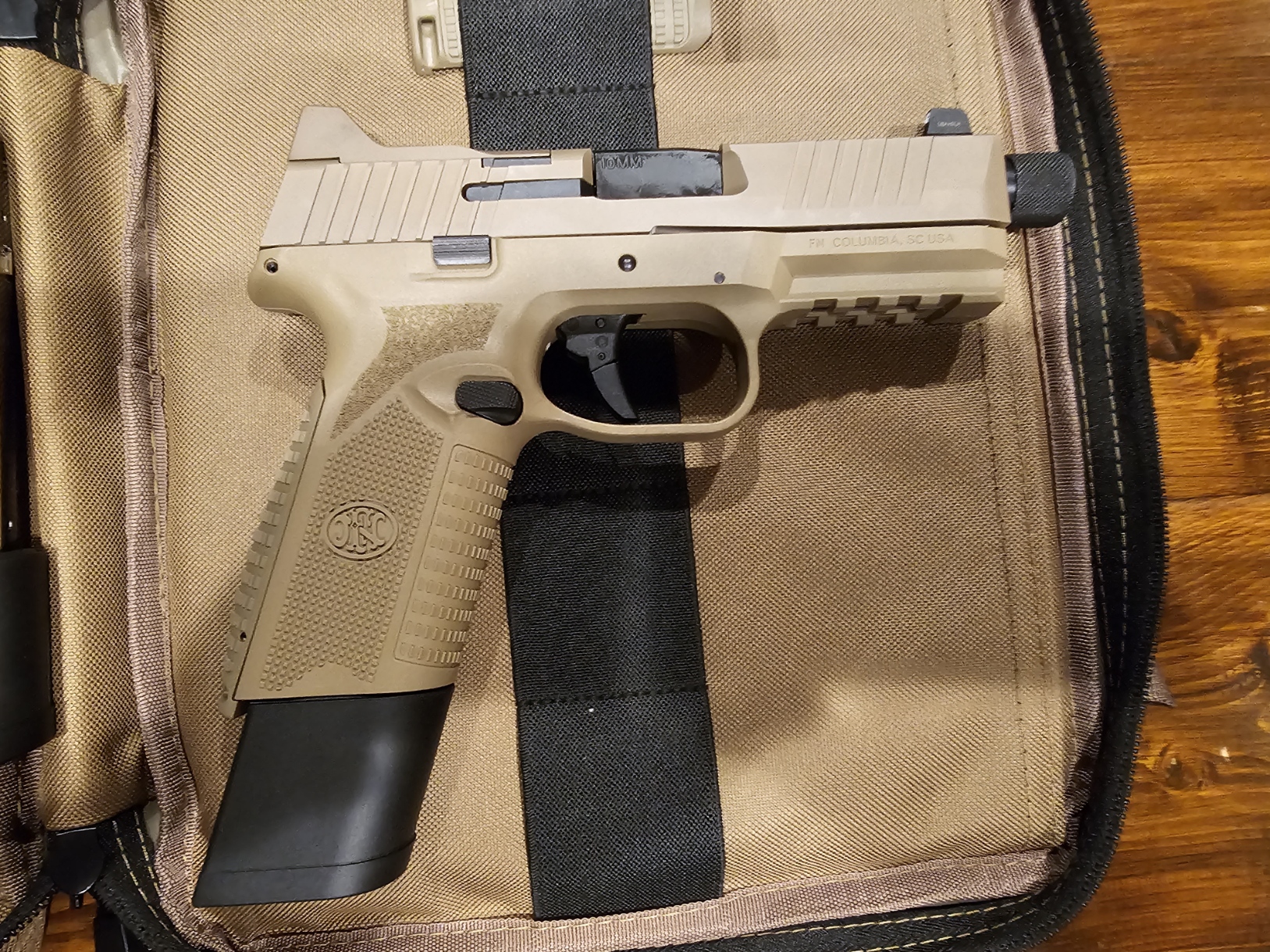

Now I don't have a problem with Black Controls or Sights, that fits perfectly... ....My problem is the black Magazine endplates, especially the extended magazines, the MRD Plates that adapt the RDS to the slide being black seem to just jump out at me as they should be matching the pistol color... ...and the worst, a tactically colored pistol, but the extended magazines have the back shiny polished nickel plate....

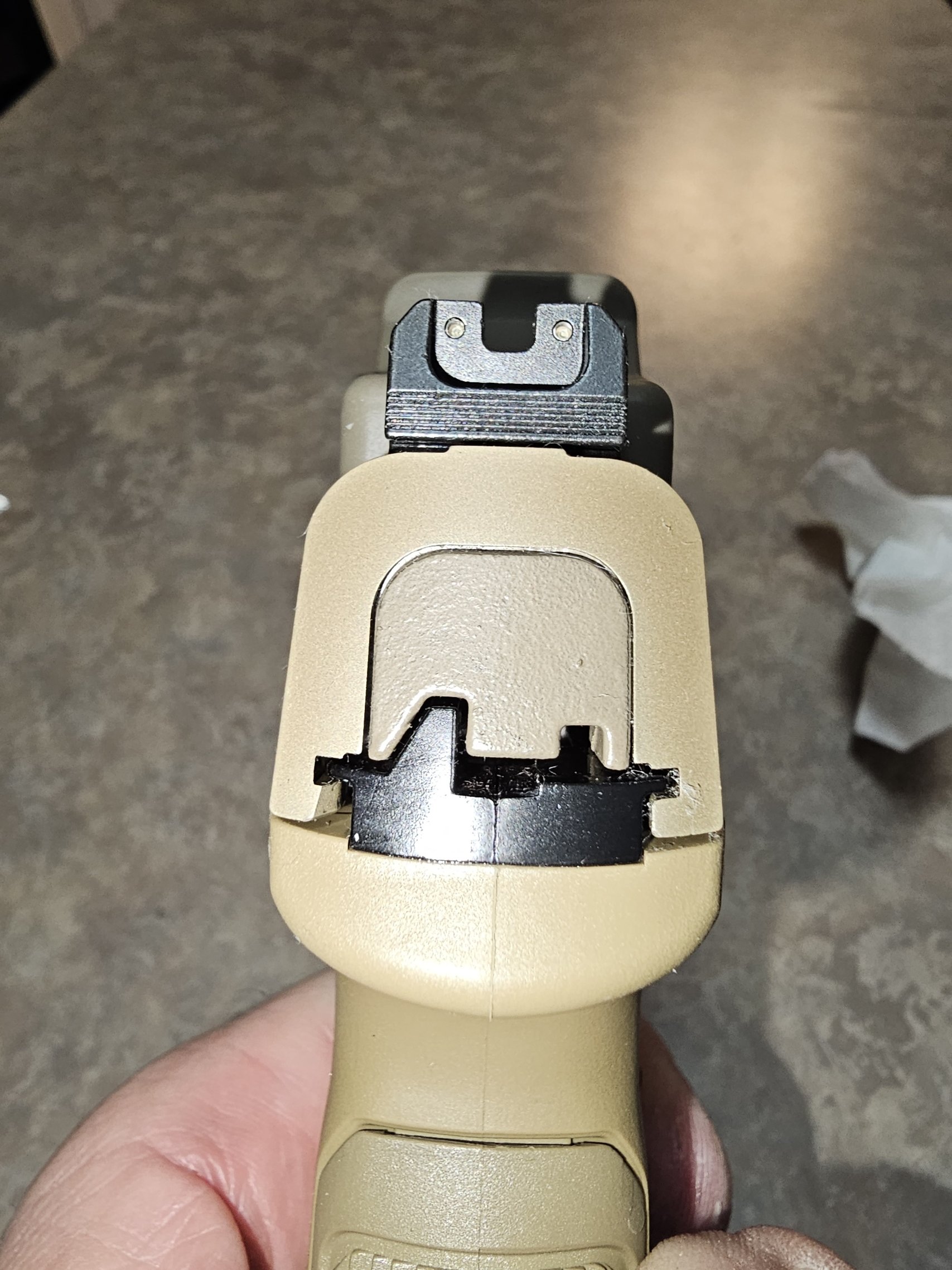

While I was at it I did the slide/striker end plate... ...matched better than I thought it would... ...granted most like the contrast of a black end plate, I prefer it to blend in with the slide more....
The MRD Plate that adapts the RDS, I think this looks much better....

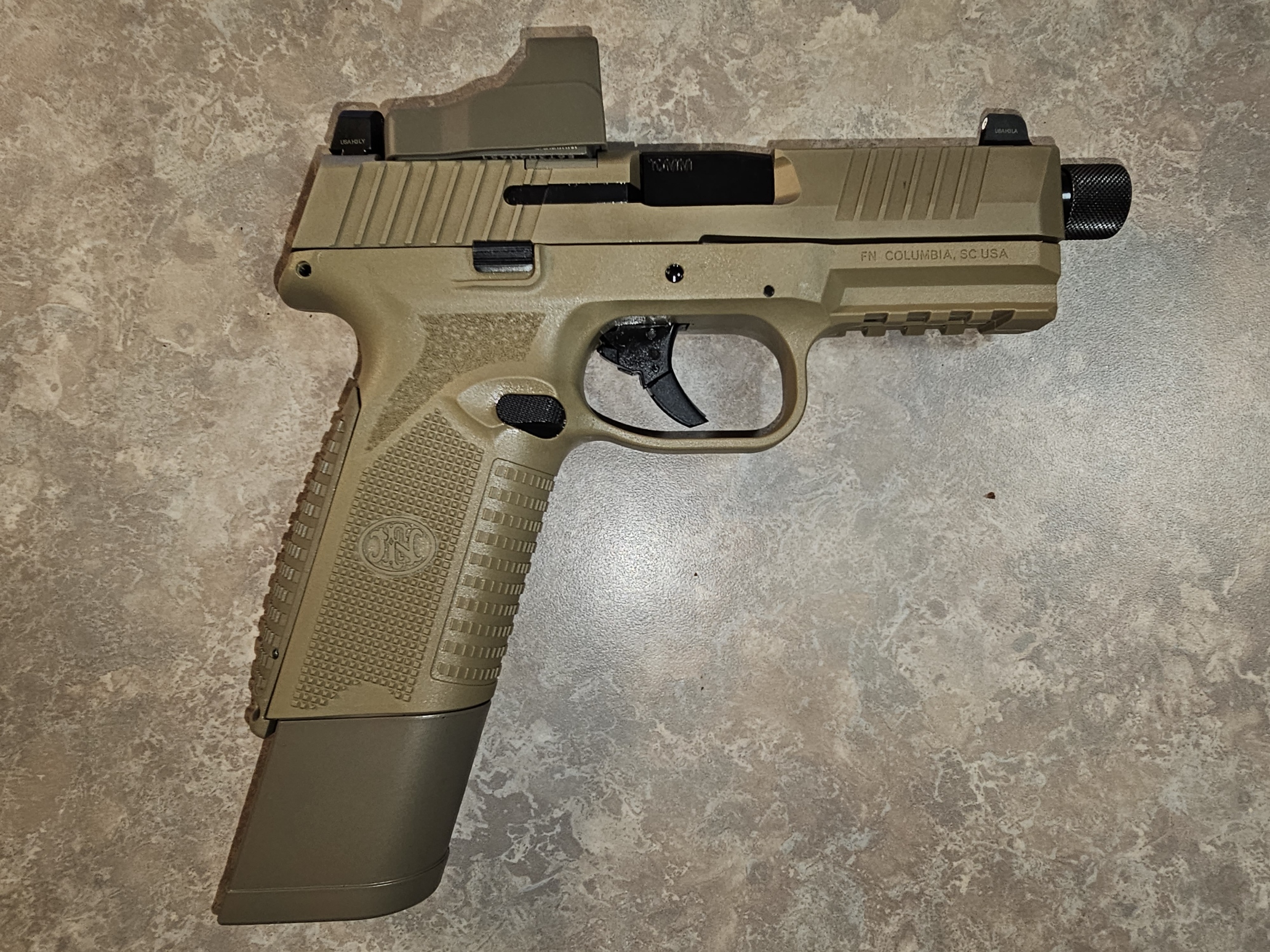

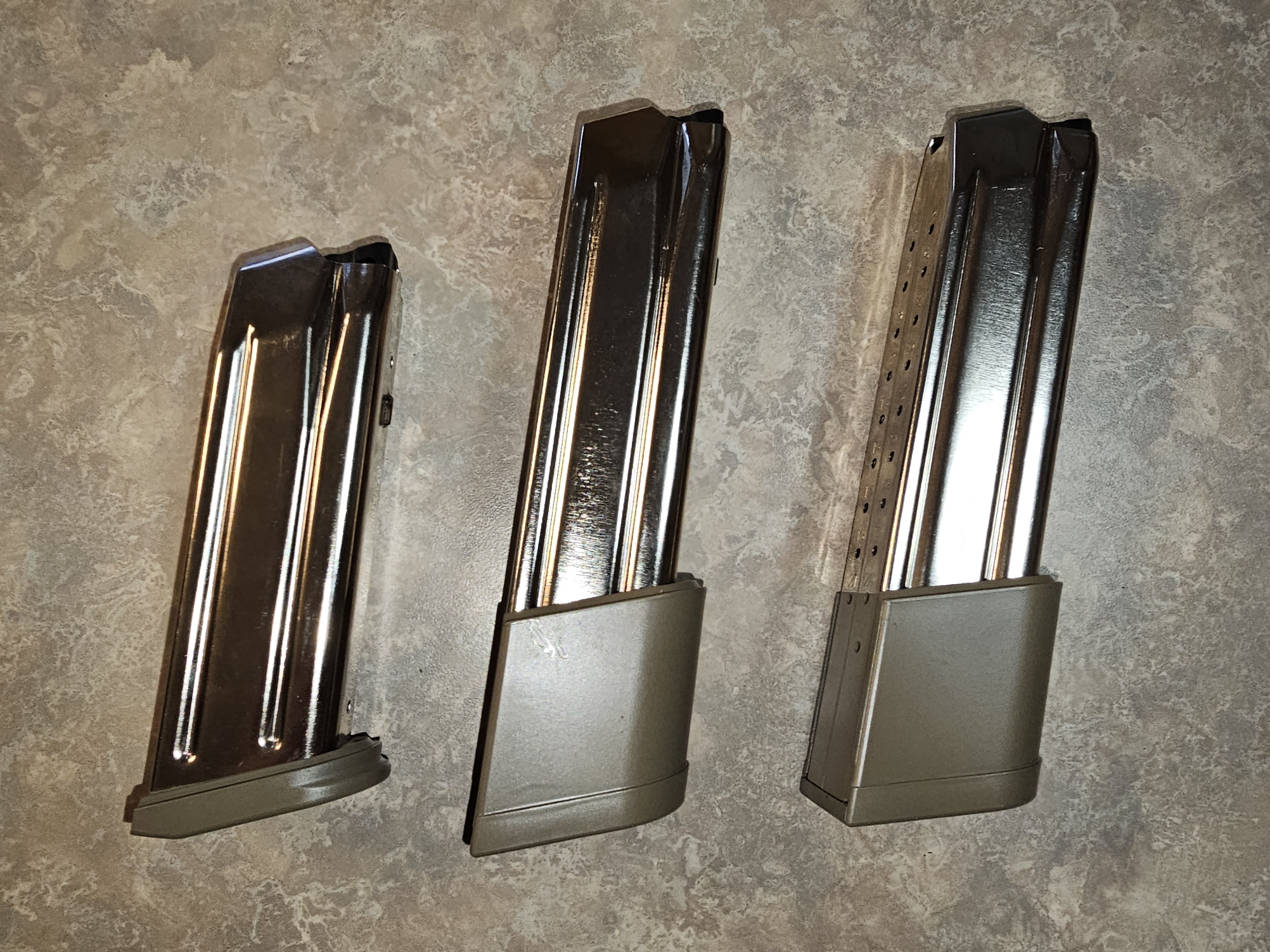

The Magazines....
The Flush fit 15 rnd, not a great match, but better than black...

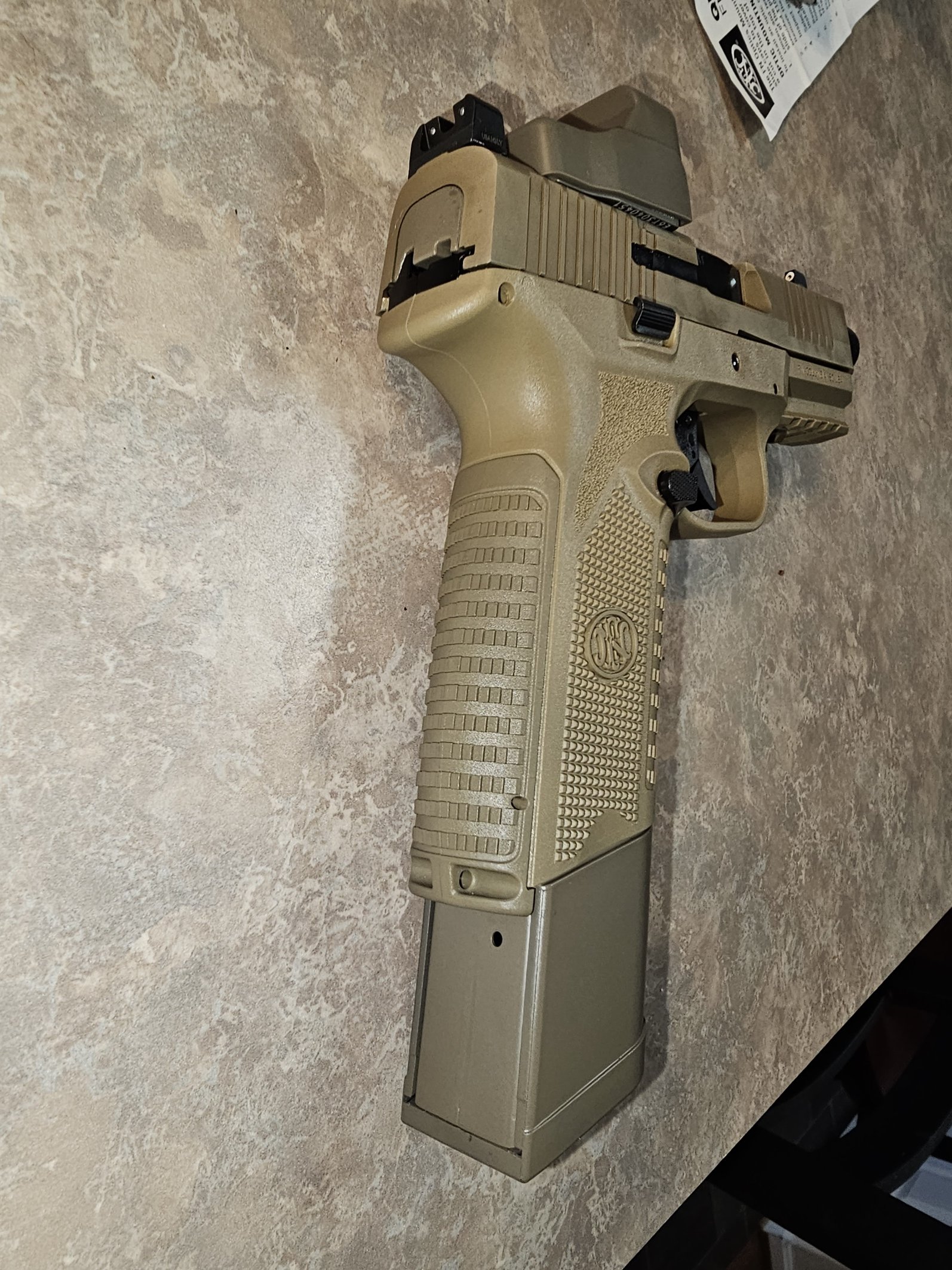

The extended 22 rnd Magazines... ....yea, not a good color match, yet still better than black IMO...
Of course, no shiny polished nickel plate exposed anymore....

That is one thing I have noticed about Cerakote, perhaps because the coating is so thin, the substrate you coat really makes a difference in the color shade. The floor plates did come out darker than I had hoped, and while I'm a little disappointed in the Magazine's color match to the rest of the pistol, I look on the bright side, its still better looking than the black floor plates and definitely better than the exposed shiny polished nickel plate on the back of the extended mags.
With lighter colors like FDE, It is recommended to do a “primer” base so all the parts end up the same shade. Or in the business we use different substrates to our advantage to do the 50 shades of FDE look.
I'm still an amateur with Cerakote, I was not aware that you can prime a surface then apply cerakote over it. Is there a Cerakote primer? Or do you use a color as primer and do 2 coats, I'm assuming flashing the first prime coat?
I used the Elite Series for this, which can't be flashed and stencil, because the best I can tell, Elite Series can't be applied over another coat. I suspect because of the self-lubricating properties that produce better abrasion resistance, would make it tough for more cerakote to adhere over a flashed cured layer.
