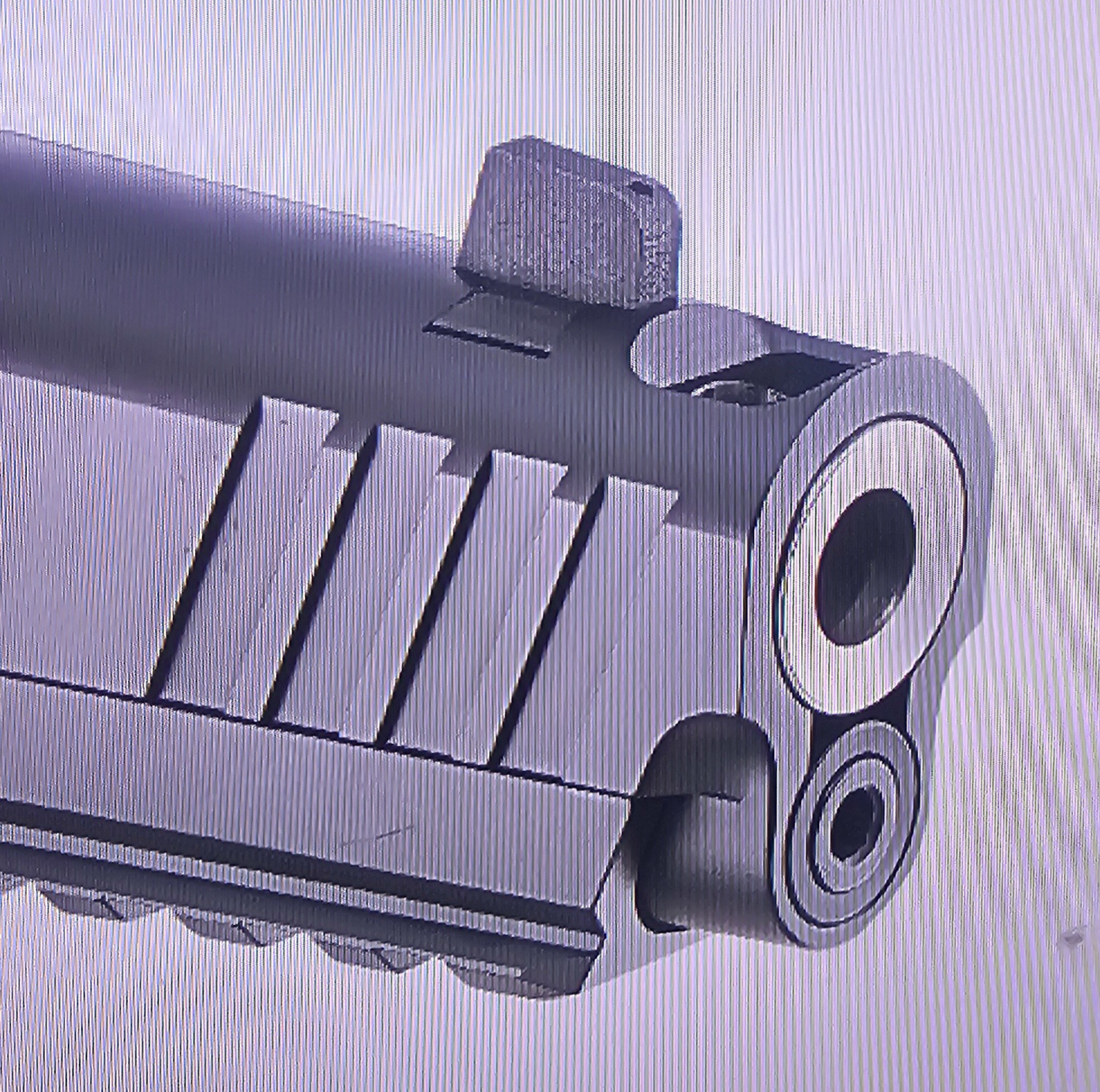

yes good point. But the 1911 DS comp, which I think is the one the OP referred too. Is more of a port (big hole cut in the barrel) and cut in the slide, like the hellcat pro comp. So not a comp that attaches to the end of the barrel.
would this alter your answer Hans?

I dislike that gun companies are deciding they can just use terms interchangeably…that’s a ported gun, not comped.
In which case…yes, it will likely reduce it to whatever the velocity would be out of a barrel the same length as where the PORTING begins.
If the barrel is ported (depending on where, how much and size of porting) it will/can lose velocity unlike comps! Regardless of comp design it's not any different the non-comp. Comped barrel isn't such a thing, only a misguided manufacturer and marketing. An apple is still an apple regardless of someone calling it an orange.

I looked up the website to see what this was .
It's Ported ( with a huge freaking port ) , not compensated.
With a port that big , the effective Bbl length ends at the start of the crater, not at the Crown .
So expect velocities equivalent to those from a bbl half inch shorter than advertised length .

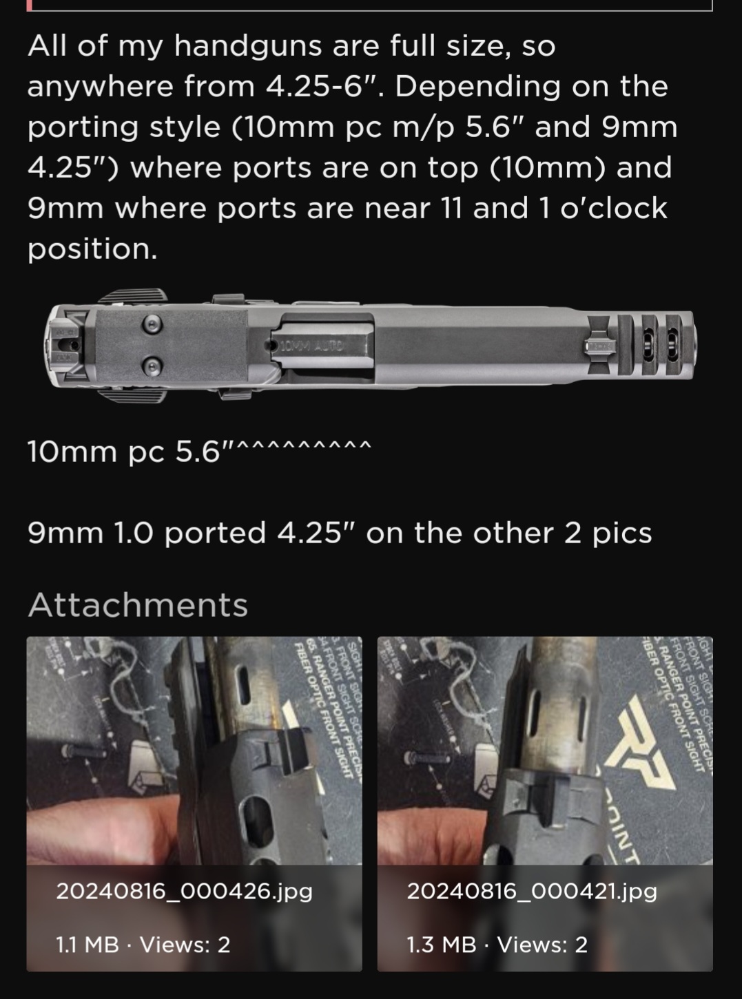

not totally, but will lessen the velocity a little due to not dumping all the gas like a end of a barrel would. i own plenty of ported barrels (most are longer than factory barrels and are longer than the slide) and a few are factory ported (s/w m/p). velocity difference in short barrels, especially in pistol cartridges will give between 5-10 fps less. on this particular gun the slide is where you see the large hole as the port in/on the barrel isn't as big

This was st posted in Cliff's thread, but was wrong thread.
