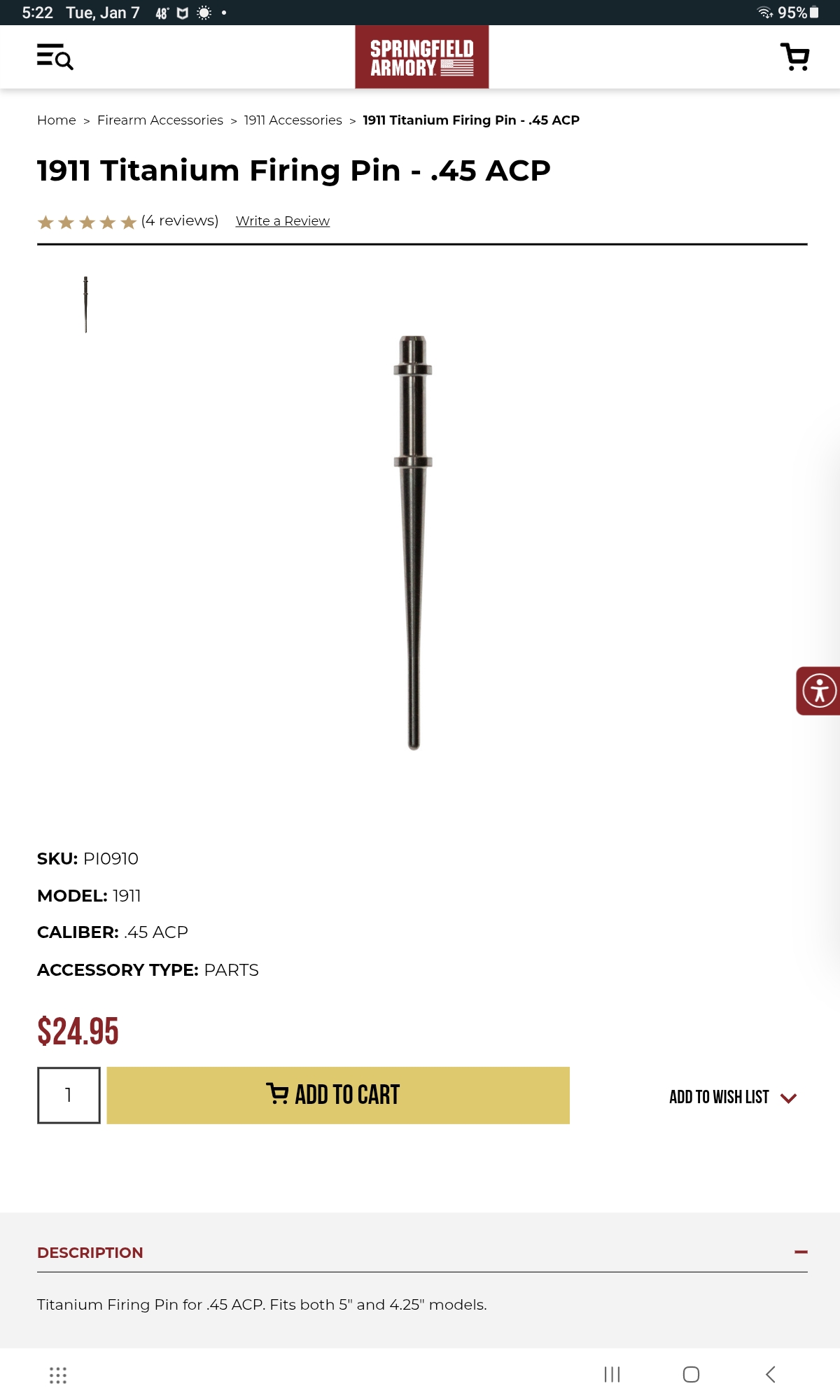

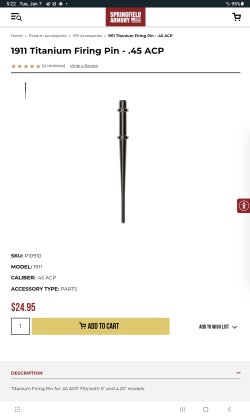

Go to SA site, then go to store. Select firearm accessories. Select 1911 accessories. On the second page of 1911 accessories you will find pin shown in attachment. Dont see stop plate tho. Hope this helps.
