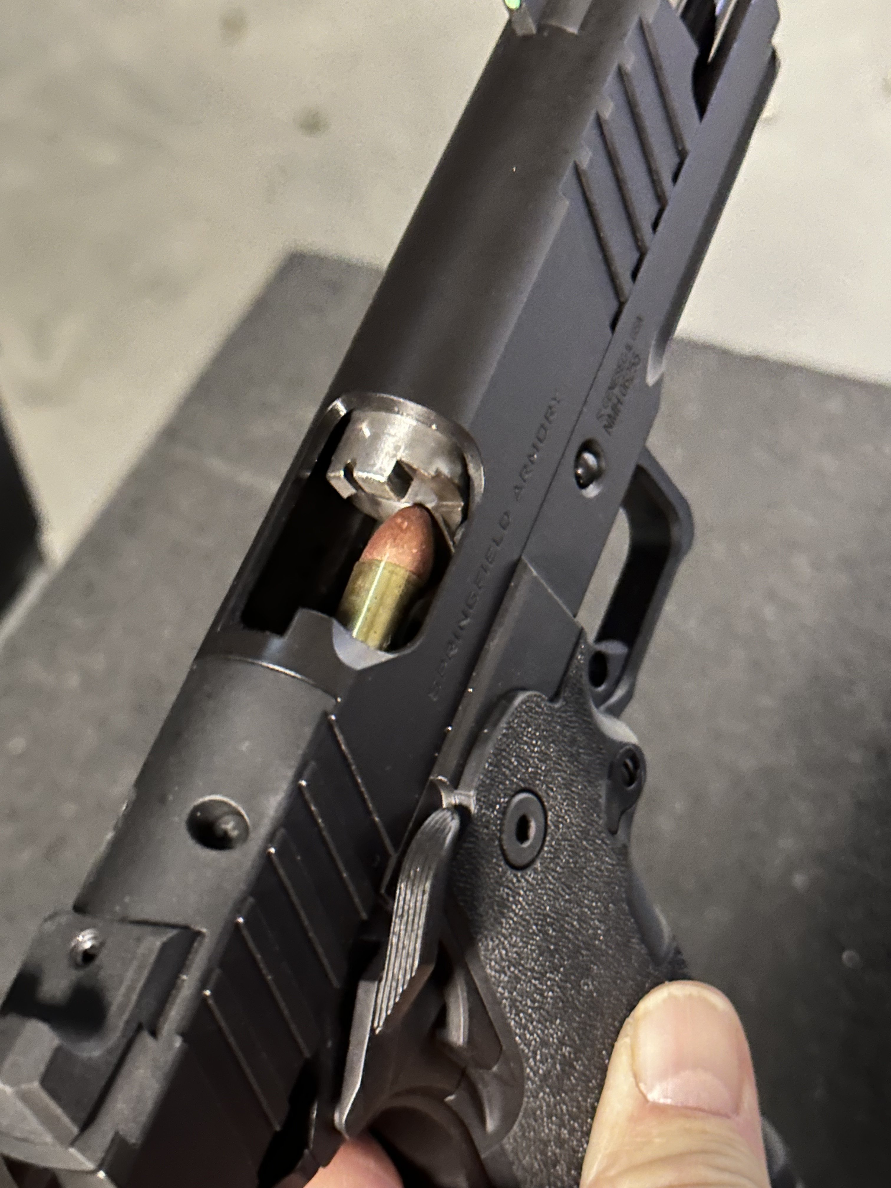

My local Scheels finally had one of these in. Picked it up this morning and took it to the range. I did not clean it prior to shooting it. I had a box of blazer 115. I shot 5 rounds no problem. Put another 5 in no problem. However it quickly deteriorated from here. I tried both magazines and started getting a failure to feed every 2-3 shots with one of the magazines the other one not as often but did hang up a couple times.

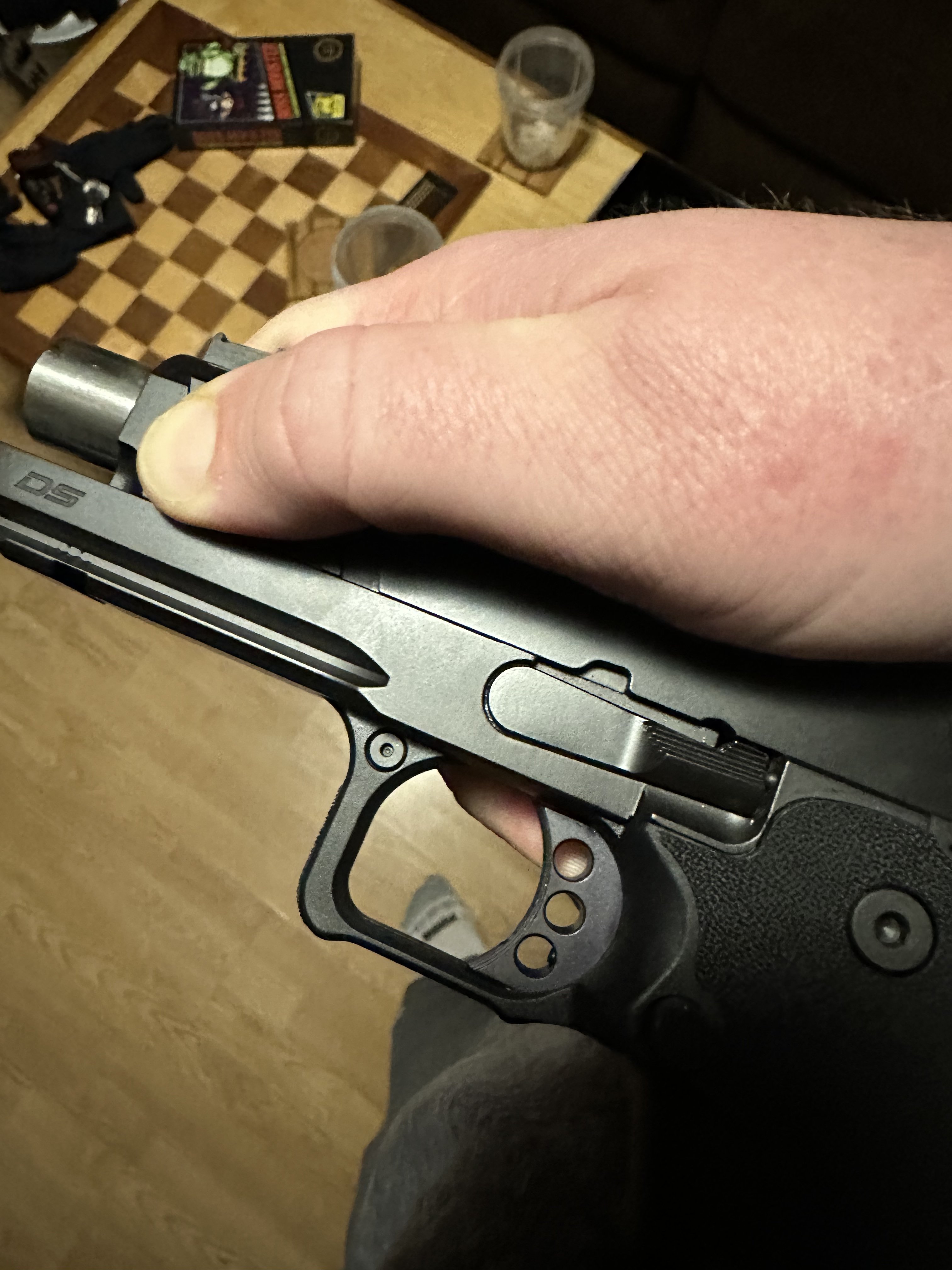

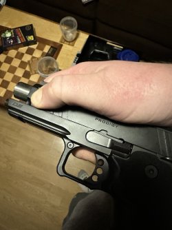

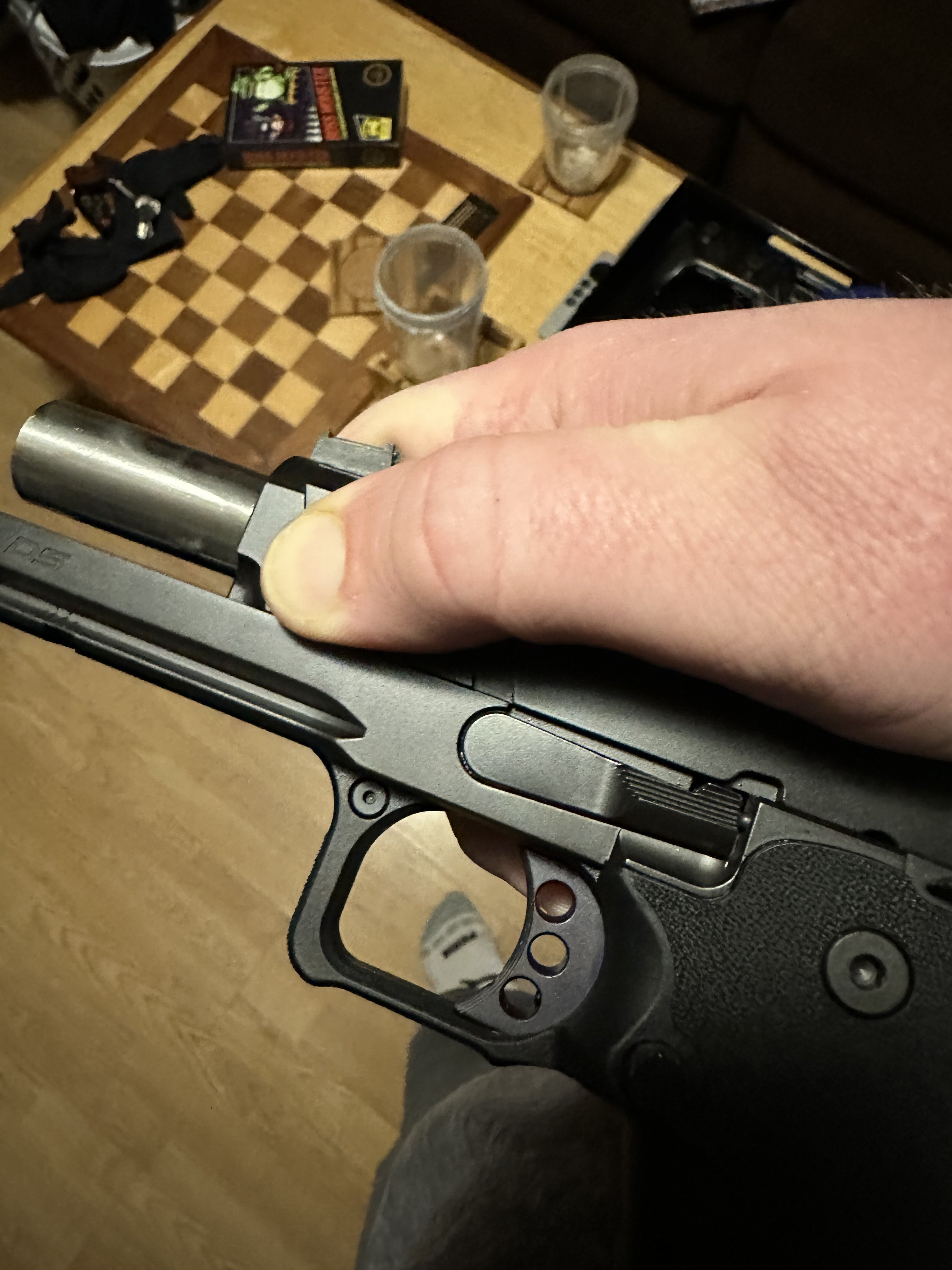

So I went and Racked it a few times. When I pull it back first picture below it has a bit of a hesitation at this spot. It’s not really noticable on a fast rack but I can feel it a little and on the release it seems find. Other than that it feels quite smooth (and I’m prefacing my next sentence by saying I know not to ride the slide back but I am not sure if the hesitation I can feel is normal and want to be as detailed as possible) So I did a slow pull back and rode the slide back to see if it hung up at all. if I pull it back slowly I can feel it sort of catch here in the first picture. When I ride the slide back closed I can feel slight hesitation in the next two positions Which are the 2nd and 3rd pictures. If this normal please just correct me. But I have nothing to compare against.

I have a 5in Prodigy with 1500 rounds through it and other than a very small amount of failure to feeds on the first range trip it has been faultless. It sounds like the area of resistance is the disconnector, which is not uncommon with the Prodigy. If the slide is not hanging up on the disconnector and refusing to go into battery don’t worry about it. I have bought multiple Springfield mags and none of them have caused problems. Honestly, I don’t understand the logic of dropping a big chunk of change on a Prodigy and not cleaning and lubing it properly first, but that ship has sailed. I often use MPro7 as a cleaner but I am not that keen on it as a lubricant. Get yourself some gun oil - Hoppes, whatever floats your boat, or clean and lubricate with Ballistol. It is very good at both. As you are a relative newcomer to guns and 1911s in particular I would send your Prodigy in to Springfield and have them wave their magic wand over it. Good luck, it’s an awesome gun when it runs right. Mine is magical.

Feeling the disconnector is like dual recoil springs. There gets to be a segment of resistance that seems like failure/grind/rough area. As you mentioned it doesn't have the feel when racking fast. Unfortunately when live firing it tells you more.

Casing ejects and then slide doesn’t come back into ready position (sorry I don’t know the technical term) and the next round is not chambering as you can see in the first picture I posted in my first post. The position of the slide in that picture was exactly how it stopped after a shot.
Ok so it is ejecting the spent round but failing to feed the next round. Next question, in the referenced photo I can't see. Is the bolt face in contact with the base of the cartridge, or stuck on the side of the cartridge case? Is the nose of the bullet jammed into the bottom of the barrel (feed ramp)?
It’s jammed into the feed ramp. My gunsmith when he took it apart commented that the feed ramp looked great no rough spots. The bullet clears just fine with a quick rack and next bullet goes into place just fine.
