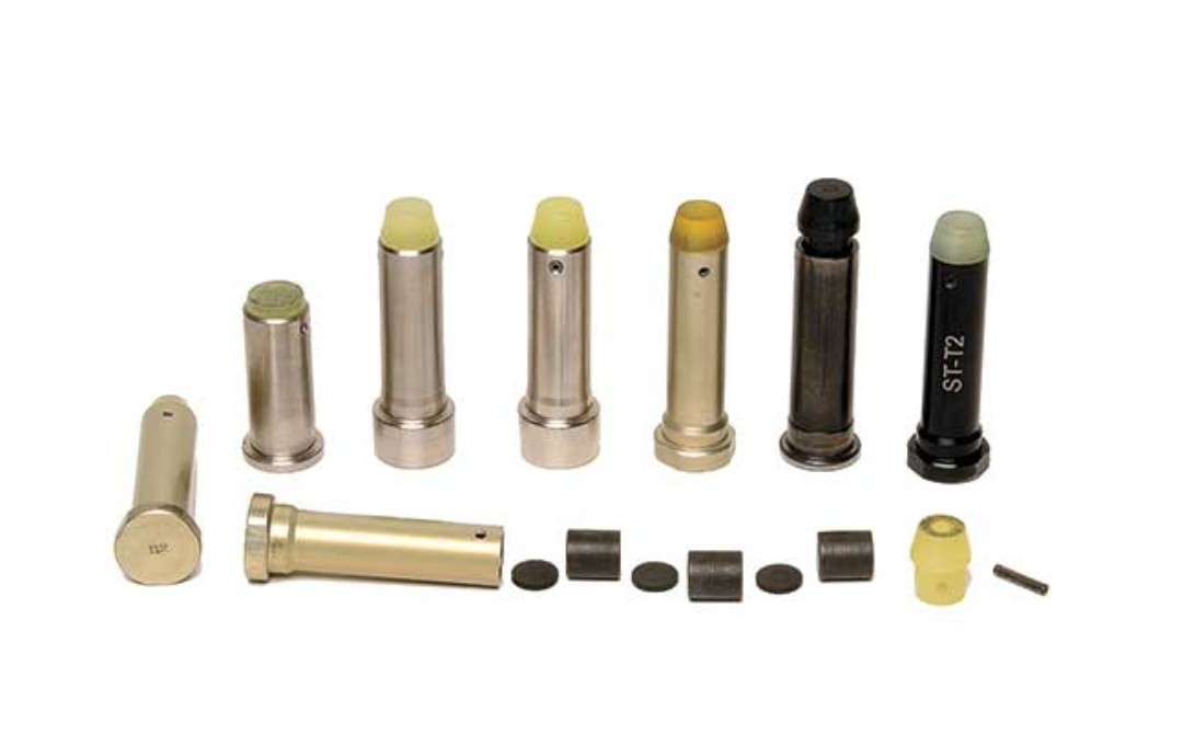

There are individual weights in some buffer weights. You can shake just the weight back and forth to hear them.
Anatomy of a buffer weight.

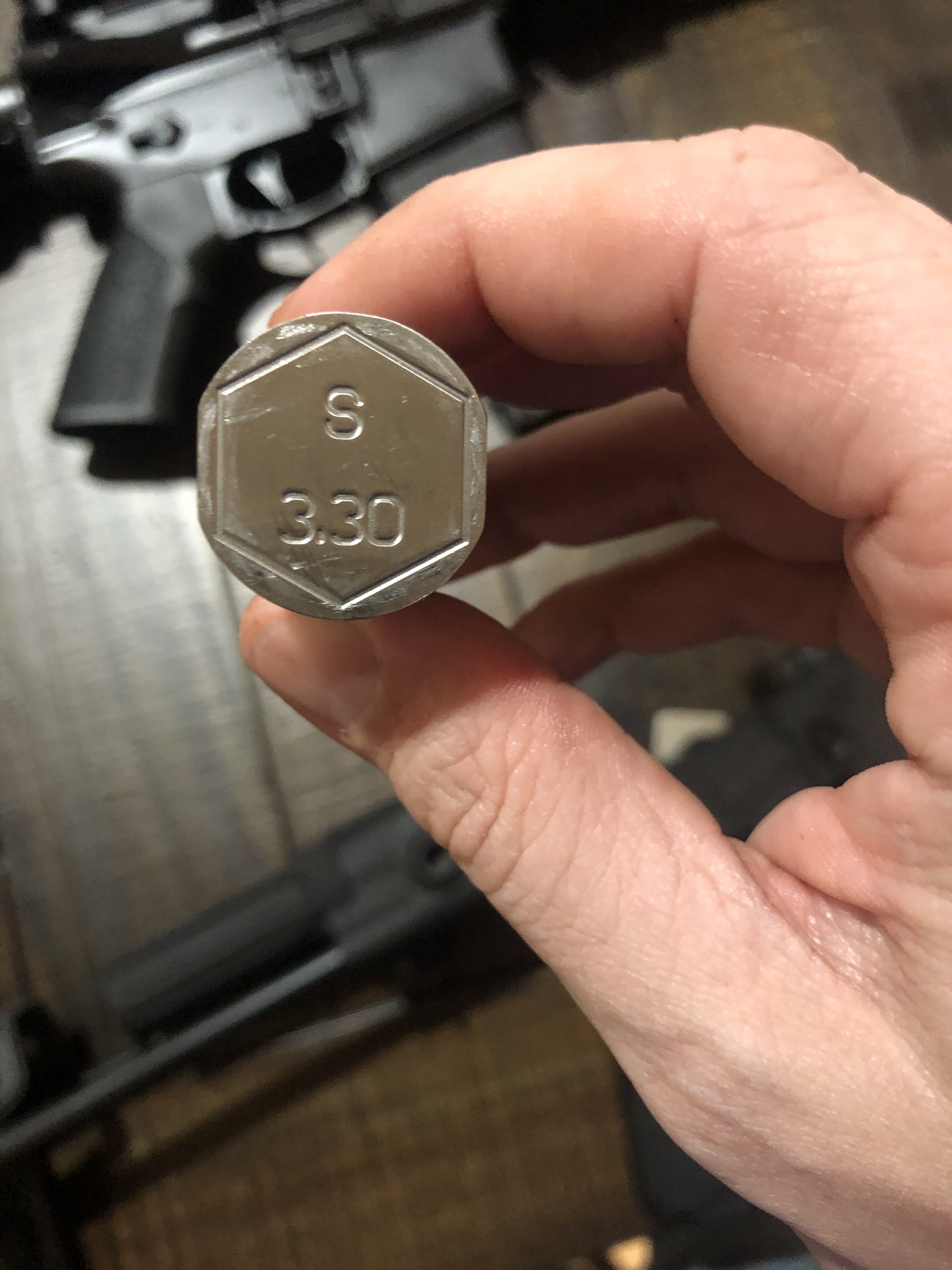

What does this stamp mean?
Not positive, but my guess would be that it is the weight in ounces. Not sure what the S would stand for (maybe Saint?), but maybe the 3.30 is ounces. A carbine length rifle would have a standard weight of 3 ounces. The H for heavy would be 3.8 ounces. Weights go up from there with H2 & H3. My guess is that SA designed the weight to work best with their barrel and gas tube length. Maybe someone who actually knows can respond instead of me taking guesses. :)
