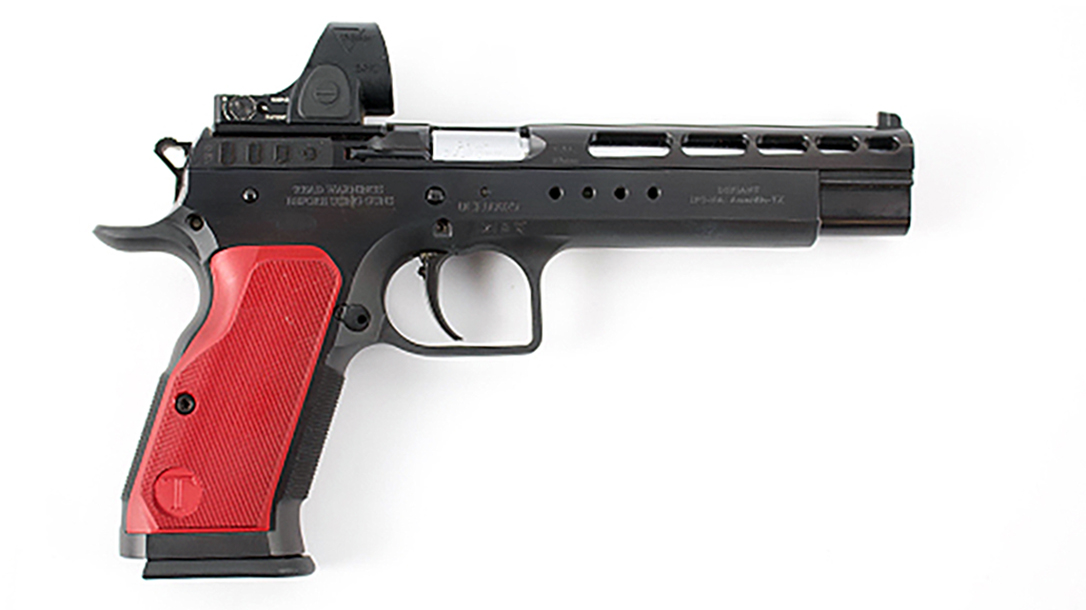

Tanfoglio Defiant Gold Match OR

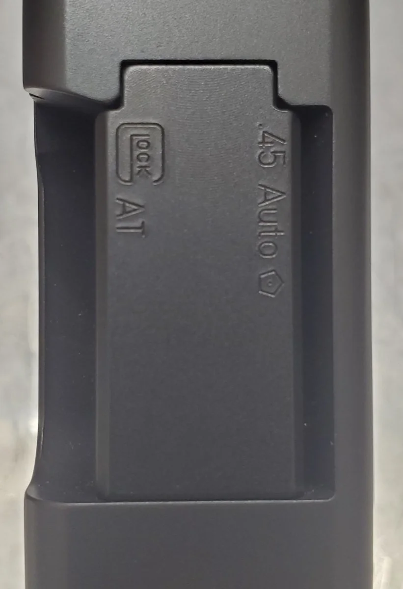

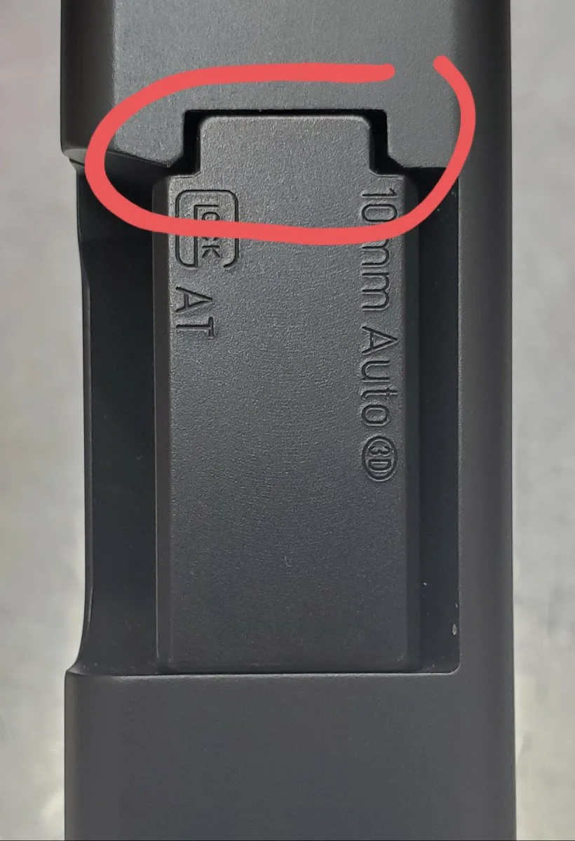

Also, conversion barrels between the G21 and G20 have differences in the chamber hood width. The 10mm barrel hoods are about 0.427" wide at the back. The .45 ACP is about 0.480", so a 10mm conversion barrel has the same width as the .45, and visa versa if going from 10mm to .45.
A G20 factory barrel in a G21 slide looks like this.
A G21 10mm conversion barrel looks the same as this .45 acp factory barrel in a G21.
