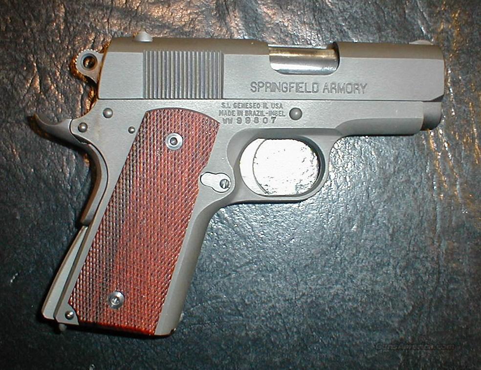

I have a used 45acp 1911 micro compact ( serial #998xx
) that shoots very low and left. The front sight needs to be half way above the rear sight plane. Not sure if I should be concerned. I have adjusted windage but am considering a taller rear sight. What is the cut if the dovetail called? Could this be due to wear in the barrel/slide? Should I take this to an armorer? Thoughts or concerns? Are there replacement barrels/slides available?

Ammo doesn't seem to make any difference. If you look closely at the pic you can see the barrel to slide geometry orients the barrel pointing low. It seems to be seating in the slide deeply at the rear. Thanks for the reply. As a shooter I really appreciate the steel frame and the stability it gives taming recoil. It is not my target pistol but kind of annoying the sights are so far off.

Not offended at all, I've eliminated jerk and trigger input, bench resting and slow squeezing and letting the shot be a surprise. I've put hundreds of rounds through it. I've adjusted the windage and can be on target with the front sight poking up halfway over the rear sight box. A taller rear iron sight would fix this.

So those are Colt GI sights, the front is a tennon staked in front, not dovetail. The rear is a dove tail. Now the front is already short you probably can‘t go any lower, but the rear can definitely go higher.
That's a start for the info I will need. Where is a good place to look for rear "Colt GI" sights in a taller profile?
