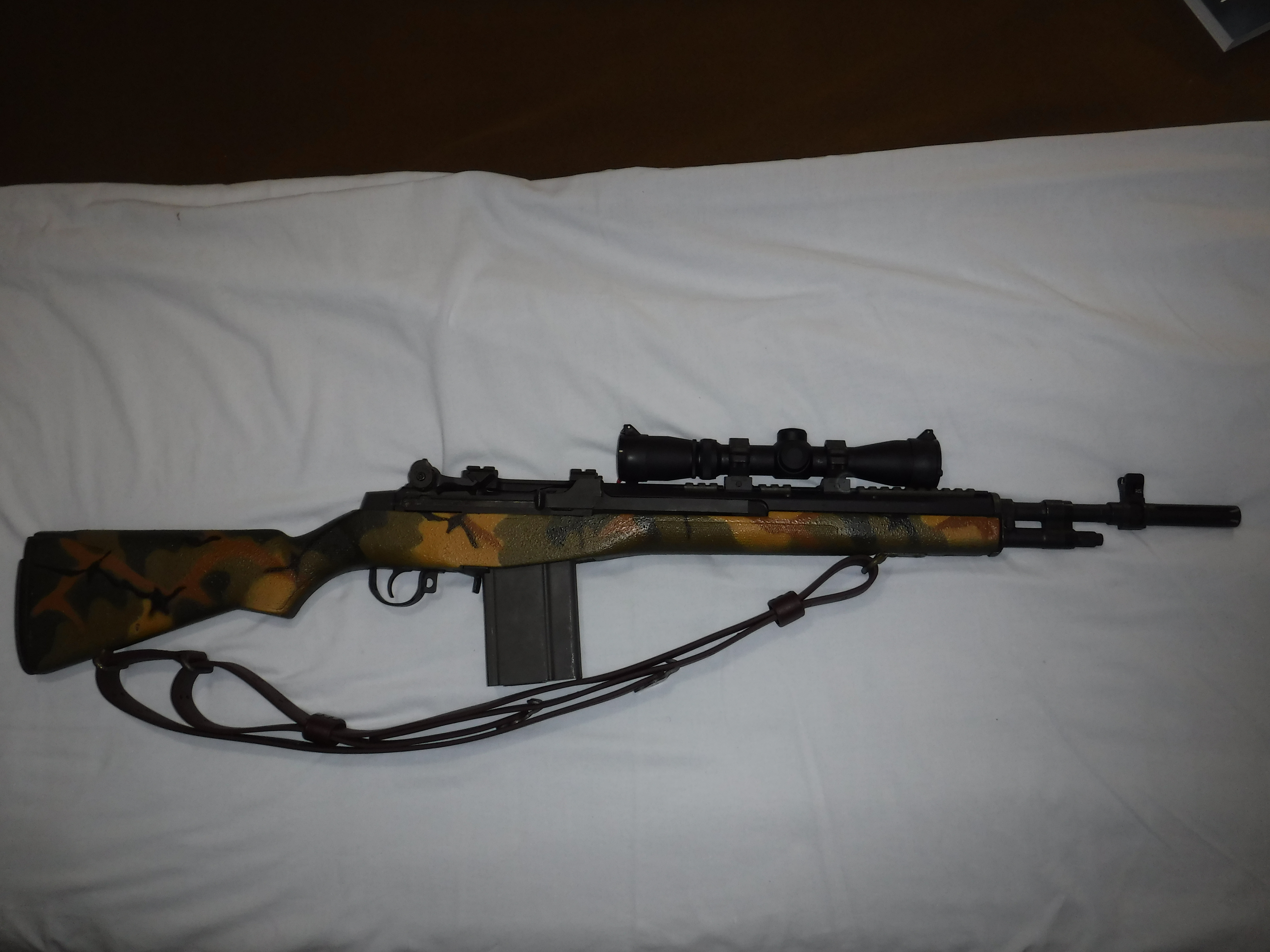

I have my Scout rigged out for a variety optic options based on my AOP and possible other conditions.
As per the pic I can scout mount a LER/handgun scope (Burris 2-7 handgun shown) or a MRD, all on QR mounts. I also have a Gen1 ARMS scope base for a conventional scope.
I would mount a MRD for ranges out to 100 yds, then go with my 2-7 for ranges beyond 100 to the point where a conventional higher-powered scope would be better for longer ranges.

I've never shot with a scope mounted forward like that. What's it like? How do you get full view? Are there advantages to that type of mount? Sorry....just lack experience with that setup and looking to get a little smarter about it
That's the "scout scope" approach. Using a scope made for handguns or others with extended eye relief you have a full view picture like a conventional scope that has much shorter eye relief. That advantages is that the action area is clear of the extra bulk of a scope so if you're reloading you have more access. A disadvantage is that you have to have a scope with the extended eye relief and it adds more weight up front.
When mounting a MRD or larger Aimpoint 30mm there's less weight and it works just like having a red dot mount that's typical now-a-days on ARs.
I believe on using quick release rings for either optic type, and the M1A scout mount is an Ultimak. It's all metal and attaches to the barrel. But it does add some weight up front. http://www.ultimak.com/m8.htm
