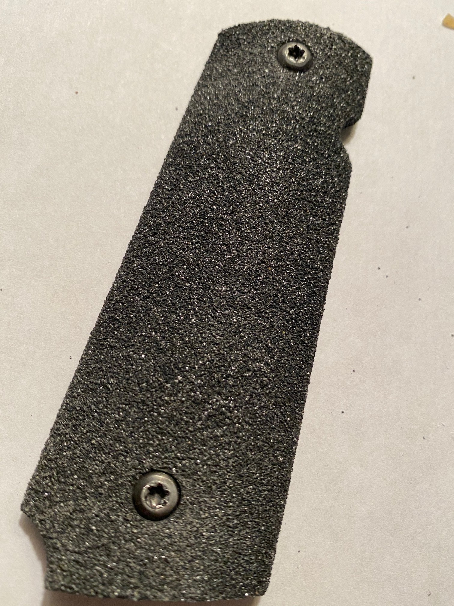

I recently purchased the Crimson Trace LG-401 grips to replace the stock grips on the TRP Operator 1911.
Upon dismantling the stock Grip-tape grips from the TRP operator, I noticed that the screws (for the stock griptape grips) are embedded within the stock 1911 grips themselves. This means that the screws that come with the stock 1911 Grips cannot be re-used for the Crimson Trace Grips.
I was wondering if anyone happens to know of the proper bushings and grip screws that I may need to purchase in order to mount the Crimson Trace grips onto the SA TRP Operator ?

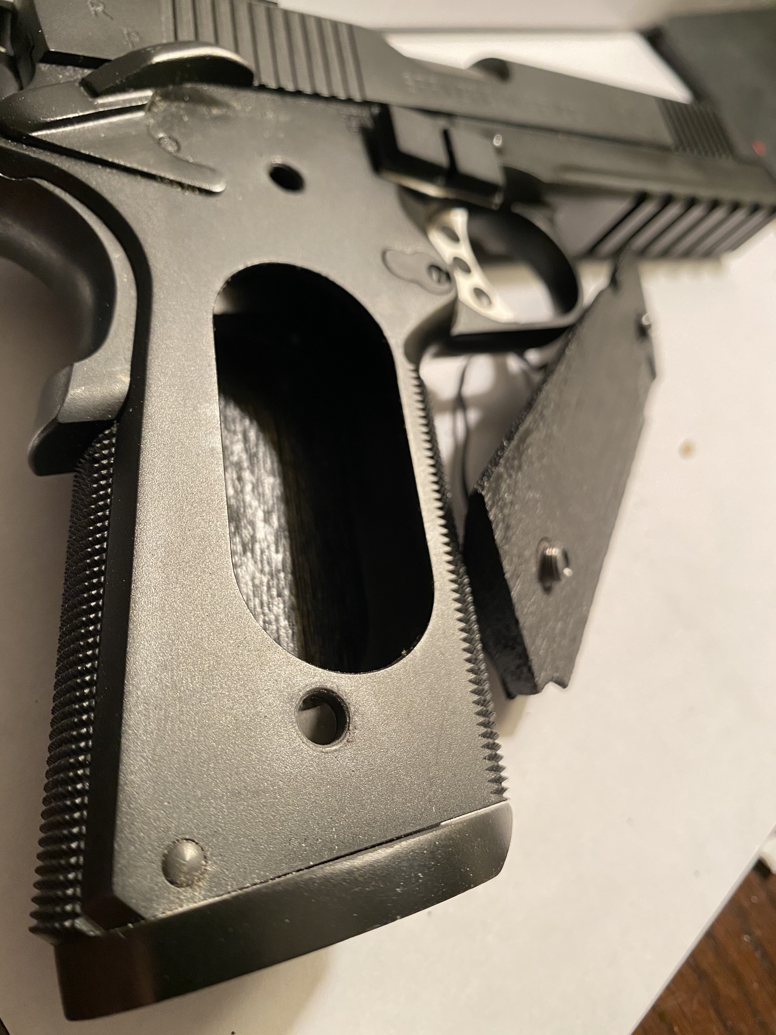

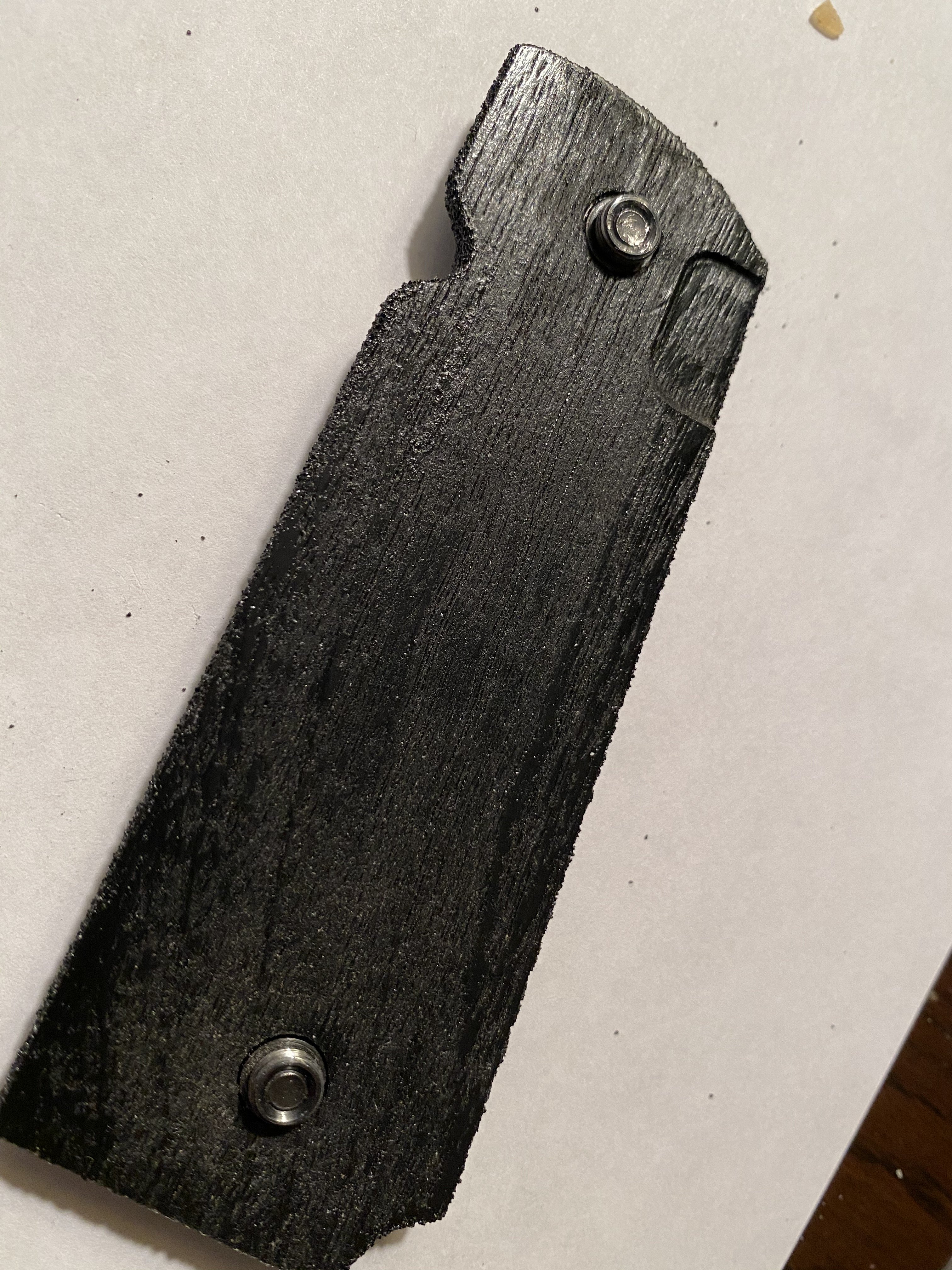

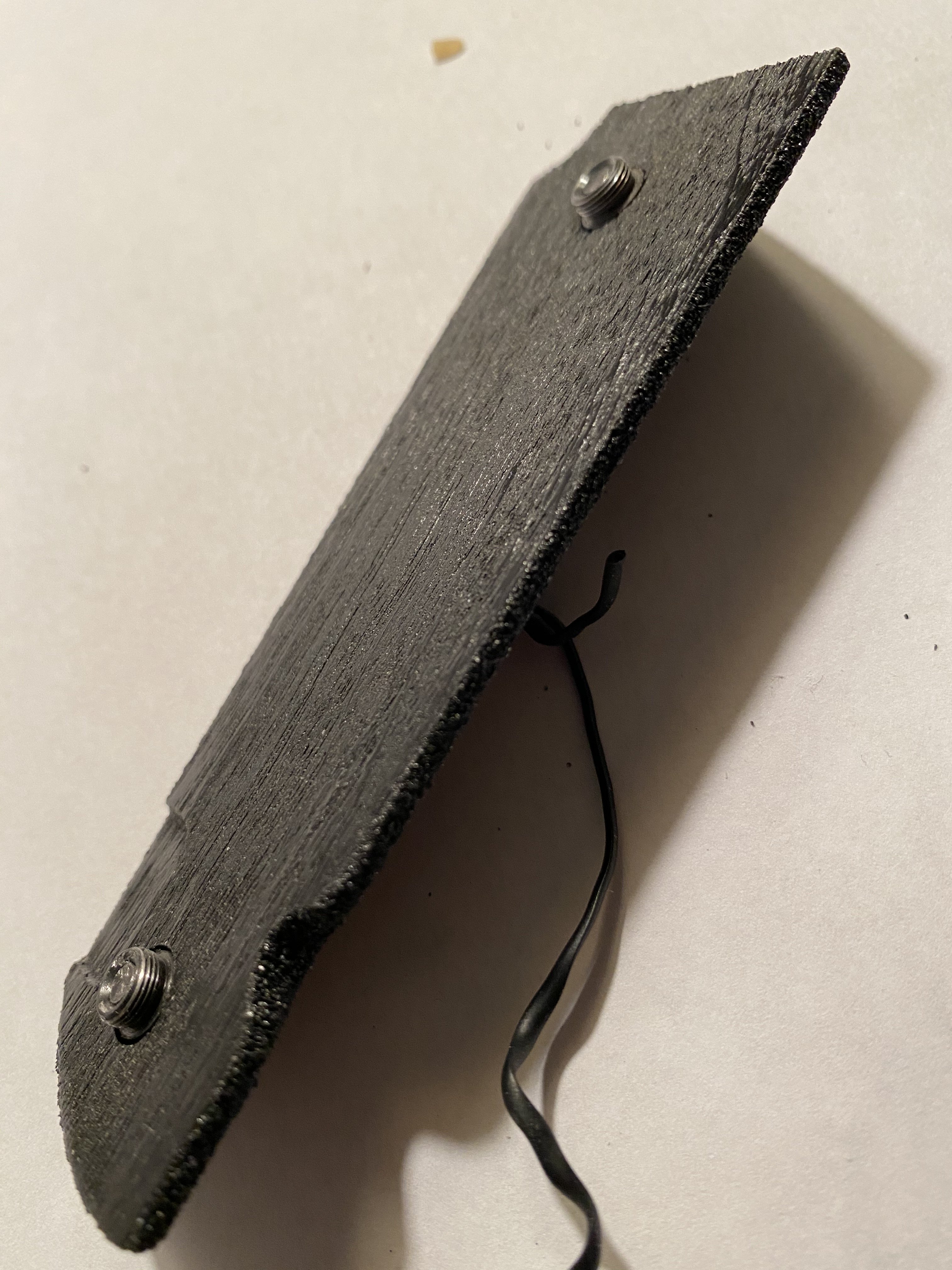

Ive attached some pics of my TRP Operator 1911 pistol and the stock grips.
In the pics, you will see that I have removed 1 side of the grip.
Underneath the grip are some screws that are like the size of bushings, but they have thick screw heads that screw into the pistol, attaching the grip to the pistol.
The things is that these screws in the grip cannot be removed from the grip, as they are embedded within the layers of the grip. Trying to remove the screws from the grip results in damaging the hole of the grip.. and, when you get the screw piece out of the grip and look at it, it is like a small bushing with the screw piece and they they are glued together with locktite or something, to make a fatter screw that is already glued to bushing, which is screwed to the pistol handle.
... maybe this grip-tape grip is different than others.I dont know... After months, i do like how it feels though.
When the grips are removed from the pistol, you will see that the bushings do not exist on the handle of the pistol beneath, like a normal grip might, and I am wondering if this is something different between some other gun manuafactures? Ive only owned 1 other pistol than this 1911, so im a bit newb-zilla... this is the first time i have ever tried to change the grip on the pistol.
anyways.. the pics show that the bushings are not attached to the pistol, but instead, they are screws embedded into the stock grip tape grips.
I hoping someone knows which bushing/screw combo i might need to purchase to attach the CT LG-401 to the SA TRP Operator 1911.

First off, welcome to the forum.
Second...I don’t think those grips you pictured are stock/original; never seen a TRP come from the factory with them...did you perhaps buy your TRP used?
Third—the bushings should have stayed in the grip frame when you removed the grips, unless somebody used Loctite on the grip screws because they loosened...which is the wrong thing to do; get a small rubber o-ring (forget the exact size) and your grips will never loosen.

YES.. I did indeed buy the TRP 2nd hand from a local dealer, however, I was under the impression that the grips were stock, and the firearm was unchanged....But, it could be that grips themselves were not stock... thanks for the clarity.. i was unaware.....

Agreed Hans. Both my TRP's came with VZ G10 grips. I didn't like the "Alien" VZ grips on my 6" 10mm TRP, so I bought the same VZ grips that were on my TRP 45. Removed the screws, Bushing stayed in the frame, and used the same screws to replace the 10mm TRP grips with the new grips.
