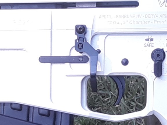

The RIA VR 80 shotguns have threaded pins but they are slotted and really easy to bugger up if you ain't careful. RIA makes a EBR for those.
