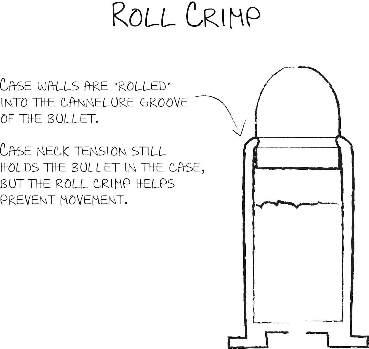

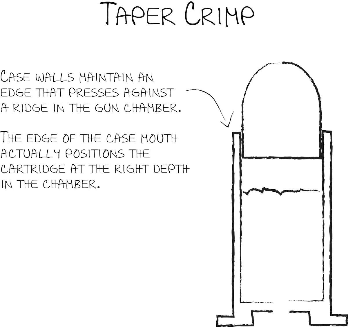

It really shouldn’t, factory ammo has a real good and tight taper crimp on semi auto ammo, if you reload any semi auto ammo, you need a tight taper crimp on the rounds. You should always use a taper crimp die on any semi auto reload you make, roll crimp will not crimp right or at all on a semi auto round, that crimp is for revolver rounds.

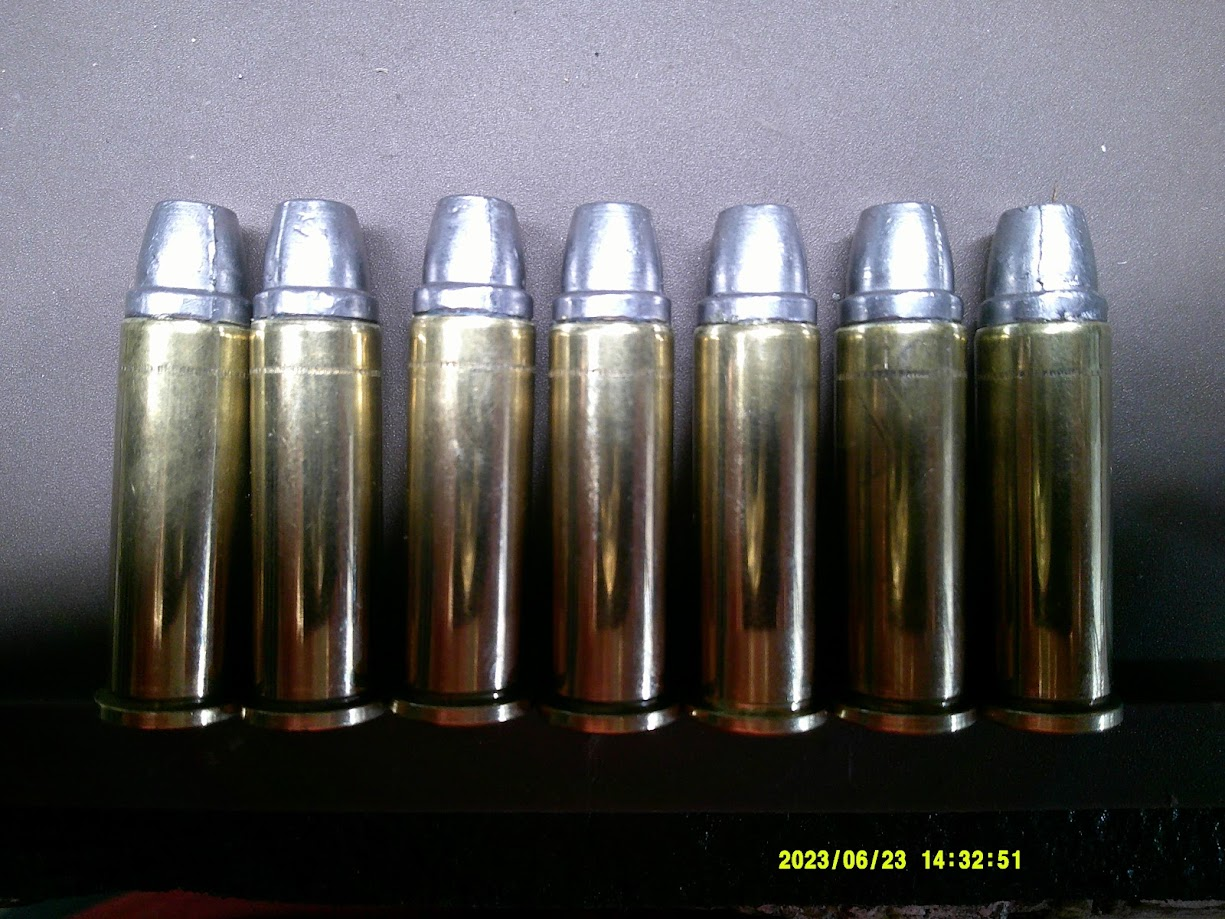

right...this is a pic of my first revolver reloading, and adjusting the roll crimp die. each round shot beautifully too.
thing is, i need to get up my stock of .38 specials and 45 Colt LC when i can.
way behind in stocking up on those.

Good looking reloads. I really like the Keith style semi-wadcutter bullets.
thanks, that was my first work up to get the Dillon dialed in, with the Lee dies. only did if i recall about 20 in total, took'em the the club, and had a blast..............when i can, i have to order up the boxes from midway usa......to make up at least 200 more........ya see....it's not saving money...reloading..!!!!!!
to be honest, all i did was tell the mom/pop store guy, i wanted semi-wadcutters.
i don't or didn't know they had a name.
