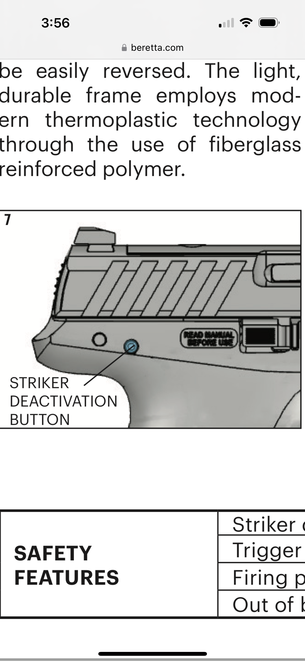

On, my new Beretta Apex has what’s called a striker deactivation switch on the side of frame, according to the manual, you use this to release the striker before disassembly instead of pulling the trigger, ok, this is where I quite don’t understand, the manual says you can dry fire this gun in moderation but not extensive, isn’t using the switch to release the striker the same as dry firing, or am I just not completely understanding how this works. This is the first pistol I have come across in 40+ years of firearms that has it.

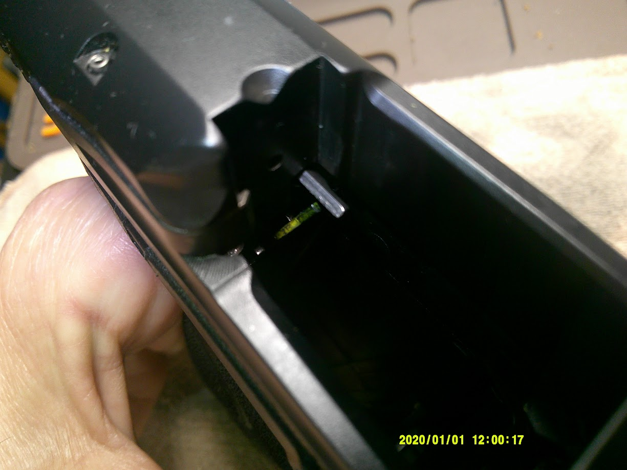

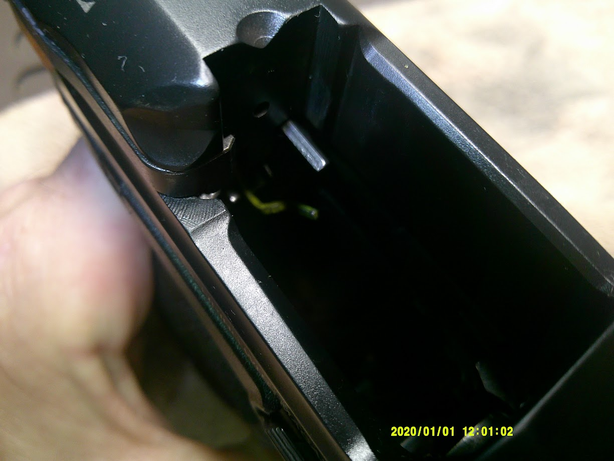

be darned if i know....i only have the 92 FS's......and i cannot "see" any switch on any pictures on Beretta..
however, can that "switch" be like say what a S&W has, which is like a tiny lever, inside the magwell?
if i lower that tiny lever, i can then remove the slide, with out pulling the trigger....
here, the lever is green, and in the up position, and i can not dry fire
and here, the lever is down, allowing me to remove the slide without pulling the trigger, and dry firing as well

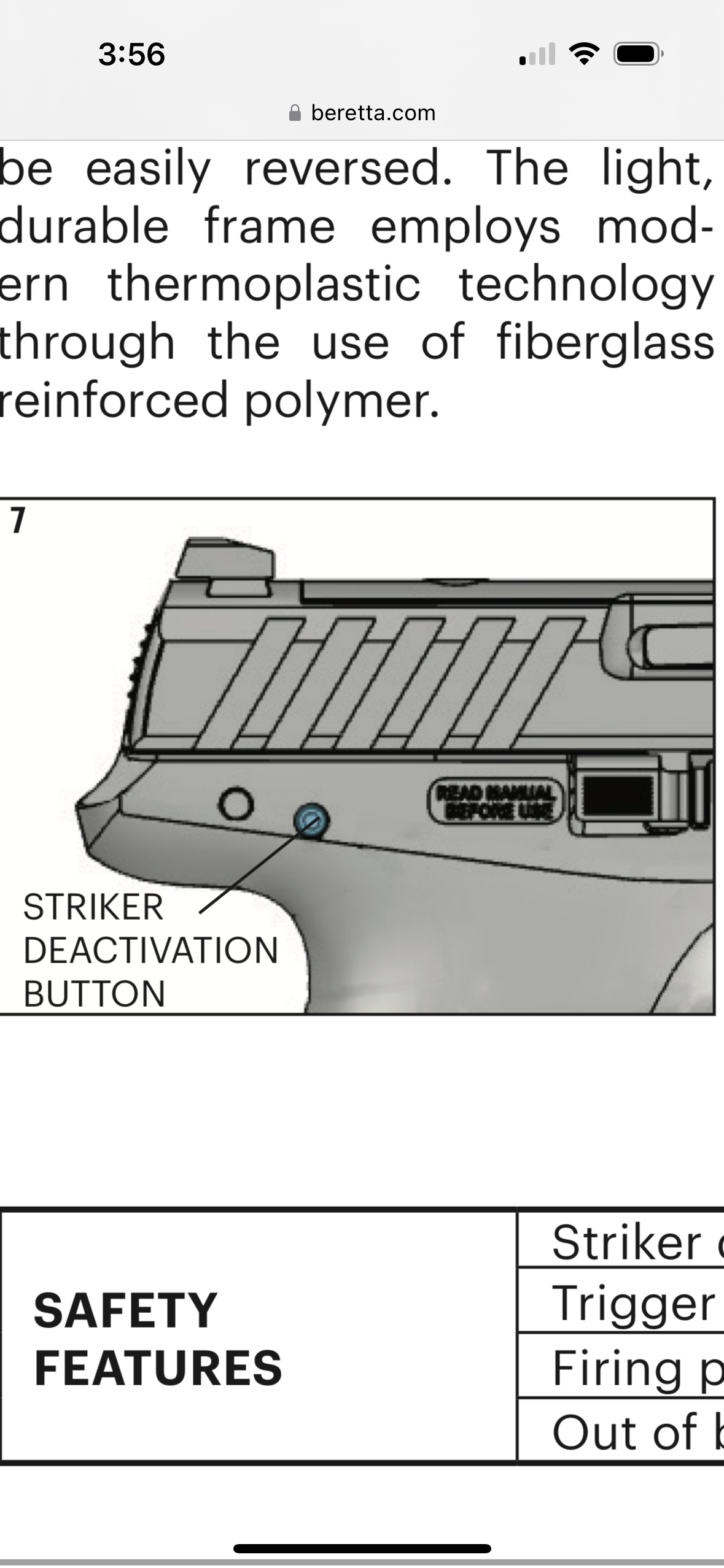

The switch is just a small hole on the one side that you take a ball pen and push in on it after you pull slide back about a 1/4” inch or so
when i saw that originally, i thought it was a connecting/holding pin, like on a Glock
but i think its like my S&W, i have to push down that lever in my pics, all you have to do is push that button...

No, it’s not a safety, it’s just a way to release the striker without pulling the trigger for disassembling, that’s all it’s for, nothing else, my question was isn’t it the same as pulling the trigger before disassembling, like dry firing the gun without pulling any trigger.
