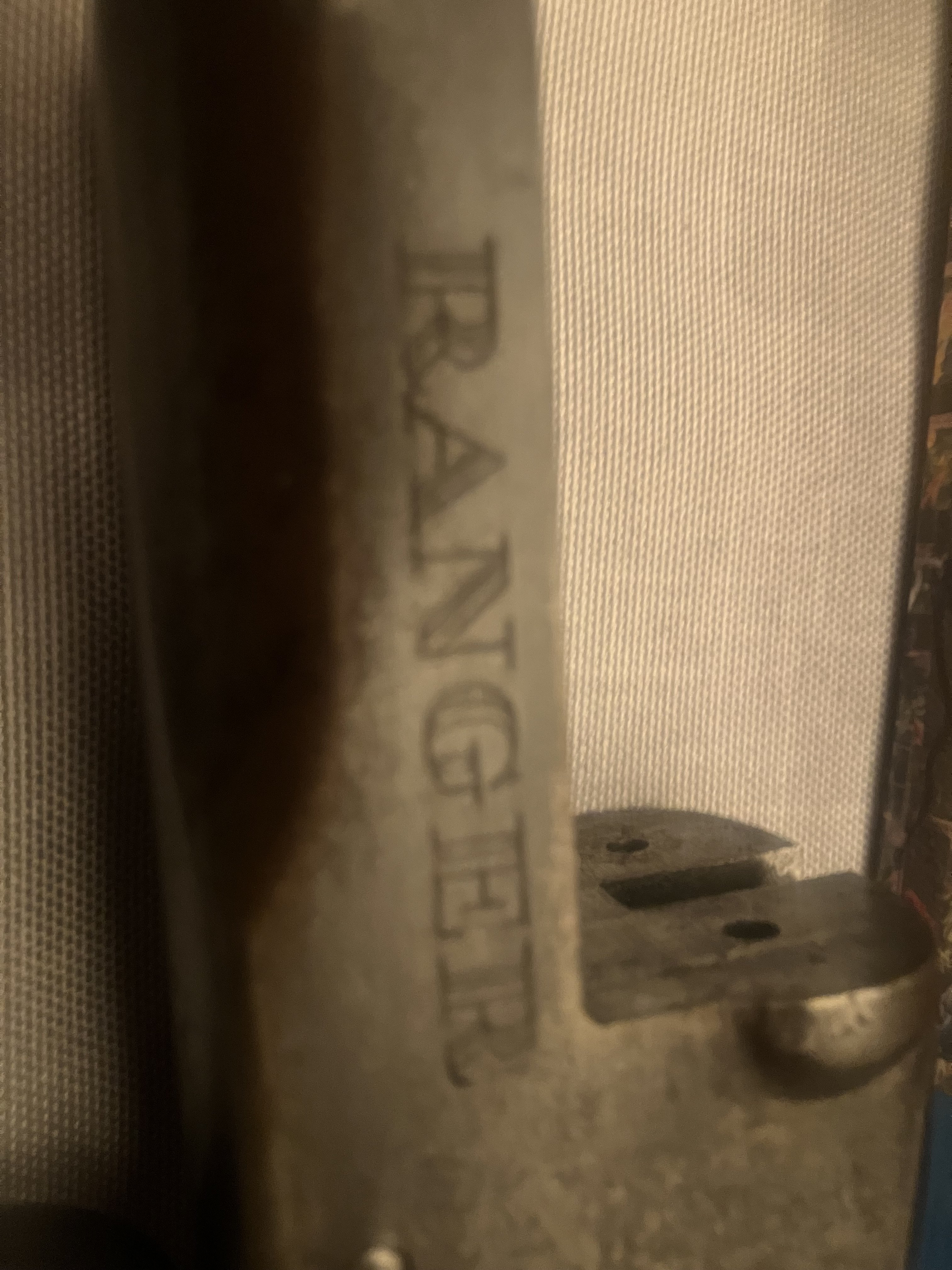

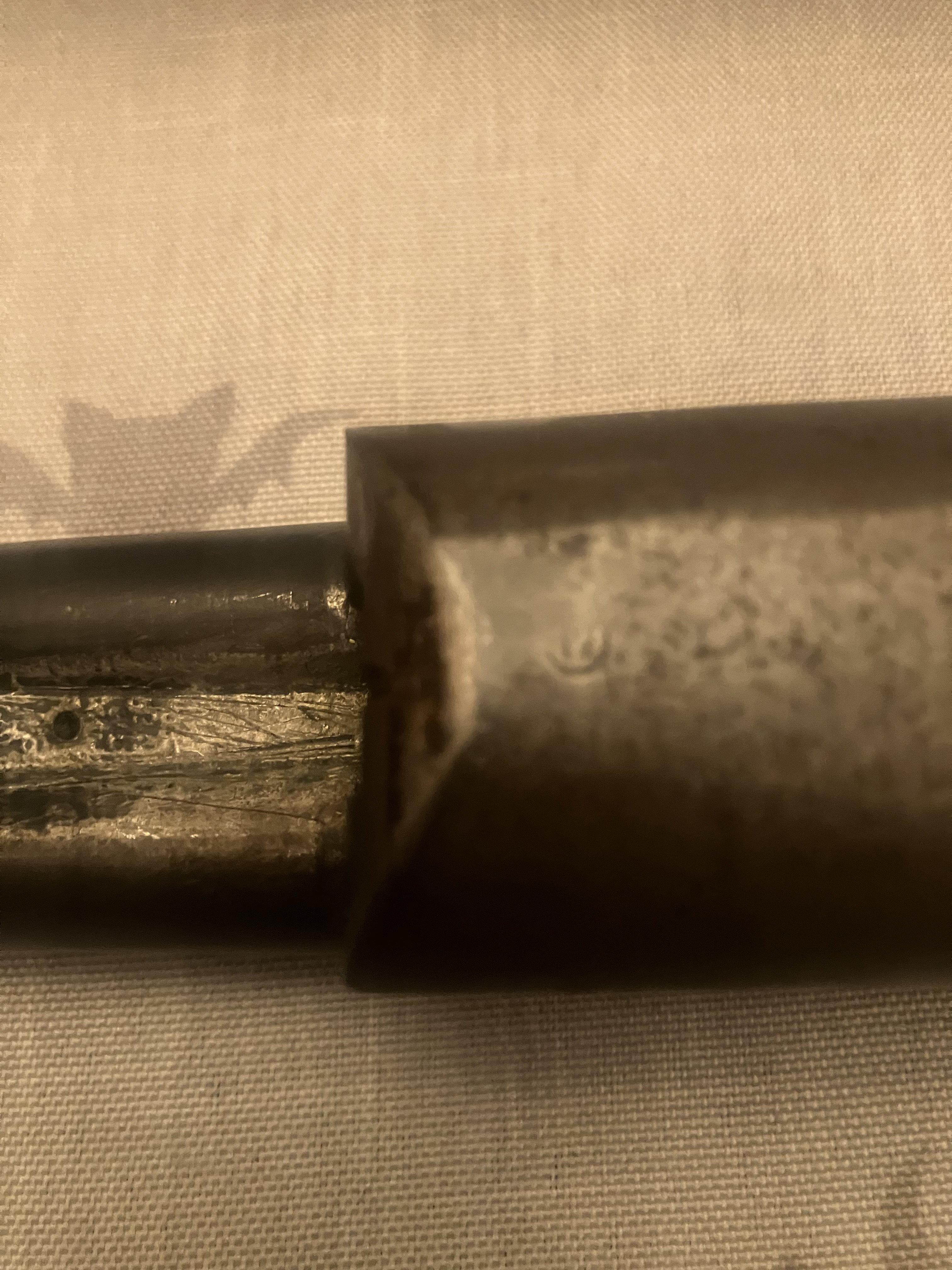

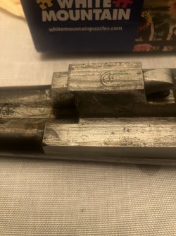

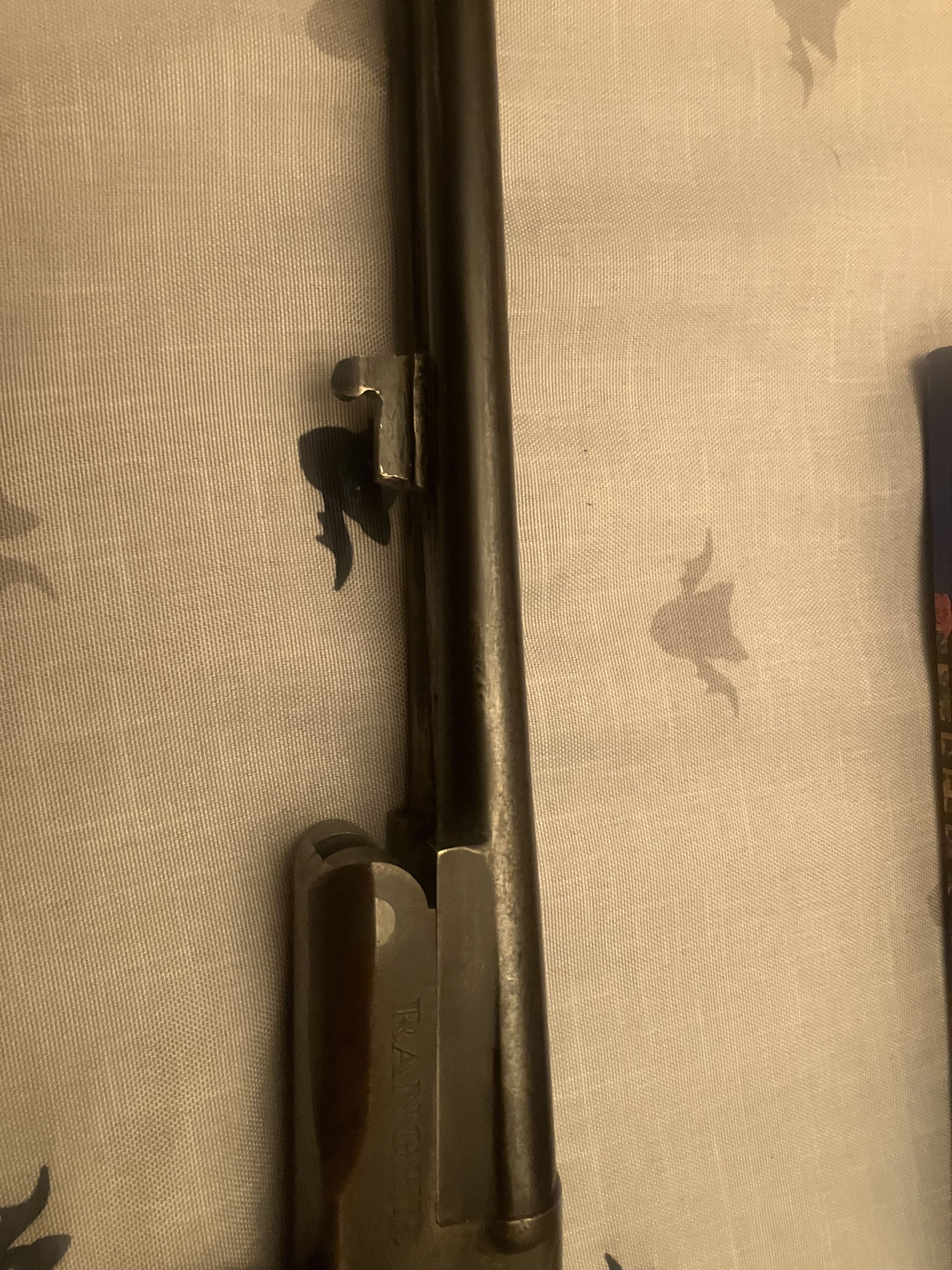

Ty Grayfox. Only number i can find is X66367 on forearm metal and same number stamped in the wood on forearm, bottom of barrel and receiver. There are no numbers after the RANGER logo. Has PAT. APRIL 20 1915 under the ranger logo and 410 gauge on top of barrel. Has a number 12 in a circle on the under side where barrel meets the receiver.

I'm afraid I'm not finding anything like the number you provided. I'm thinking that is likely a serial number. Can you post some pictures? That would help.

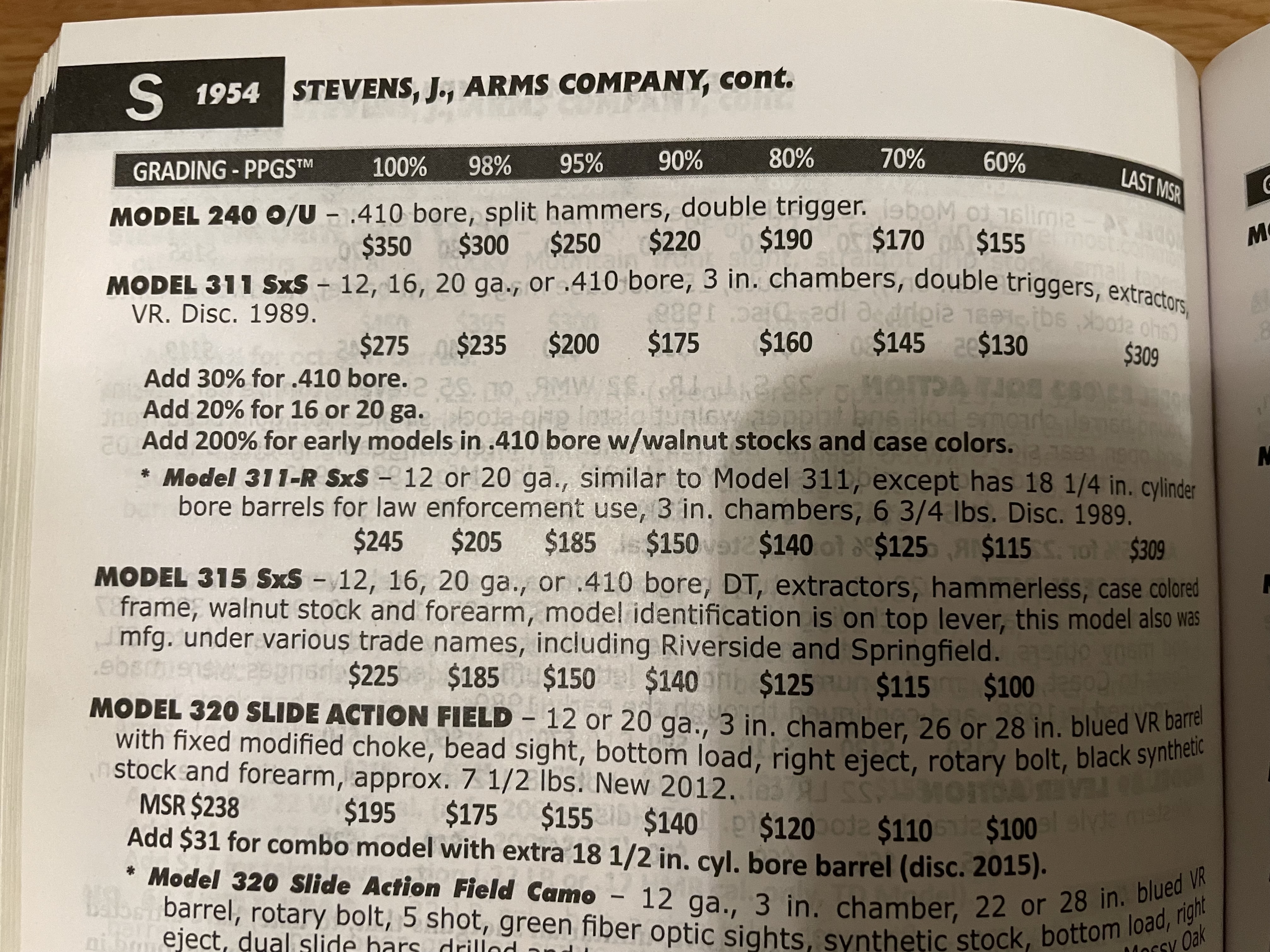

Patent stamp means it’s a Stevens. .410 production started in 1925 and by 1929 they stopped using the name Stevens and started using Springfield. Stevens records were destroyed in a fire so no serial number data base. So it’s a Stevens 311 made between 1925 and 1929.

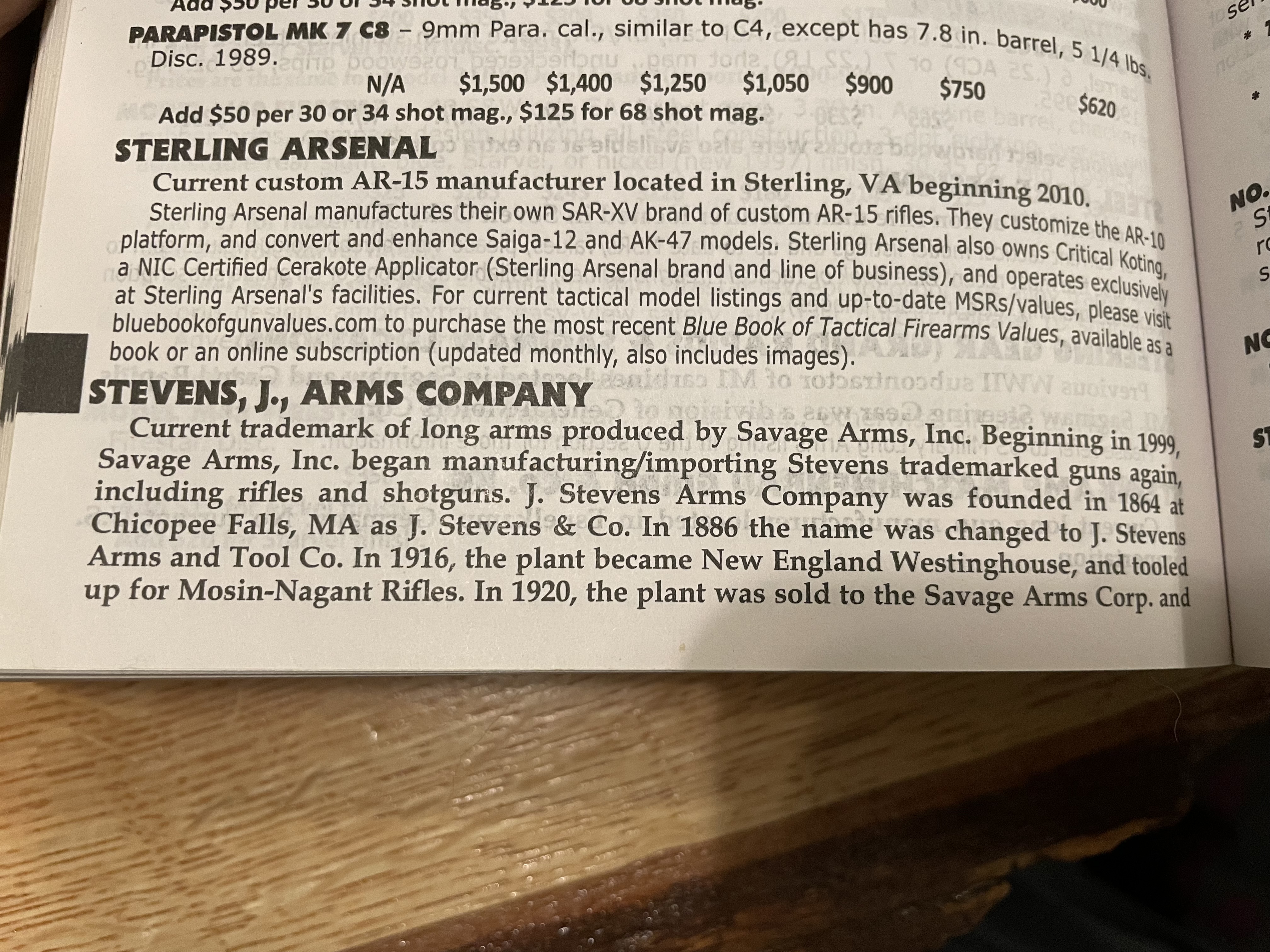

Just a little digging around in a thick book. Might be close to what you have. Really cool gun!
