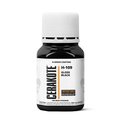

Get the Cerakote H series - DYI oven bake stuff
Not expensive
Lots of color choices
Cerakote link has the colors- scroll down to the H series.
The ebay link actually has a drip down box for the colors
$36-$45 on Amazon or Ebay for 4oz bottle
Not expensive
Now, see, that's a LOT of money to me--but then again, I'm so old I remember when a bottle of Testor PLA enamel was ten cents. :eek:
And it still requires an airbrush to apply. And still needs to be baked, right?
This is more what I'm talkin' about. No, it's not as durable as Cerakote, but it DOES last a good long time (mine's been on my shotgun barrel for over 20 years with no issues of any kind), doesn't require baking, and is hella more cost-effective for less-than-heirloom-quality guns. ;)
