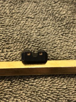

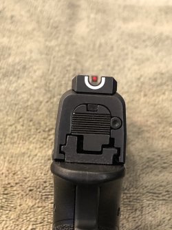

Thanks for all the advice! I just used a heavy hand on the sight pusher and it broke loose with a noticeable pop then pushed off. I replaced the old twin white dots with the bright white U sight.
