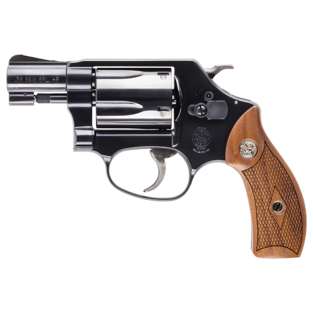

This what is listed on the S & W web page, so I guess it's still in production for a MSRP of $829.00. They show the barrel length at 1.875" , so apparently the 3" barrel has been discontinured. While is still is a 5 shot new ones are rated for 38 S&W SPECIAL +P. Like HansGruber said, an older model that's in good shape that you find desirable for $700.00 wouldn't be a bad deal. I'm just not sure if you would want to shoot a lot of +P in an older gun. I'd check with S & W for a definite answer.

So, on +P in older S&W revolvers.
S&W will tell you no…as a default CYA position.
That being said…I have a number of older S&W .38’s that predate the +P loading that will handle it just fine; like all +P loads through any handgun, though, a limited diet is the smart move.
There’s two reasons for this; the first is the watering down of handgun rounds through the years. Older loads were usually at the top of the pressure/velocity curve for a given caliber, unlike todays loads which…aren’t. Today’s +P loads are barely hotter than standard pressure used to be (loads from boutique mfg’s—eg, Buffalo Bore, Doubletap, Underwood—are different).
The second reason is Elmer Keith. If you don’t know who he is, Google him…but this is the guy who invented the .44 magnum by hotrodding .44 specials to the point he blew up pistols.
When the J-frame “Chief’s Special” came out, he decided to test the copy S&W sent him with some of his .38/44 Heavy Duty loads (the .38/44 being a precursor to the .357 Magnum; a .38+P++ load, if you will—a 158gr bullet pushed to around 1200fps). And if Elmer loaded it, it was a HOT load.
After 200 or so rounds with no damage, he deemed the Chief’s Special suitably sturdy.
So…a few rounds won’t hurt it.
