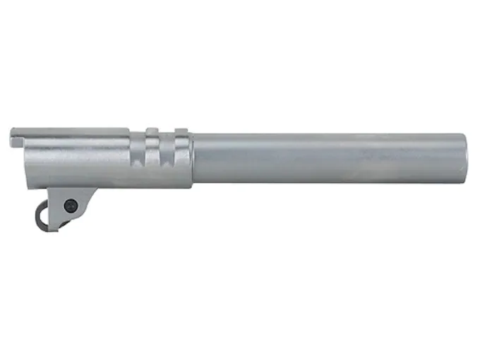

update:
i fixed it...the pin itself has stake imprints.
a whack with a new tool i did NOT have to buy, cuz i just found one (dang it) was all it took.
here is a pic from Midway, i didn't take any pics, but you might be able to see the punch mark in the pin itself.
in fact, this picture, shows 2 punch marks on the pin, mine only has 1 on each side.
