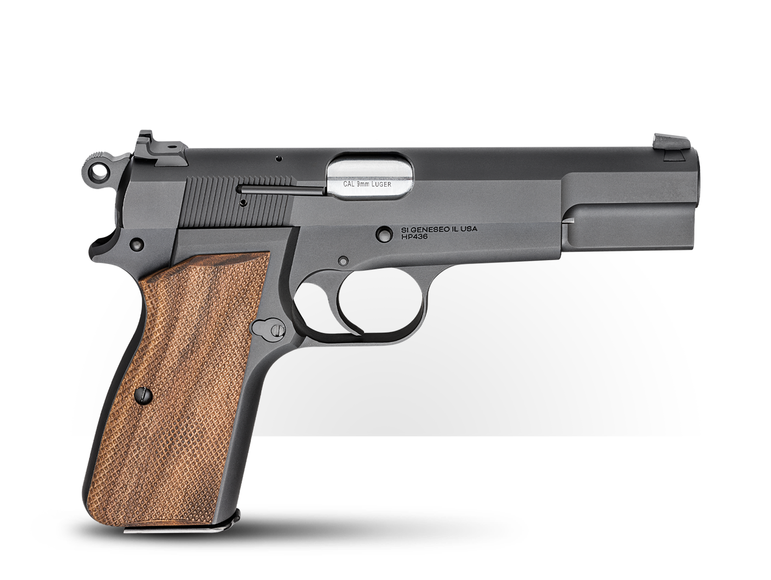

Did any of you catch Garand Thumb's SA-35 review on YouTube today? He talked about it having extractor issues after 800 rounds so SA sent him another one and it had issues as well.
He talked about them both being triple digit serial numbers and one of his followers has a triple digit serial number pistol with the same problem.
Could this be an early production issue? I'm really wanting one but curious about this.
Any one on here have one? If so, any issues with it?

I think the issue is that, at least with the Garand Thumb review, he only hit the extractor problem at around 800 rounds. Not many people have the SA-35, and those that do are unlikely to have fired 800 rounds through it yet.
I’m going to wait until there’s a larger sample size.
I have a mid 2000 serial number- I do like it but very concerned about extractor problems. I did return it under Warrenty but still having issues.
Have fired it approximately 650 times and roughly 25-30 failures to eject.
I have shot about 8 different types of ammo- worst problems with Winchester fmj and Sig Sauer 115 grain jhp Defensive ammo
As some of you know, I picked up my SA-35 late last month and didn't make it through 100 rounds without a couple of failures to extract. Sent it back to SA and they replaced the extractor spring and it has made its way back to me today.

As I posted earlier...same problem. I do love love the look and feel as well. I sent back first time and they replaced spring, but I continued to have trouble...second time around I documented very carefully my failures....they replaced the extractor and now its working great...have about 400 rounds through her since second repair without a single failure.
hopefully your is fixed. (When I called second time they said notes by technician showed they shot 50 times unable to duplicate....possible- so I shot 270 times different type of ammo, including photos of each malfunction....most of the failures did occur after the 40-50 round point but started happening more frequently as rounds increased. anyways after the second repair it is behaving as one would expect)

They show "repaired, safety check and tested". I was curious as to how many rounds they ran through it. Thanks for the info and I will be sure to pay close attention around the 50 round mark and hope for the best.
