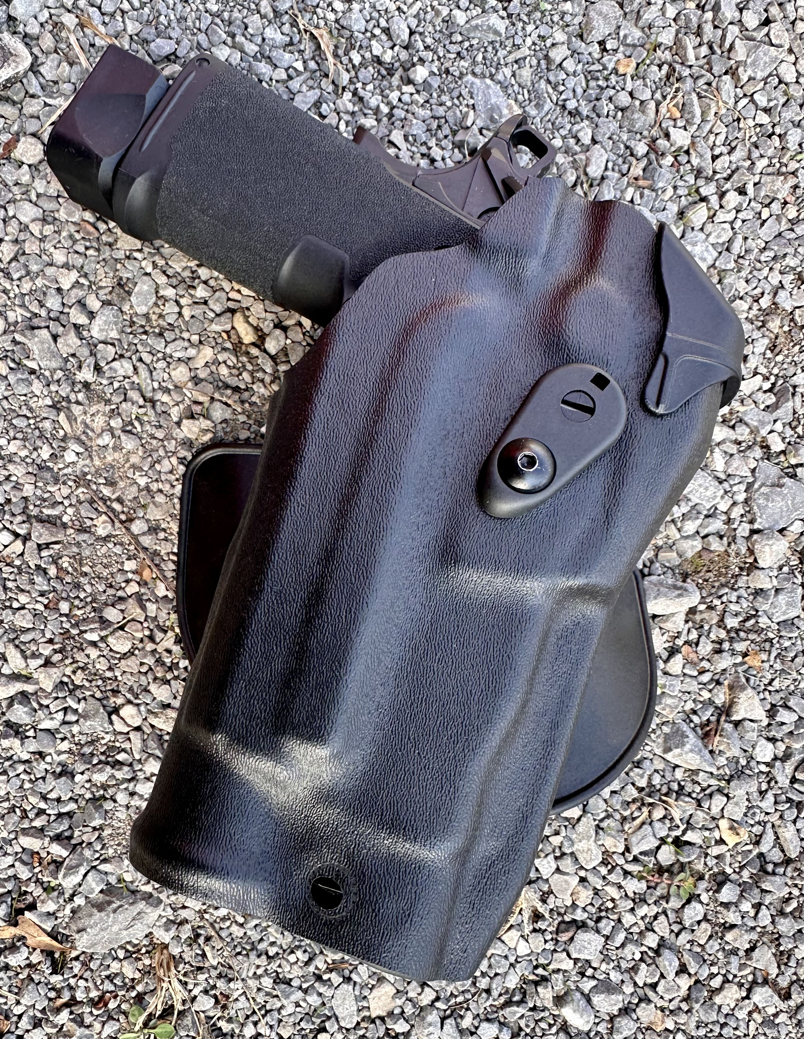

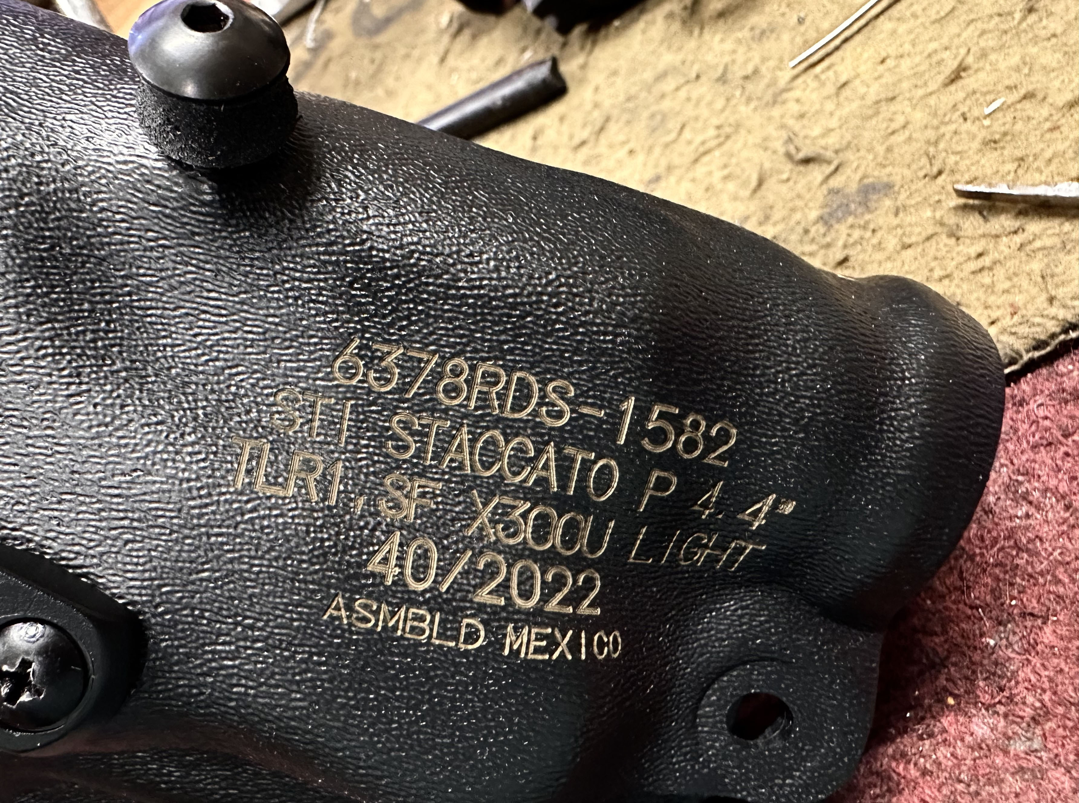

Out of the box: the holster will not work with the 5 inch Prodigy. The pistol will insert into the holster but bottoms out and will not insert far enough to lock. Good news though the Springfield Dragonfly will work with the RDS portion of the holster including the hood that protects the dot. So examining the holster, I can see the problem is the slide is running into the bottom of the holster right at what I will call the pinch weld. You can see it next to the screw driver.
I am so close….I am going to make it work hell or high water. My plan is to remove the barrel alignment nub base, and the light cap so I can see whats going on. Yep the pinched kydex has too much taper. So now I grab a bunch of quarters to act as shims inserting enough to spread the holster slightly until the slide can fully seat and now lock. Great so my theory now works. I remove my quarter shims and now the prodigy is stuck pinched by the kydex. Easy peezy next I use my heat gun and warm up just the tip of the holster near the pinch area. Warm the kydex to right below where the kydex is too hot to touch. Kydex will turn mailable and I was able to remove just a little bit of the pinch.
The Remolding looks so good that you would never know the factory did not do it. Now that the kydex cools to form around the longer slide, and voila the 5 inch Prodigy works and is in like Flint! I adjust the light tensioner to my taste and now I have the perfect carry package. I will reinstall the light cap, and work on the barrel nub later. Really there is no need for it, since the holster can just be open bottom. I have wiggled and rocked the heck out of the pistol, and it locks solid
So now I have one holster that will work with both Prodigy’s. Two seconds with a heat gun and any Safariland Duty Stacatto holster will work with the longer Prodigy if thats what you want to carry on duty.

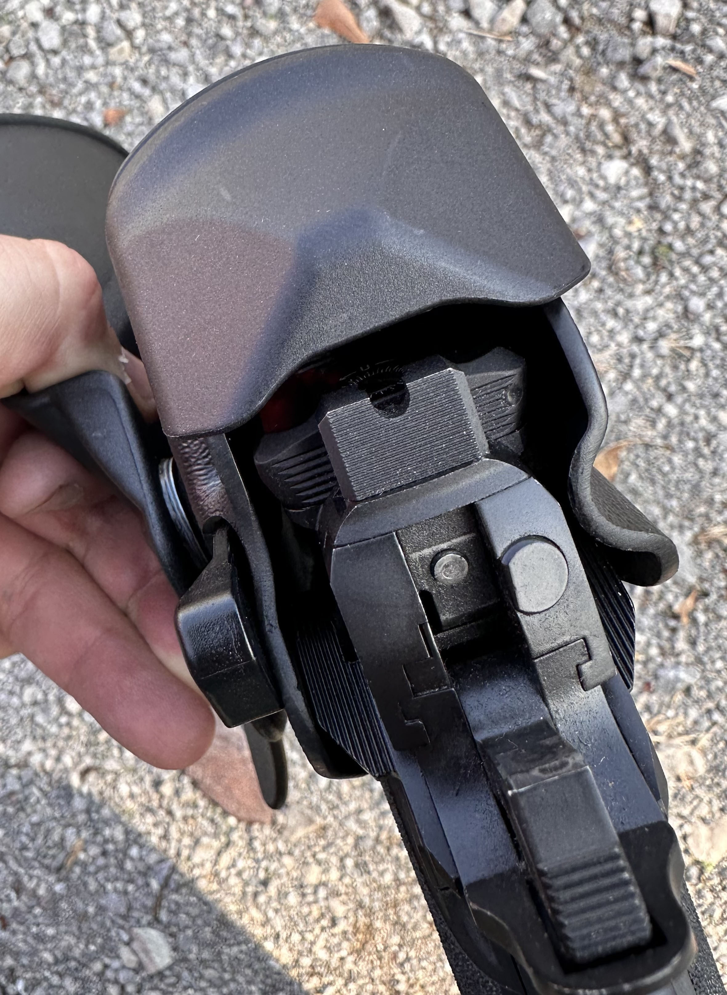

A nice view of the RDS hood that will Help protect the Dot.
