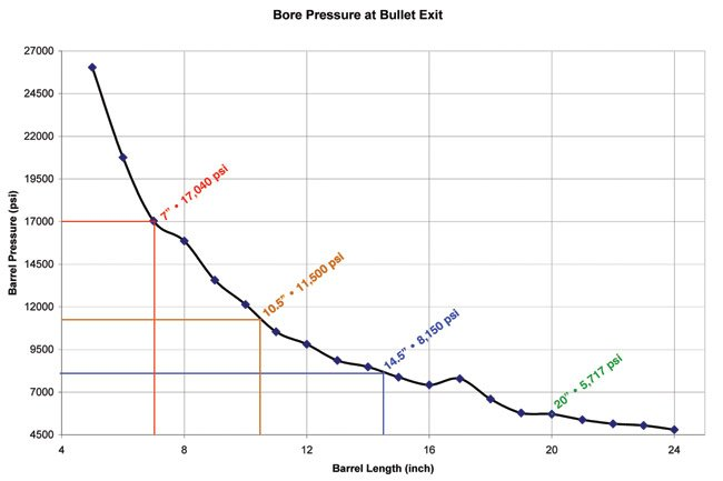

Carbine gas systems run harder and have more felt recoil based on the higher gas port pressure. That is, the pressure(s) once the bullet exists the barrel with mil-spec loads. Pressure goes down with greater barrel volume as the chart indicates. Shorter length M16/AR15 barrels are over-gassed due to the gas port being closer to the chamber vs. the original 20" length for which the 5.56 was designed for.
This chart also shows the relationship of barrel length against bore pressure.

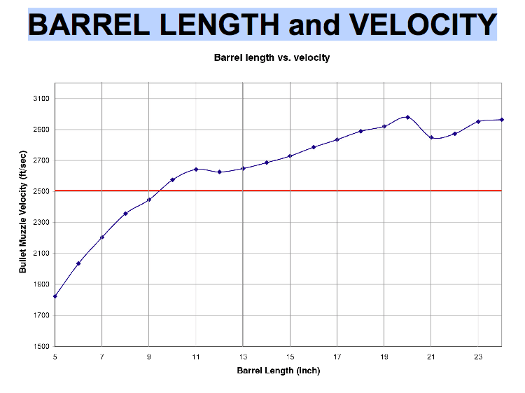

Subsequently, there is an near inverse relationship between barrel length & velocity. Peak velocity is achieved with a 20" barrel since the .223/5/56mm was designed for a 20" barrel.
M855 Barrel-Length-Velocity
