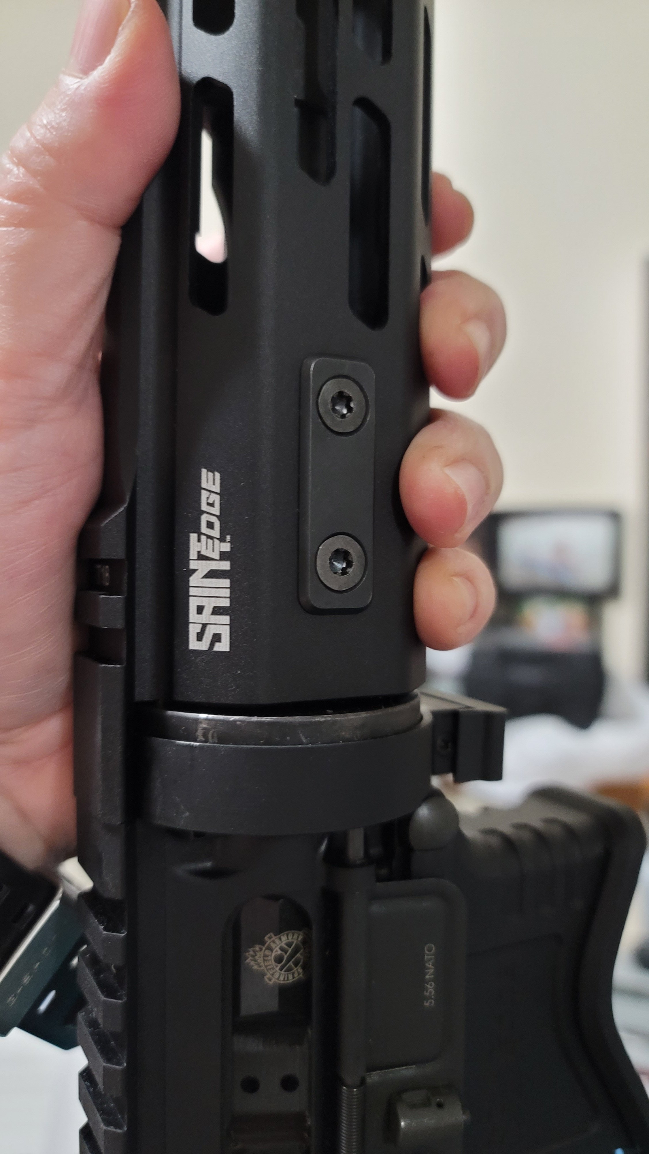

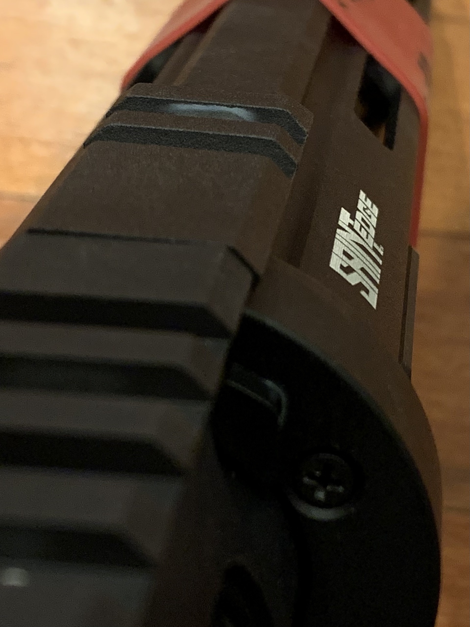

Got my first SAINT® EDGE pistol and despite all efforts, the barrel will not align into the upper receiver. Does anyone else have this problem?

Does the Saint handguard use an alignment pin between the handguard and reciever?
It's probably a barrel nut timing issue.
If you don't own an armours wrench and reaction rod you can take it to a local gunsmith and they can fix it in a few minutes for around $20 or less.

Thanks @10mmLife! I don't think so, trying to figure out, maybe you see more:
The Evac has a unique take down system that I'm not familiar with.
Have you tried pulling back on the BCG when you reassemble to take any pressure off the the locking lugs for easier alignment?
This is a step I take when separating a couple Ruger takedown rifles I own when taking them down.

So this is one of the few SAINT models I don’t personally own, and I have only had hands on with one a year ago For a few minutes. But the Saint group on fb has several members with EVAC’s. This would probably be a Springfield fix though.
I think possibly it could be as simple as the hand guard was not tightened properly.
2 screws on either side hold the free float hand guard. If they are tightened improperly, or say tightened one side then the other side, it may put the hand guard in an “off center” position relative to the receiver top rail and not mate up perfect. Have you tried with the gun fully assembled to just remove the 4 screws holding on the handguard, slide it off, then slide it back on and see if it aligns properly?

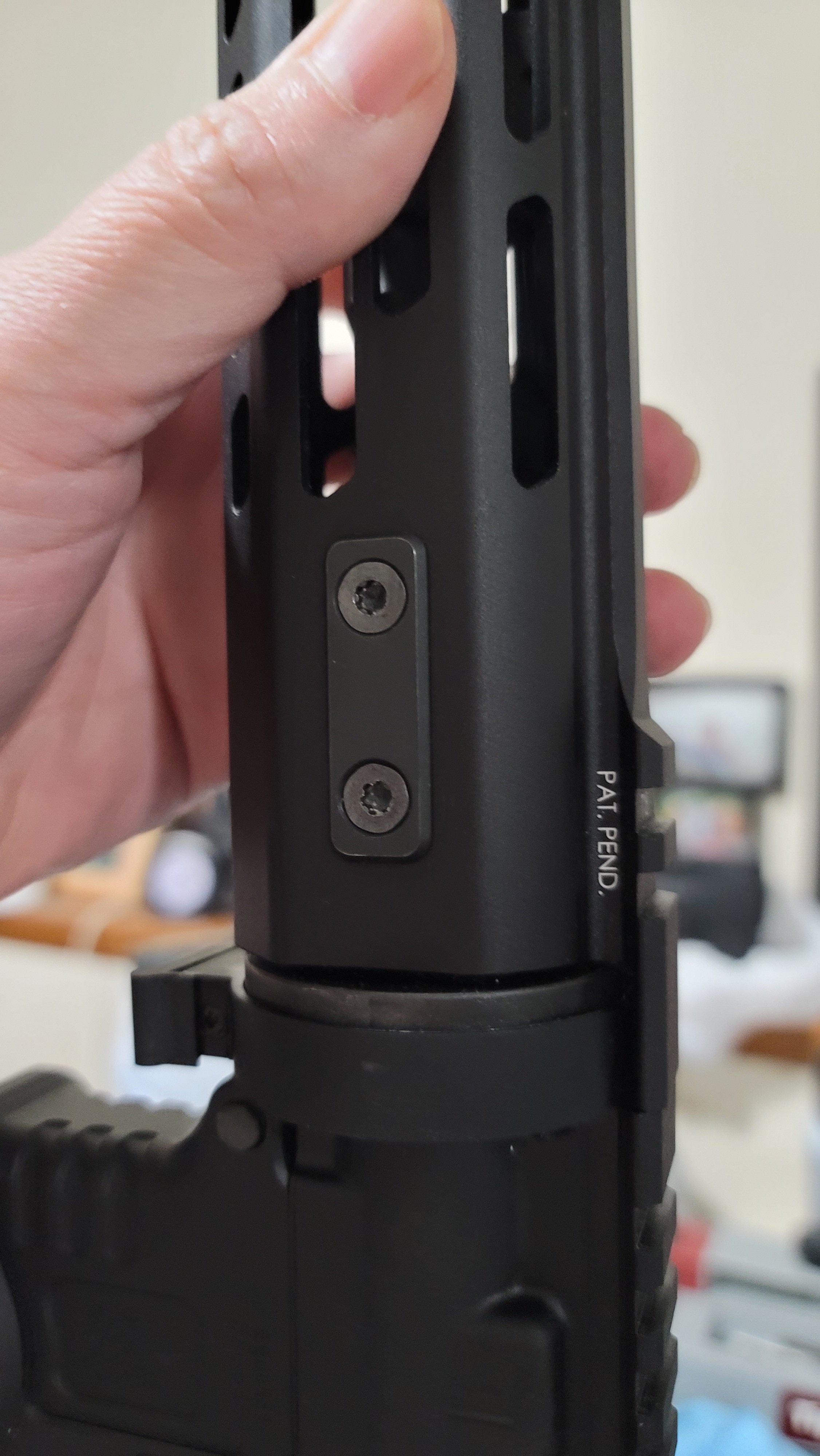

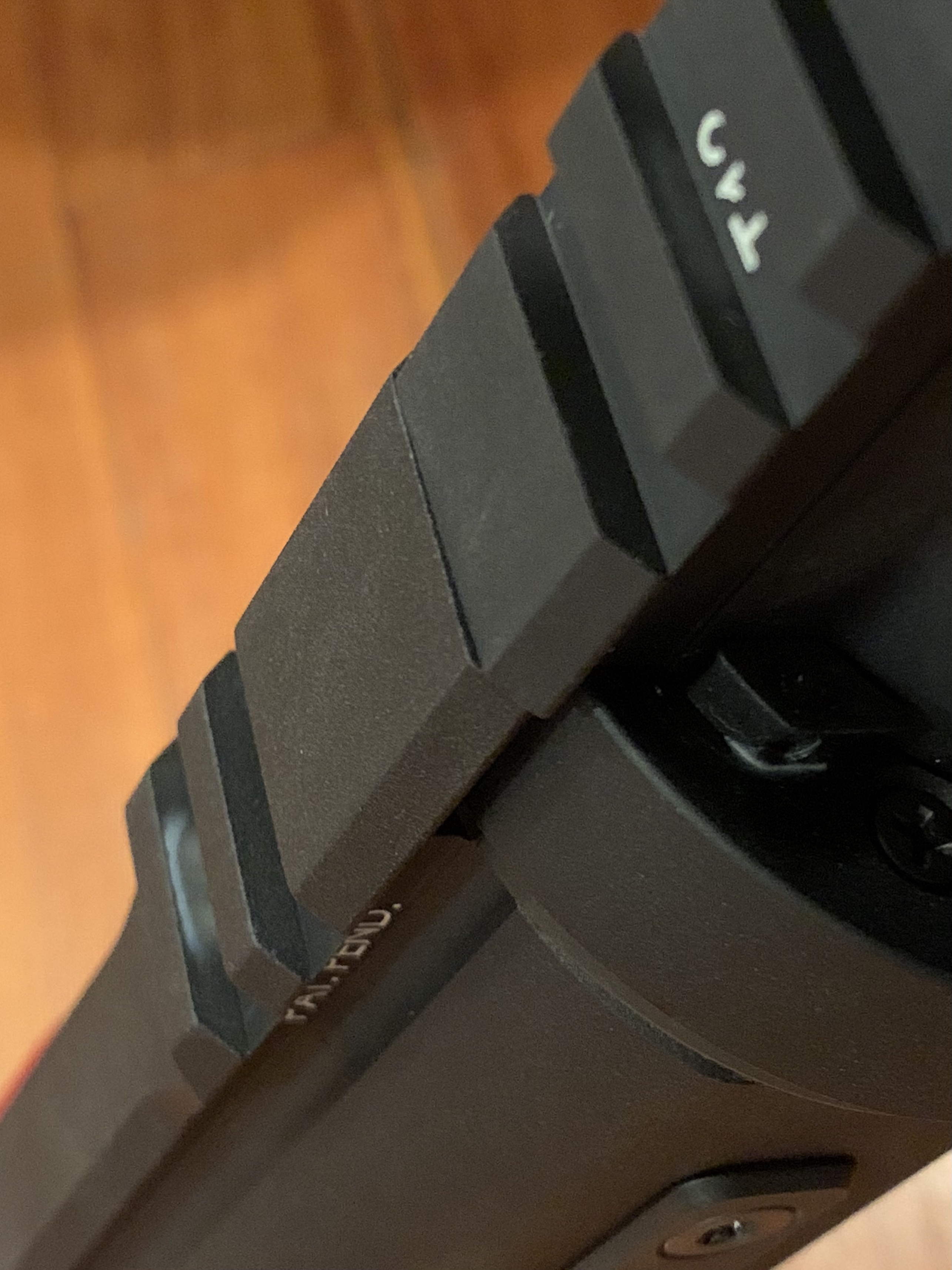

I found the issue, if take these off you can aline the top part to the back part. The issue is the holes dont line up correctly, so when you put these screws back in, it will misaligned again. I did it for about an hour, these plate and screws are off. I contacted Springfield and mostly likely will have to send it to them to fix. I bet you they just use a different plate and screw and the problem is fix.

Just sent my saint evac to springfield on 12-29-2021. The customer service was amazing, they'll send out a FedEx printing label with instructions and full coverage insurance for your pistol. Will updated if anyone is interested knowing what they did.
