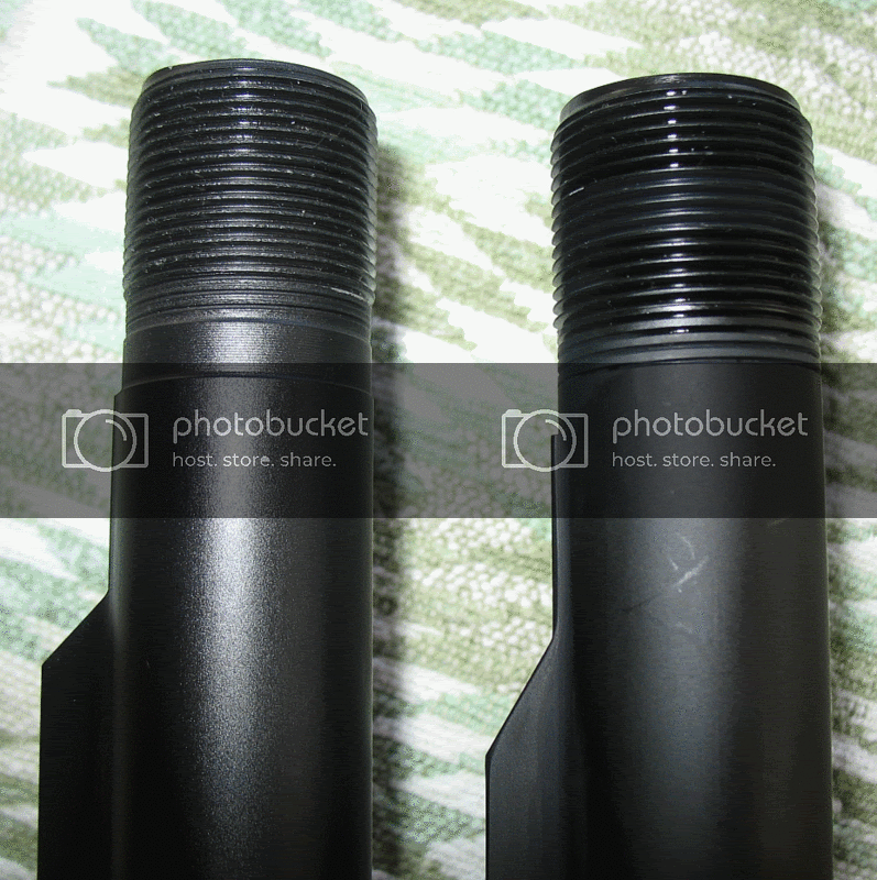

The end of the buffer tube will be
flat (mill spec) angled (commercial)
Not all commercial tubes are angled; DPMS used commercial-diameter tubes that were flat, for example.
The best way is to look at the threads where it goes into the receiver...of the threads are taller than the receiver diameter, it's milspec...if they are the same, commercial.
milspec tube on the left.
