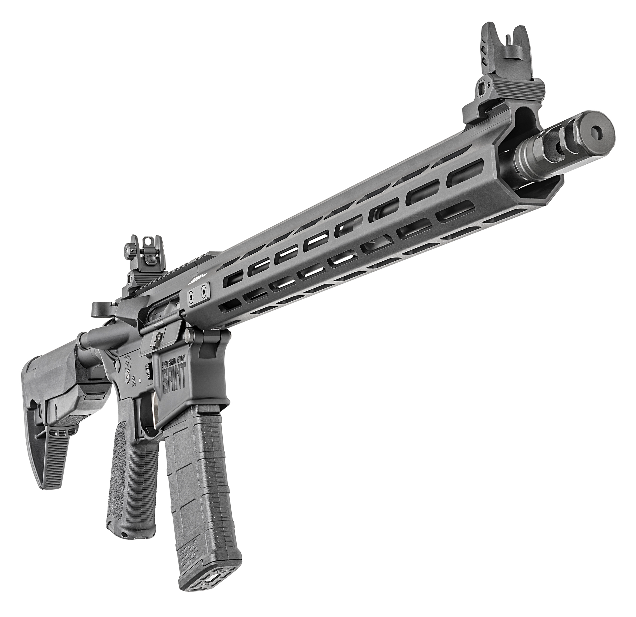

Hey y’all,
I just bought a Saint Victor 556 AR Rifle and I want to get a can for it. If at all possible I’d like to keep the SA Brake on as I love the current recoil impulse. Does anyone know of a suppressor that interfaces with the SA brake that comes on the rifle?
Affordable if possible.

The can will give more recoil reduction than that brake will.
Looking at it, I don’t see an attachment for a suppressor on the muzzle device.
Personally, if you want a good brake/comp for use with the can off, that will attach to a can—get a Surefire SOCOM device, and a Surefire can.
If as the pic looks the handguard is to long for a can. Make sure on handguard id before you get a can. Ad mentioned before you WILL need to remove the current device before installing another that WILL accept cans (either a taper lock or the click locks) that use brake attachments would be better than direct attachments. Better as in easier to remove and reinstall. A very effective brake that will let you attach a can is a Lantac Dragon. I have 1 for a 12.5" 308 and a 11.5" 5.56.
