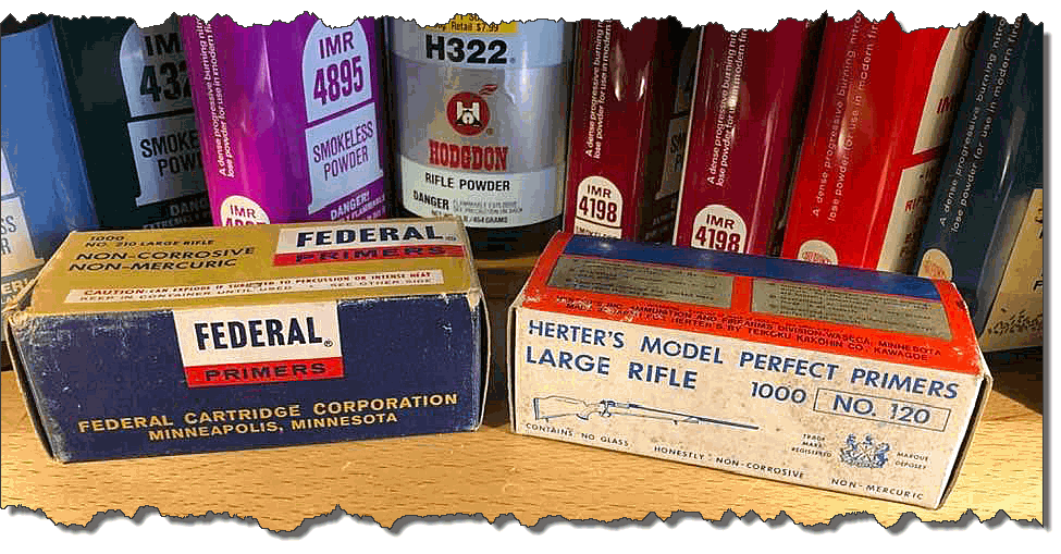

How long does powder last stored in factory sealed plastic bottles & primers stored in zip lock freezer bags, with most of the air removed? The oldest stock is from the early 90's
i got mine in zip lock bags, in a heavy duty plastic container, with a few bags of desiccant.
my powders are on a shelf, lids tight.
i run a dehumidifier in the summertime, everything is in my basement.
i worry more about the asbestos wrap around my overhead heating pipes falling on me or my reloading bench.
No worries. I finished some Winchester Superlite that I got off my doctor years ago. I've stored it in the garage that can get pretty hot in the summer. I tried to pinpoint the date they last made it, but couldn't get them to commit to a year. Best guess is maybe '92 or '93. Too bad they stopped making it, works great for autos and I've used it mostly for revolvers. With obsolete powders, you have to peruse old manuals or work up loads from what you can find.
WSL was my main powder, I bought mine really cheap when Winchester stopped making it.
Had to dig into my 'stash' when the plandemic hit to develop .308 loads for my Son's rifle... this old stuff still worked!
As others have stated; as long as you keep it well stored!
