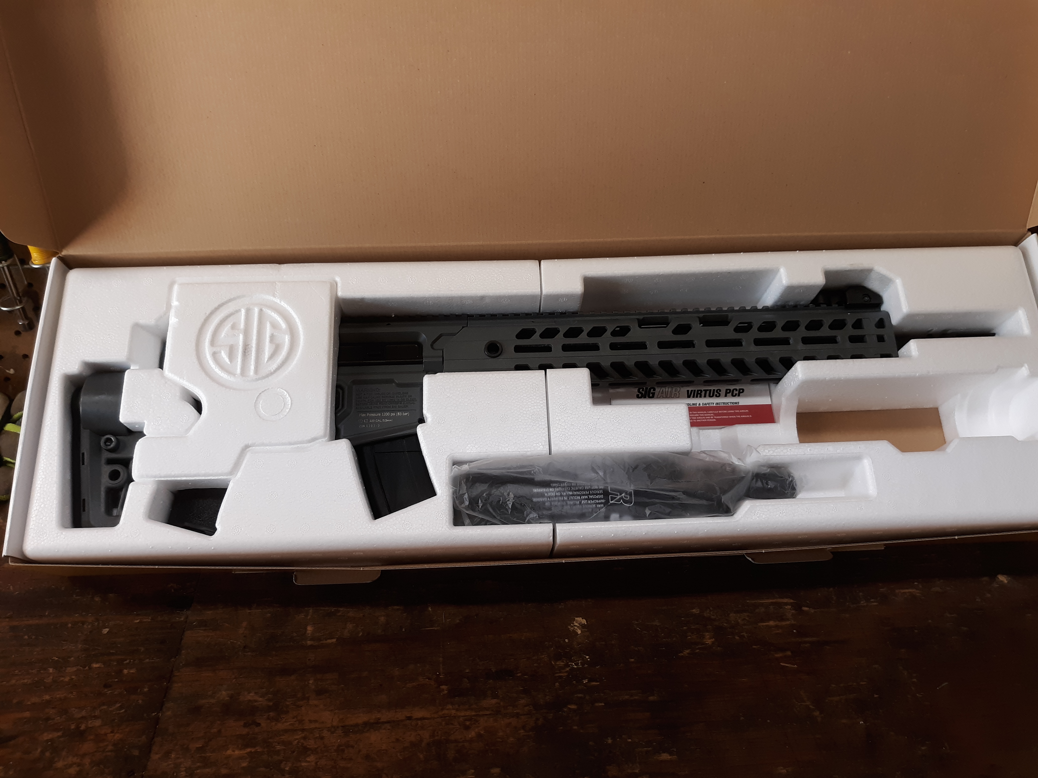

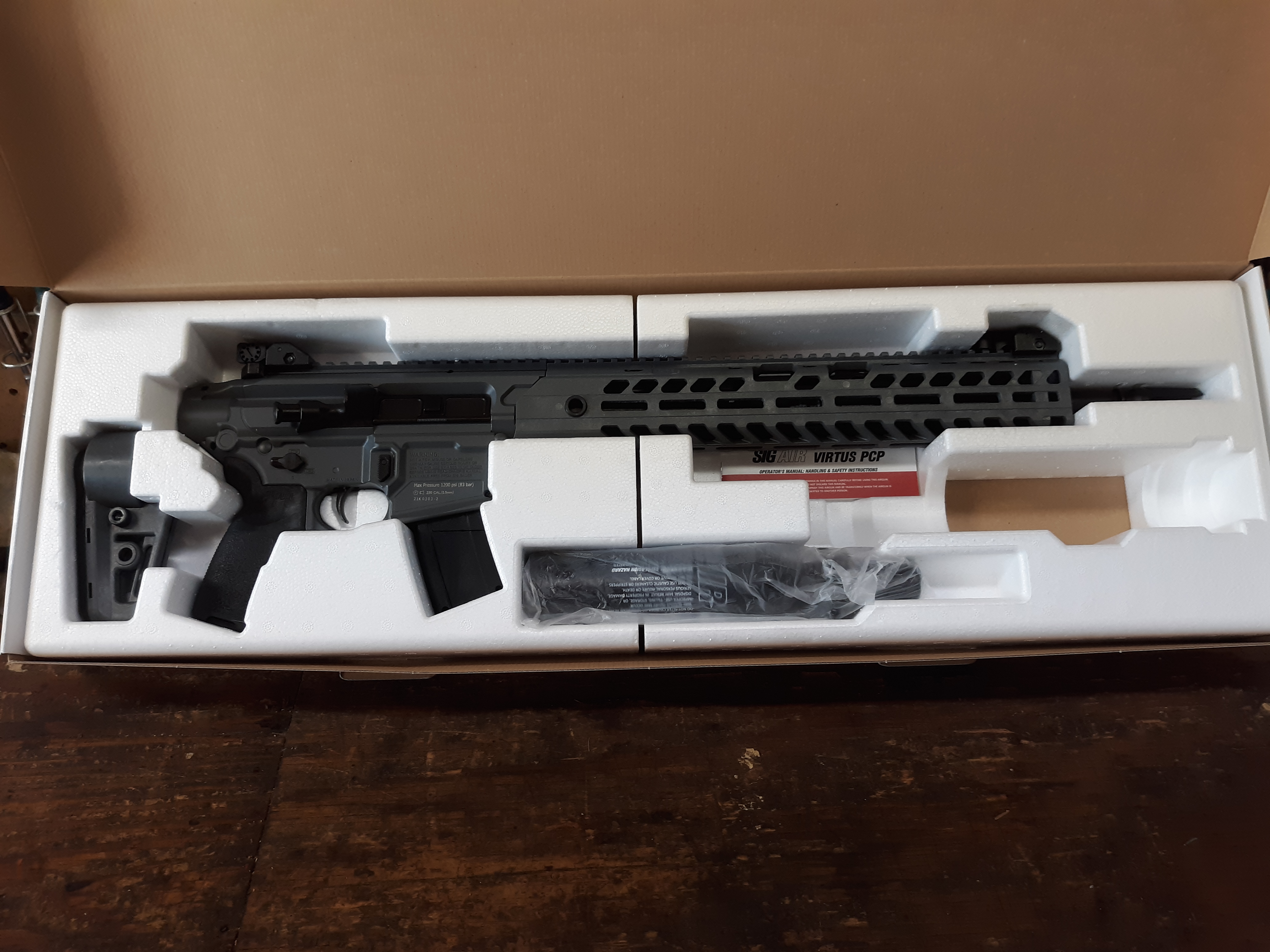

This is the old rifle, think i will put a scope of some kind on the new one when it gets here.
