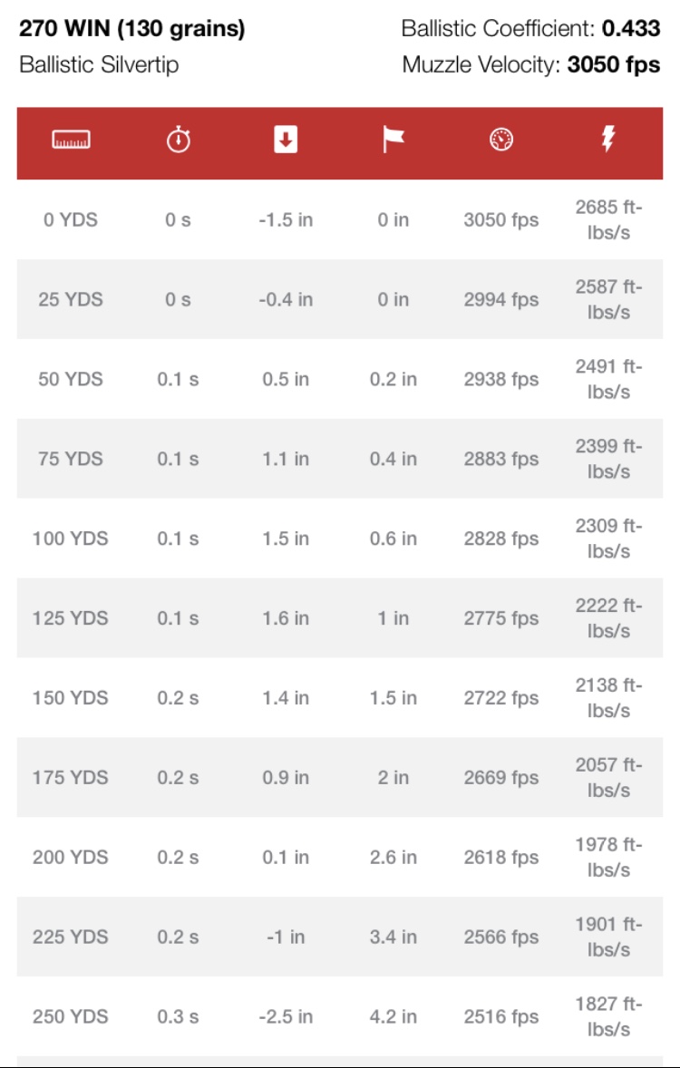

Looks like a 50yd zero puts you an inch low at 100, give or take a tenth.
For the distances the OP is talking about, I'd zero at 75; that would put you about .5” high at 50, and the same at 100...and that’s a dead on hold at both distances in my book.
This data would pretty much be the same for any 130gr .270 at about that velocity at the ranges we are talking about...
