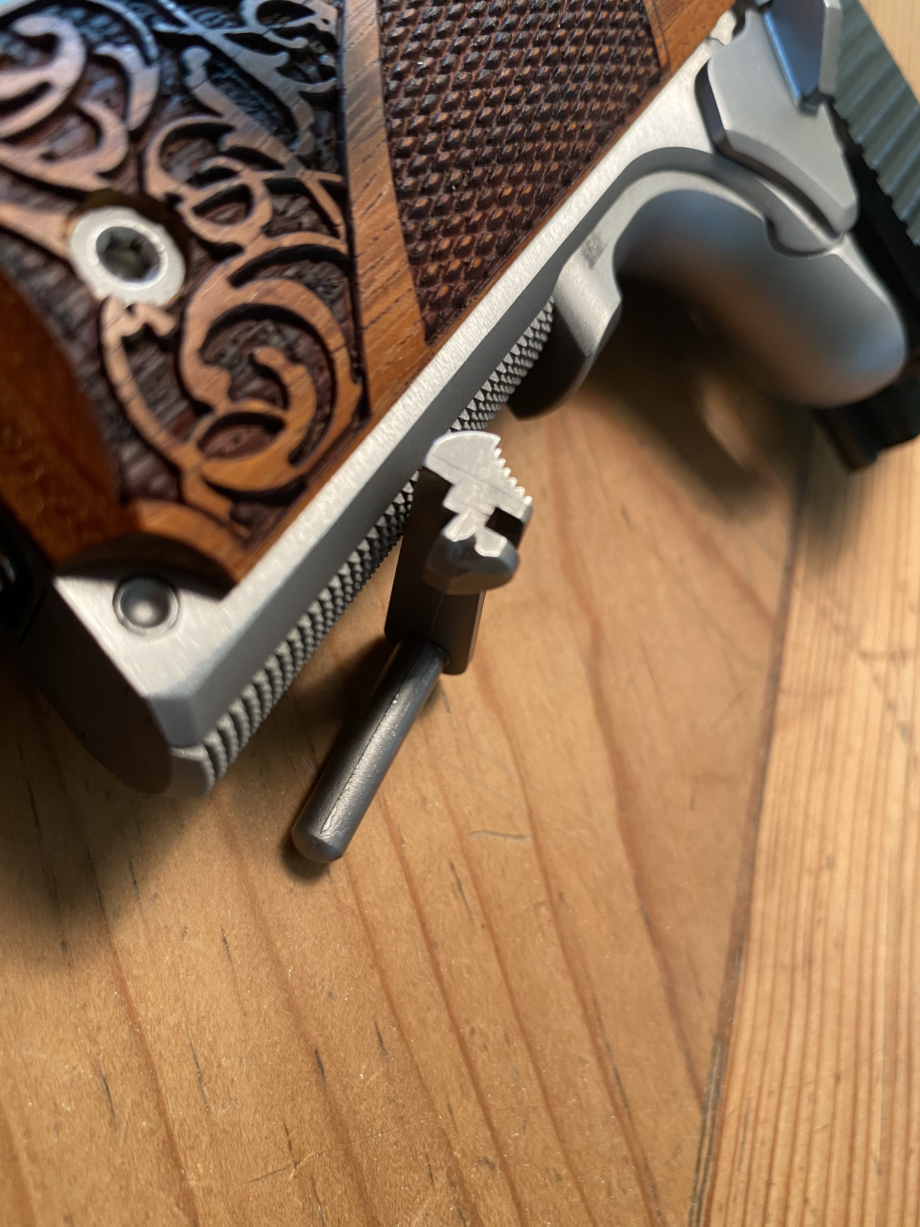

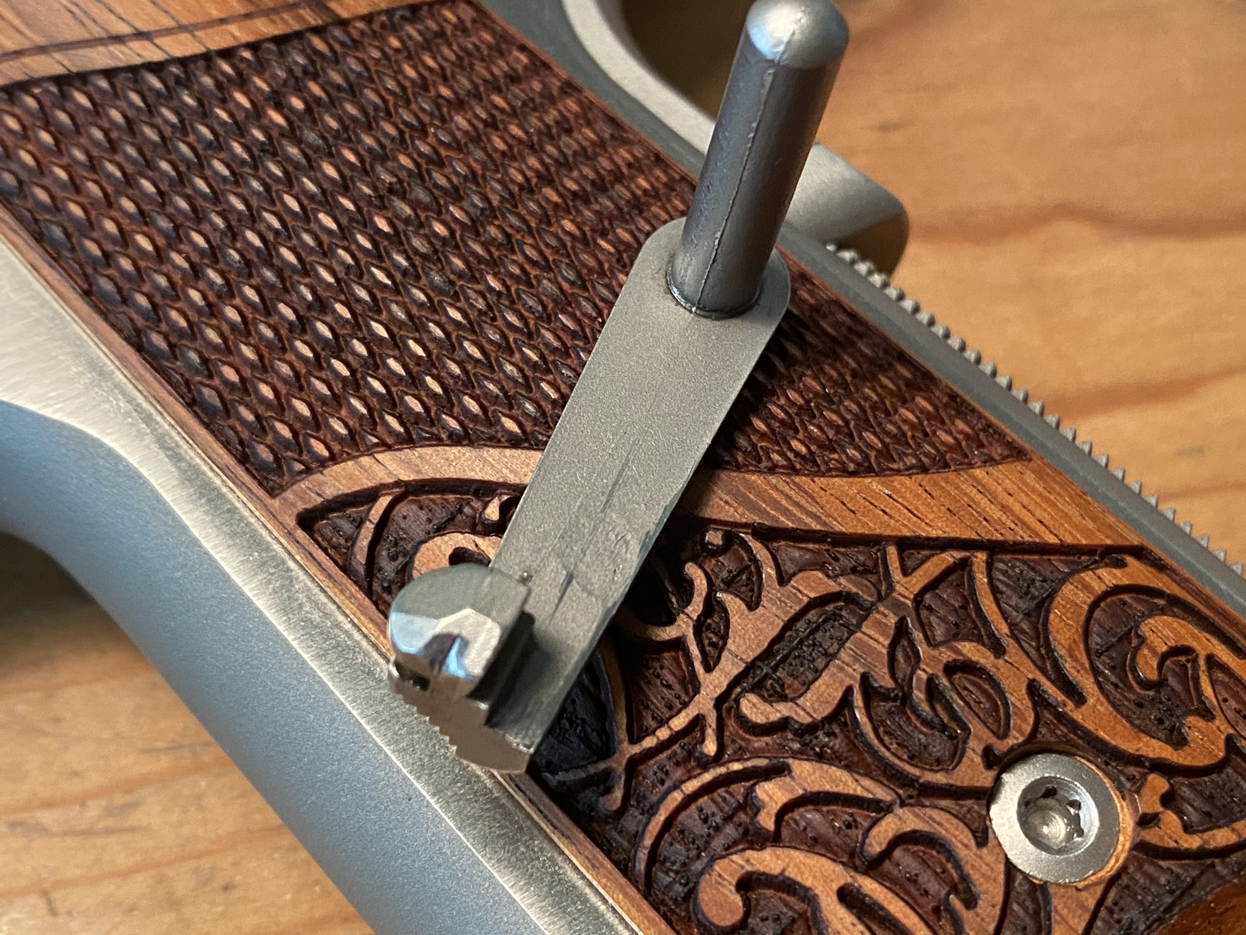

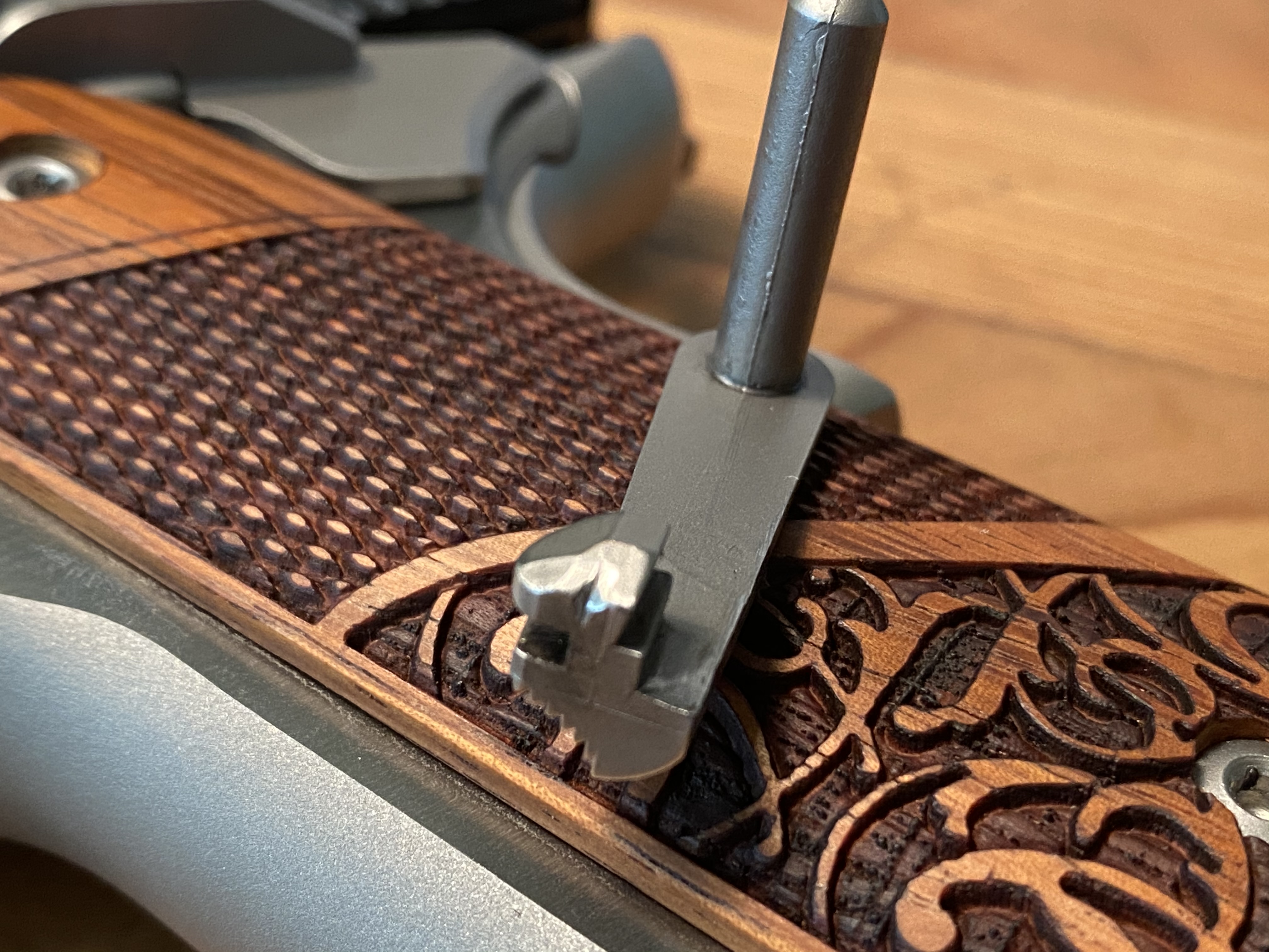

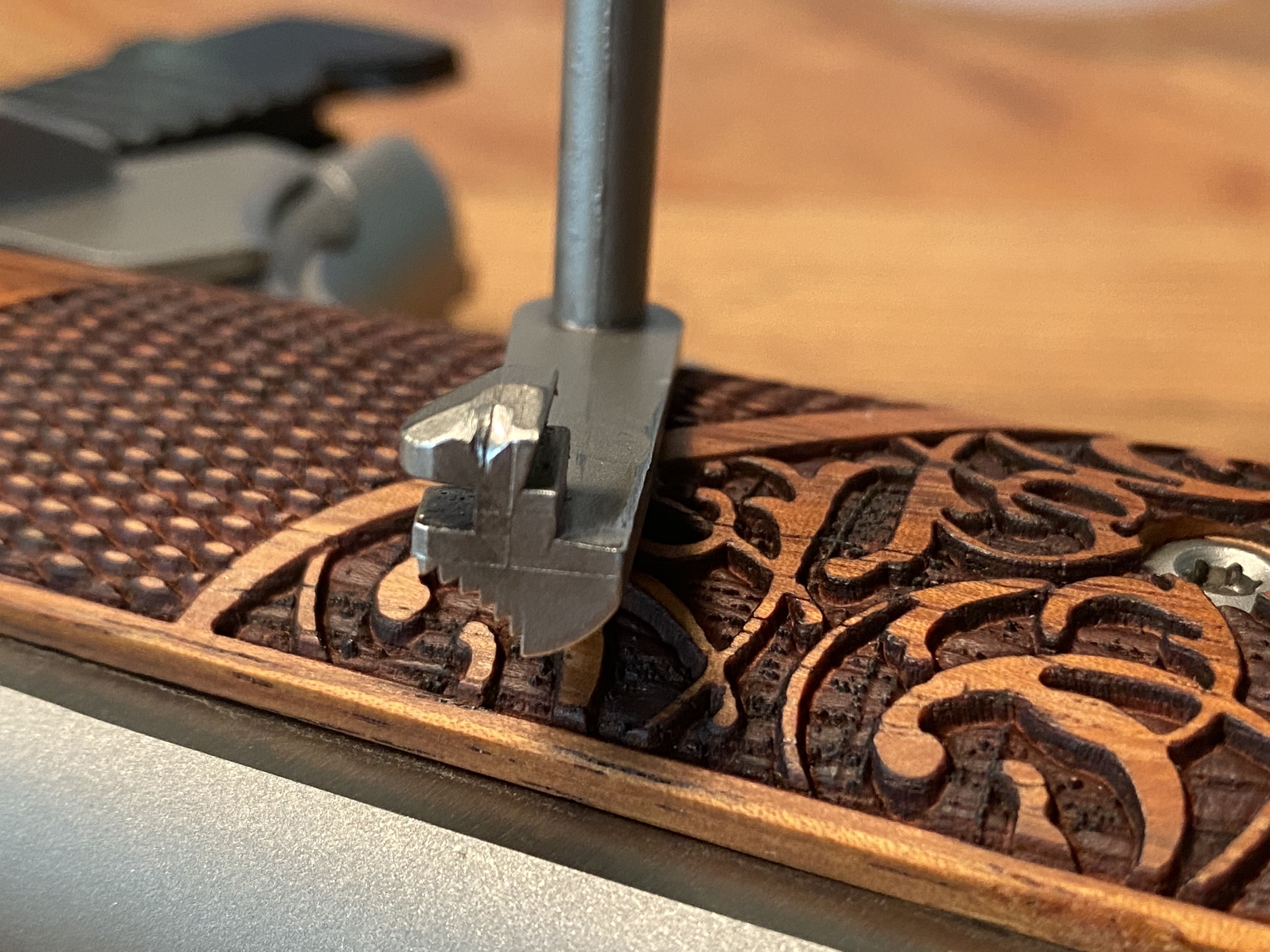

Panamax, here you go. It’s not the prettiest groove I’ve seen, but I have a tendency to goober things up the first time and then do it like a pro the second. I was trying to avoid that, so as soon as I tested it and it worked, I stopped. I literally just position the notch over the plunger and moderately push down and it goes right in. I bought the pack of needle files from Lowe’s. I already had a large set of needles files, but they weren’t quite “needle-y” enough. I would say this took me about an hour, YMMV, because I was nervous about messing it up and honestly you have to develop a rhythm with the files. It was difficult actually getting a groove started, but once I did, things went pretty quickly. I used a couple different files from the set - particularly the round “rat tail” file and the one that has a knife like blade with a fine edge. BTW, I did not use a vice to hold the lever, I did it by hand, which may, or may not, have made it harder. I hope these pics work for you, it’s not rocket science, you just have to take a deep breath and say a quick prayer!

Simon,
Excellent Response. I am convinced beyond any reasonable doubt now after looking at your pics, easily inserting a slide stop into a a Colt and studying the various bevel cuts under a magnifying glass that they and/or the plunger length are out of spec. I hope SA monitors these posts. I'm sure others will find this very helpful.
Thank you.
I decided to write the warranty department last night and described the issue in more detail. I asked if they might send another slide lock as opposed to having me send the gun back in. Also I got out a magnifying glass to see the bevel cuts on my Colt Gold Cup. That slide stop works as it should. Its bevel cuts are definitely different. I thought...why not switch them out and see if the guns will function. I was able to easily put the Colt's slide stop into the Springfield, but the slide would hang up or seem to get stuck. I found if I banged on or pushed on the slide stop it would release. So it seems the SA part will work in the Colt and pass a function check but not the other way around. Most curious. They do say the 1911s require some hand fitting and I guess this is an example of that. Comparing the two frames it was clear the SA was beefier all around and that's where the additonal 6 oz in weight must come from (35 oz vs 41 oz).
