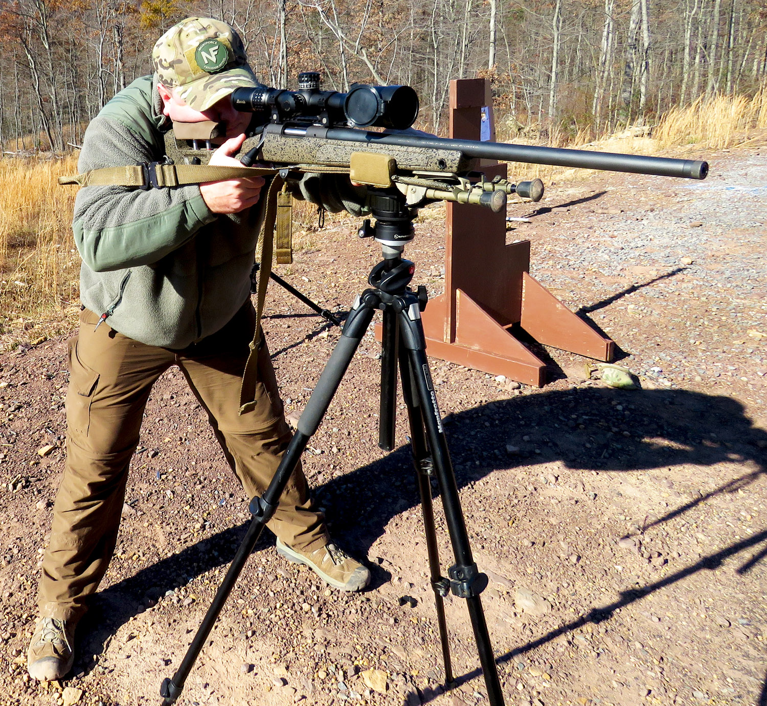

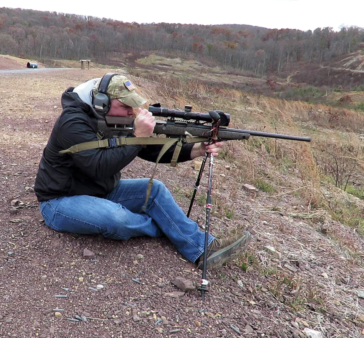

Wojcik Method
I first saw what came to be the Wojcik Method in an article by Caylen in one of the first Guns & Ammo Sniper magazines . What I like about this technique is that it’s simple and easy to adapt to multiple sling designs. Essentially, what you are going to do is pull the sling up as high as you can behind the tricep of your firing arm so that it runs from the rear sling swivel around your arm and to the front of the gun. Now, if your sling is adjustable, tighten it up so that you feel the sling pulling the rifle back into your shoulder, for some more tension you can also pull your elbow back if need be. Like I said, this method works across many different slings from precision rifle slings to hunting slings and works great off of tripods, shooting sticks, or even natural obstacles like logs or boulders.
Hunting Slings
Just because most hunting slings are simple carrying straps doesn’t meant that they can’t be used as shooting aids in a pinch. You can easily use the Wojcik technique with a properly adjusted hunting sling or even the trusty hasty sling technique. If you are going to use a hunting sling as a shooting aid my word of advice is to practice with your rifle beforehand so that you know where the sling is adjusted properly and you are used to getting into the position quickly. There’s no metric for what the proper adjustment length is going to be since that is going to vary person to person.

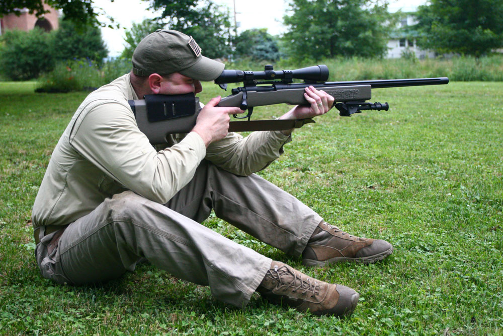

Sitting
I can't do the traditional Indian-style sitting position with a rifle so I use two variations: A spread legs sitting and a crossed ankles sitting position.
I use crossed ankles if I'm shooting across a relatively flat piece of terrain. I can make small elevation changes by bringing my feet in or pushing them out some. Notice that my support arm elbow is forward of my knee, my right elbow is more or less in the crook of my right knee.
In steeper terrain I'll use an open legs sitting position because it allows me more flexibility in making elevation changes, while still being stable.

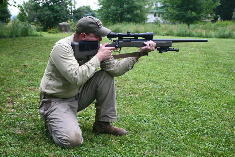

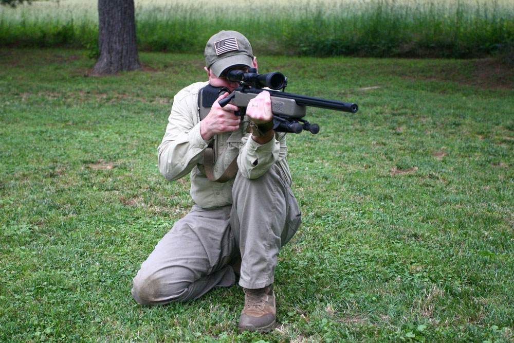

Traditional Kneeling
