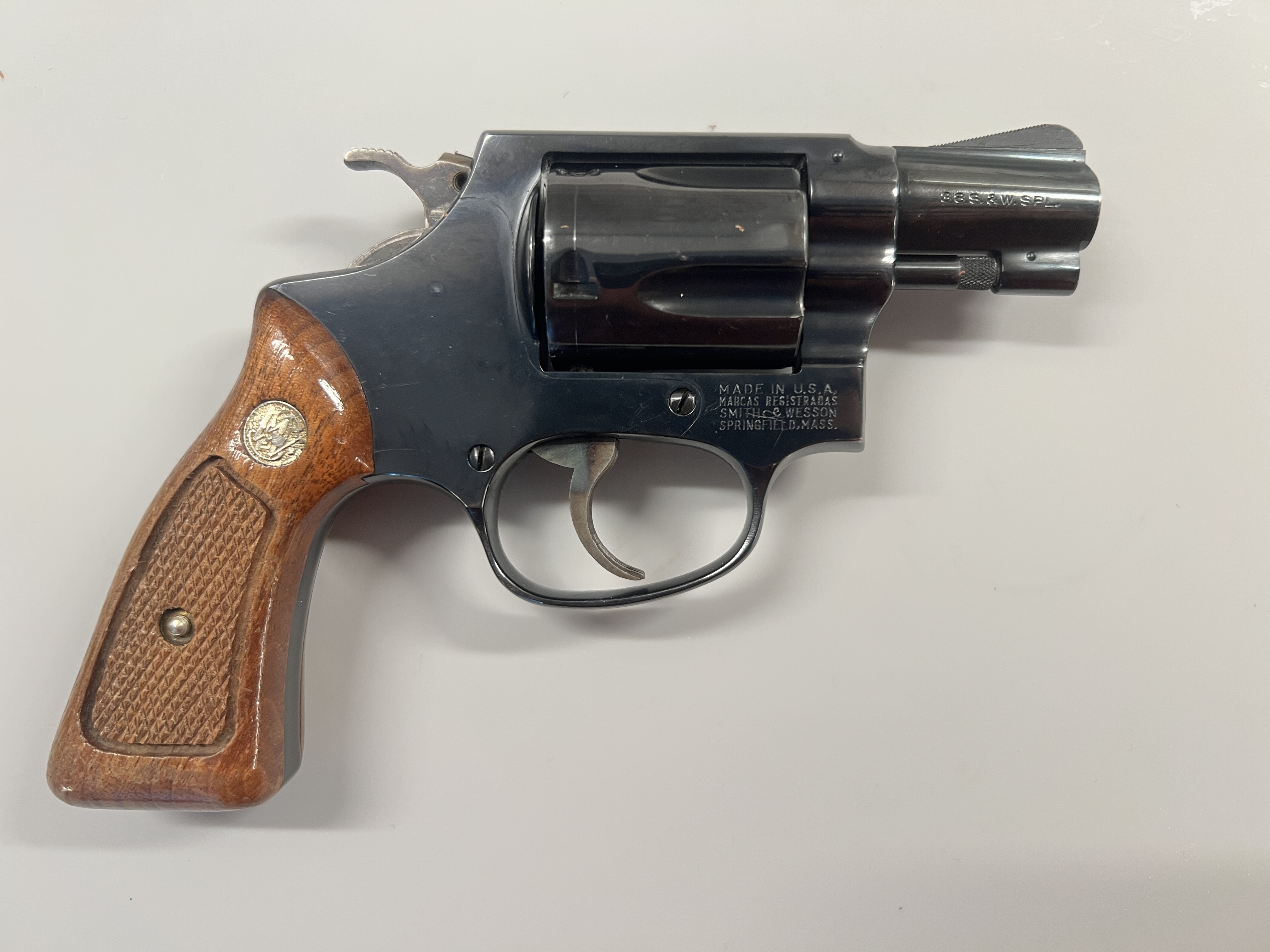

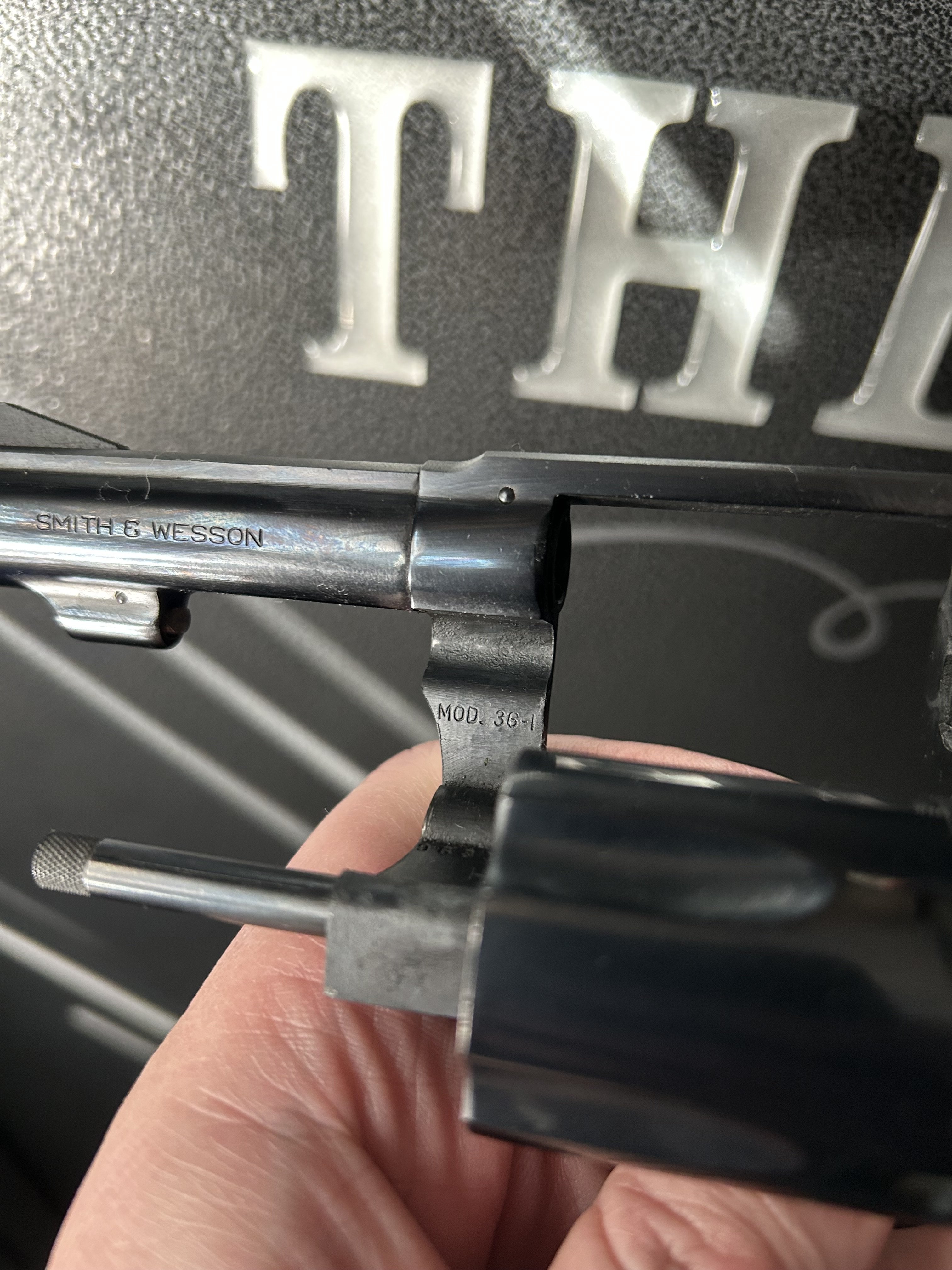

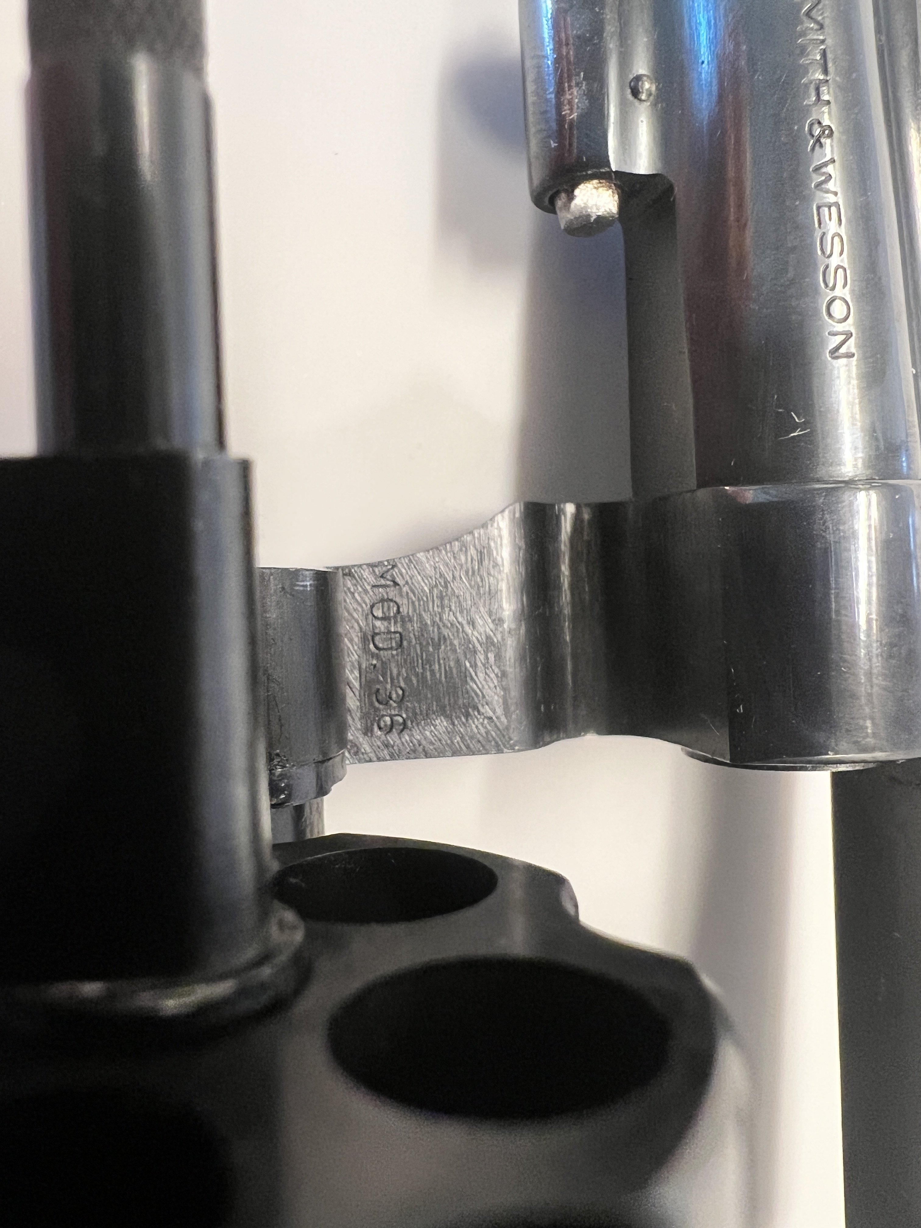

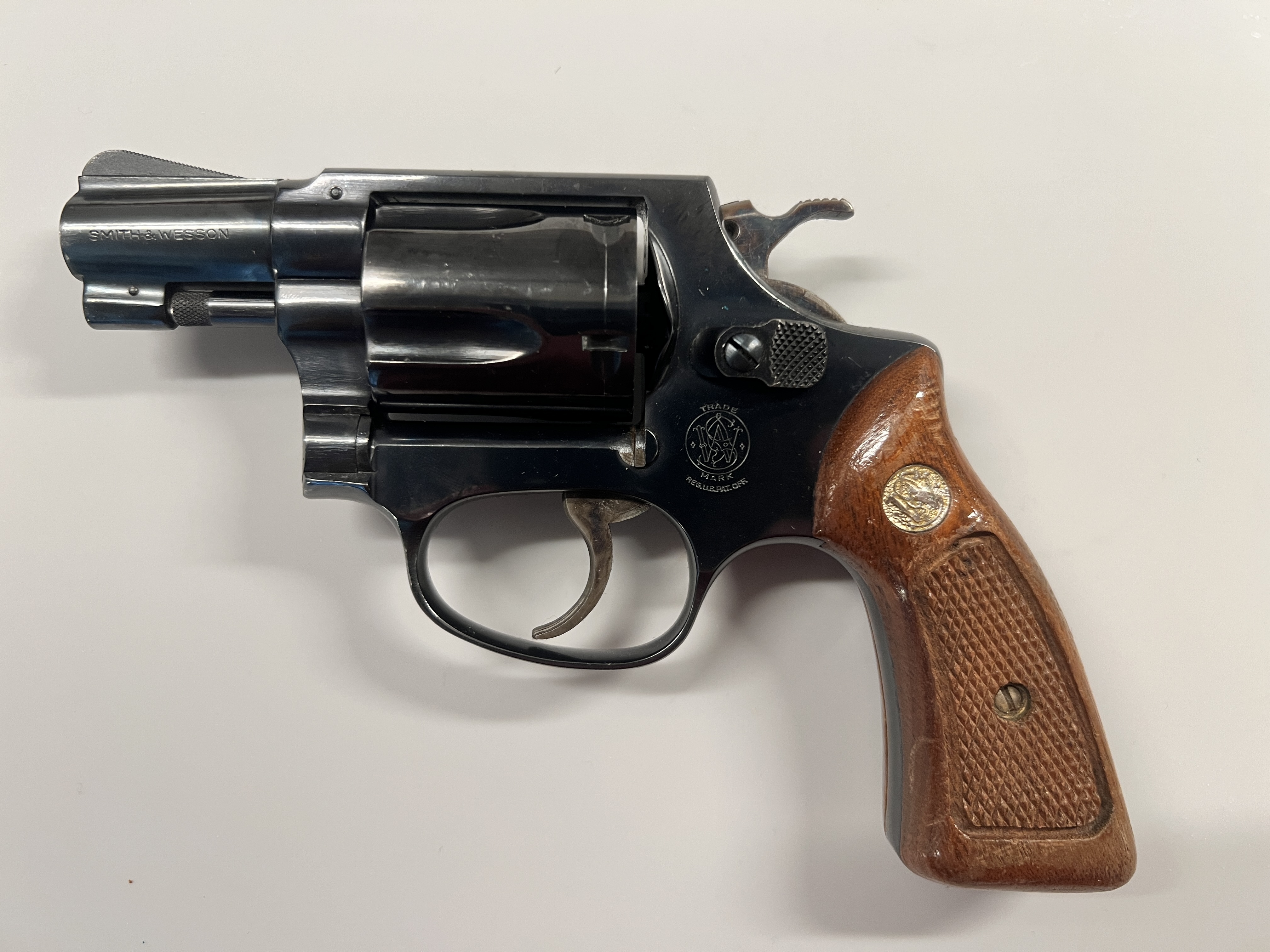

I received this in my father’s estate several years ago. Any idea on approx age and can it handle todays plus p loads like Federal 120g Punch, Federal 129g Hydro Shock?
38 Special
5 round cylinder.
Serial number starts J-2-2-*-*-*-*
Thanks

Occasional use would be just fine, as well as carrying for defense. Elmer Keith tested one of the first J-frames (pre-Model 36, early 1950’s manufacturing) with his .38/44 Heavy Duty (think: light .357 Magnum level power—a 158gr bullet at around 1200fps) handloads and found it dealt with them just fine.
I have +P loads in the 36-1 pictured.

My agency in the 70's carried a Model 36 3" heavy barrel. Working protection operations we shot them a lot in training with military ball. After about 3000-5000 rounds they were shaving lead from wear from the high pressure rounds and the frames were stressed. Based on that experience I would't shoot a regular diet of +P, but also wouldn't hesitate to carry it with +P. These guns were made before there was a +P so smith never anticipated those pressures. S&W 'S position is going to be don't use +P in it.
This. Regular .38’s and a J will last a long time. Stoke it with plus P’s if you must for carry, but don’t make a habit of shooting ‘em
