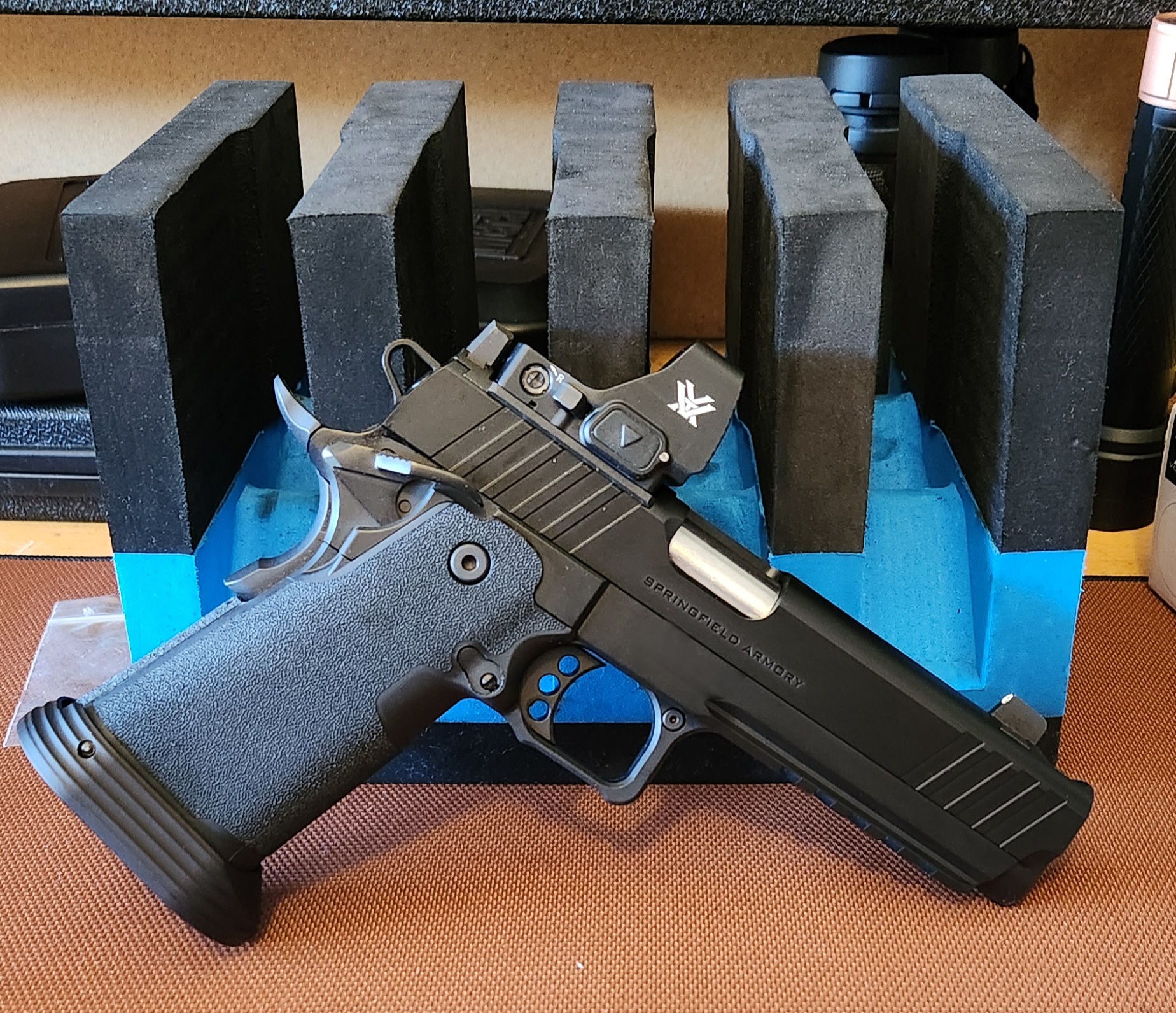

Received the Brand new 5" Prodigy comp today. Cleaned and lubed, installed dot and magwell. Will get to range in the next day or so. I will post range results when I have them.

New Prodigy comp shot beautifully yesterday afternoon. 200 rounds of 124g fmj without a hitch. No pics due to a lot of that was basic shake down, zero RDS etc...
I went to range this morning for my usual Staccato session with XL but brought the Prodigy along for a few more Break in rounds. 125 more rounds through Prodigy, gun is very accurate and a great shooter. Never had a port / comp gun before, it is a different but very pleasant shoot.
I left the range very satisfied, got home and then I began to clean Prodigy. It was then that I noticed the slightest movement where the dovetail of plate mates with the slide.
The guns is awesome and I plan on keeping it, but I cannot be the only one constantly having this issue with the
AOS plate.
SA's RMA report on previous Prodigy that they replaced with this one said hammer follow issue was caused by grip screws being backed out so far that it allowed sear spring to disengage causing hammer follow issue. Also said I need to check plate screw tightness more often. I own $8000.00 worth of 1911's / 2011's I would notice a little thing like a grip separating from frame. Lol
If they are suggesting that I remove Dot every 200 rounds to see if plate screws are tight they crazy. I have over 3000 round thru Staccato in a little over a month and the plate is like it was welded to slide.
I am standing by my original praise of SA customer service, They have gone above and beyond the norm to resolve this situation.
This is an obvious flaw in the AOS design. I see that Dawson Precision offers a plate but it still uses the original screws supplied with AOS. Not much faith in that deal for $129.00.
. I hate it because this gun is the CAT'S MEOW if the damn plate would stay put.
Any input is much appreciated. PEACE

Hey SL66 as you know I had problems with the AOS plate on my 1911 AOS pistol. I got screws from Trijicon to mount their SRO on the AOS plate. Turns out the screws were several thousands too long were bottoming out before reaching the correct torque value. I then used 6-32 X 3/8" added loctite and torqued them to 15 inch pounds. Went to the range this past Tuesday shot a little over a hundred rounds screws stayed tight. Can't say for sure but maybe this will work for you on the Prodigy.
Referring to the plate to slide screws think they 7-40's don't remember their length but pretty short. Think SA suggested 20-22 inch pounds on those. I went to about 30 inch pounds and after around 300 rounds they're still tight.
Appreciate the Input, I pulled extractor and screw was protruding a tiny bit in to channel. No scar markings on extractor. I am not giving up on pistol, it is a Bad Mofo for sure.
