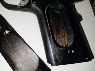

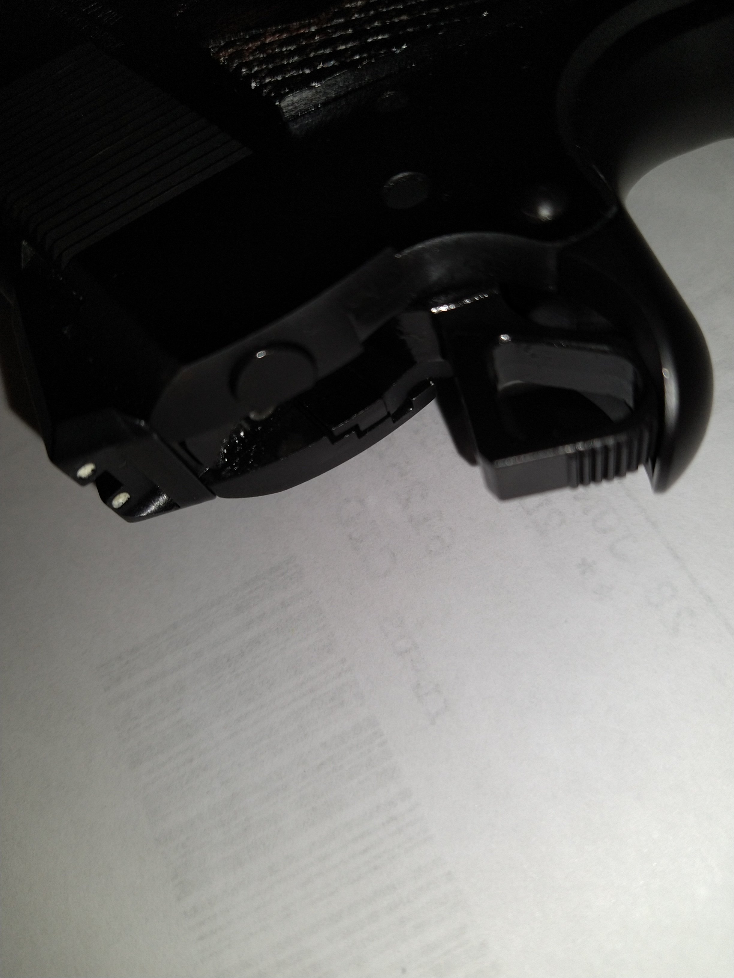

I own a blued Garrison 1911 that is 1 year old and never carried. The bluing had developed surface rust that I very gently used a soft oiled cloth to remove the rust and the bluing came off all the way to bare steel. The rear of my slide also overhangs the rear of the frame. The mag release button is hard to press and sometimes gets stuck in the release position. I haven't shot even a complete mag through this gun yet. Are these issues typical or acceptable for a made in USA Springfield Armory 1911?

No, the Garrison is made here in the USA, the SA-35 has frame and slide made outside of US. The rust is pretty much normal if you don’t remove the grips occasionally and lightly oil under them. The overhang you’re referring to isn’t all that much, I have seen worse, it won’t affect the function at all. As for the mag release, it just needs broke in, my Kimber Custom Duel Tone in 9mm has a rear stiff mag release, shouldn’t be an issue, if it does just call Springfield up, they will take care of it.

And as for the rust under the grips, this is common occurrence on any 1911, usually due to no oil under them and sweaty hands, also the grip screws on a 1911 is also common. On mine, after any range time, when I clean the gun I always clean under the grips, and occasionally I remove them to lightly oil under them, even on stainless 1911’s, they to will rust.
They initially told me that slide fitment was within tolerance. Heirloom quality construction tolerance? I wouldn't do a piece of work and call it finished without the slide and frame fitting flush. If for some odd reason a finger knuckle were contacted with the back of that slide, in battery, it would cut my knuckle. I have tried many Philippines manufactured 1911s and each one of the 8 or 9 I have owned in the past were fit / finished better. Trouble was none of them would run reliably with most jhp. I have been carrying various XD, XDM, and XDM Elites since 2005. I know; they're made in Croatia and are a different gun. I believe some 1911s function as they should and because I have always had great operating experience with Springfield Armory XD, XDM, and XDM Elite guns, I hope I have a similarly good experience with the Springfield Armory 1911. My gun is back at Springfield Armory and I will learn during the next few weeks how they handle these issues. There is noooooooooo way a hot salt dipped bluing job (done properly and at correct temp) will be less durable than a tedious week long cold blue job done at home by me on my revolvers. The Garrison 1911 was stored wet with gun oil. Under the grips, there was more oil in some places than others. The mag release requires me to contort my hand so much in order to put enough thumb pressure on the button to drop a mag and, about 2 out of ten times it gets stuck open. I have sat in our living room many nights pushing and releasing that mag release hundreds of times. Then, I'll pick up one of my XDM Elites and ohhhhhh do those guns run smooth. I pray they'll fix up my Garrison 1911 properly.

I suspect you will get your Garrison back in the same condition you sent it to them in. Your options will be to take it to a smith or sell it. As for the finish your options will be to re-blue it or live with it.
If the "bluing" came off to bare steel with a oiled rag then instead of "bluing" it could have been a powder-coating finish which wasn't applied very well.
