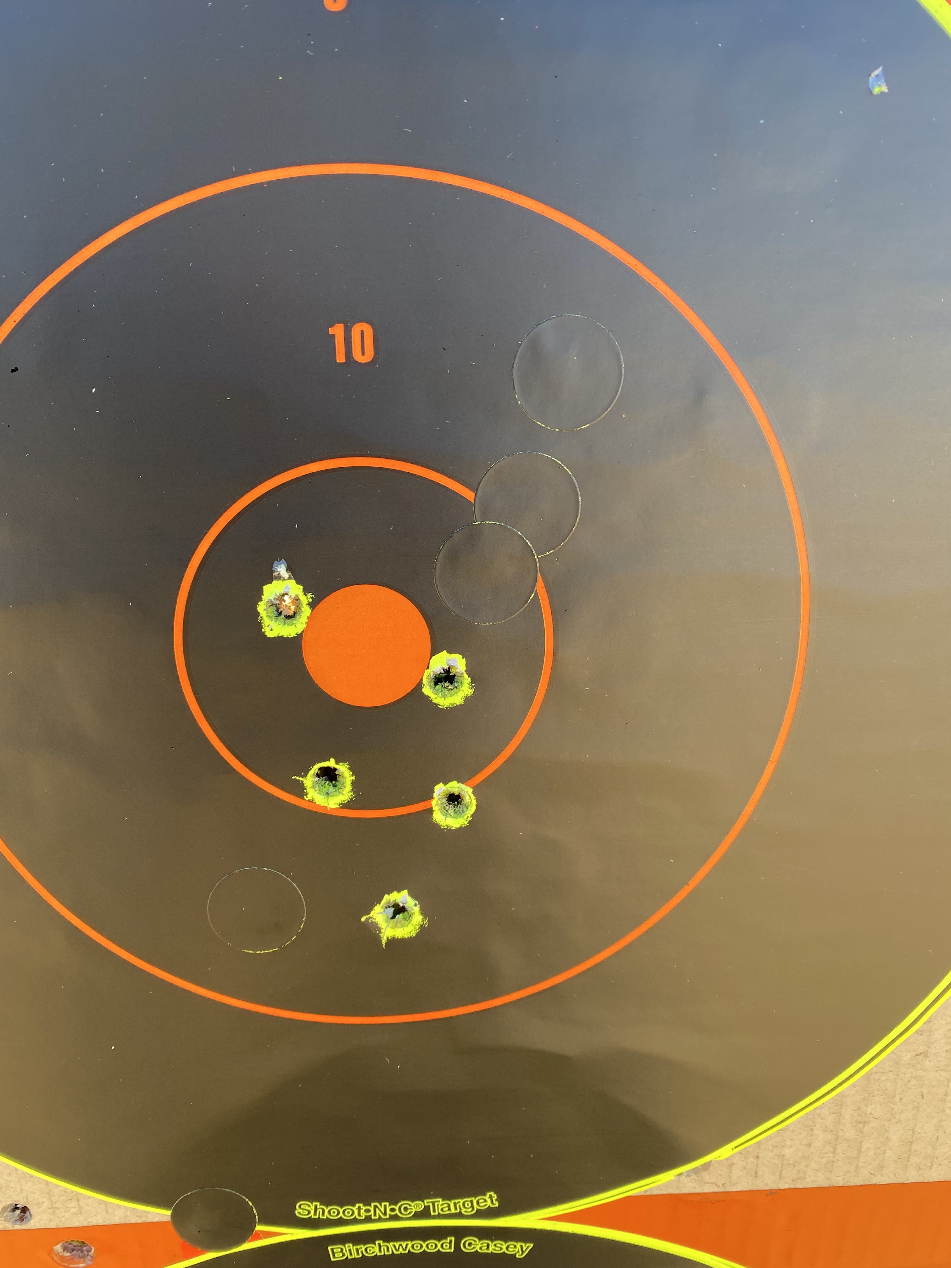

I took my M1A to the range this morning to sight in my new Sig Sauer BDX Scope. 6 rounds at 100 yards and I had it dialed in 9 rounds for fun then I took it out to 200 yards for my last 5 rounds.
Not to bad for a half blind old guy. 😎

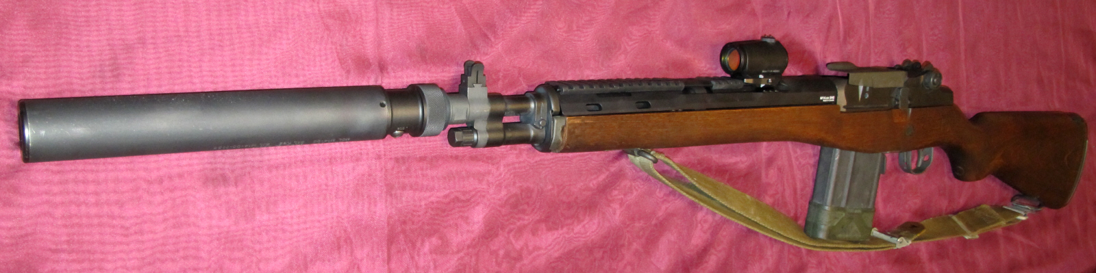

I have been shooting the M1A/M14 suppressed since 2006, and I have used nothing but suppressor kit from Smith Enterprise. I chose SEI because they have been building military M14s for suppressor use for years. Gas & debris are blown back at the shooter... I use the M3 Breech shield to deflect the blow back away from my face, and I use an extra volume gas plug that is NOT adjustable. (The gas system on the M1A/M14 is self adjusting).
I enjoy shooting my M14s suppressed.
