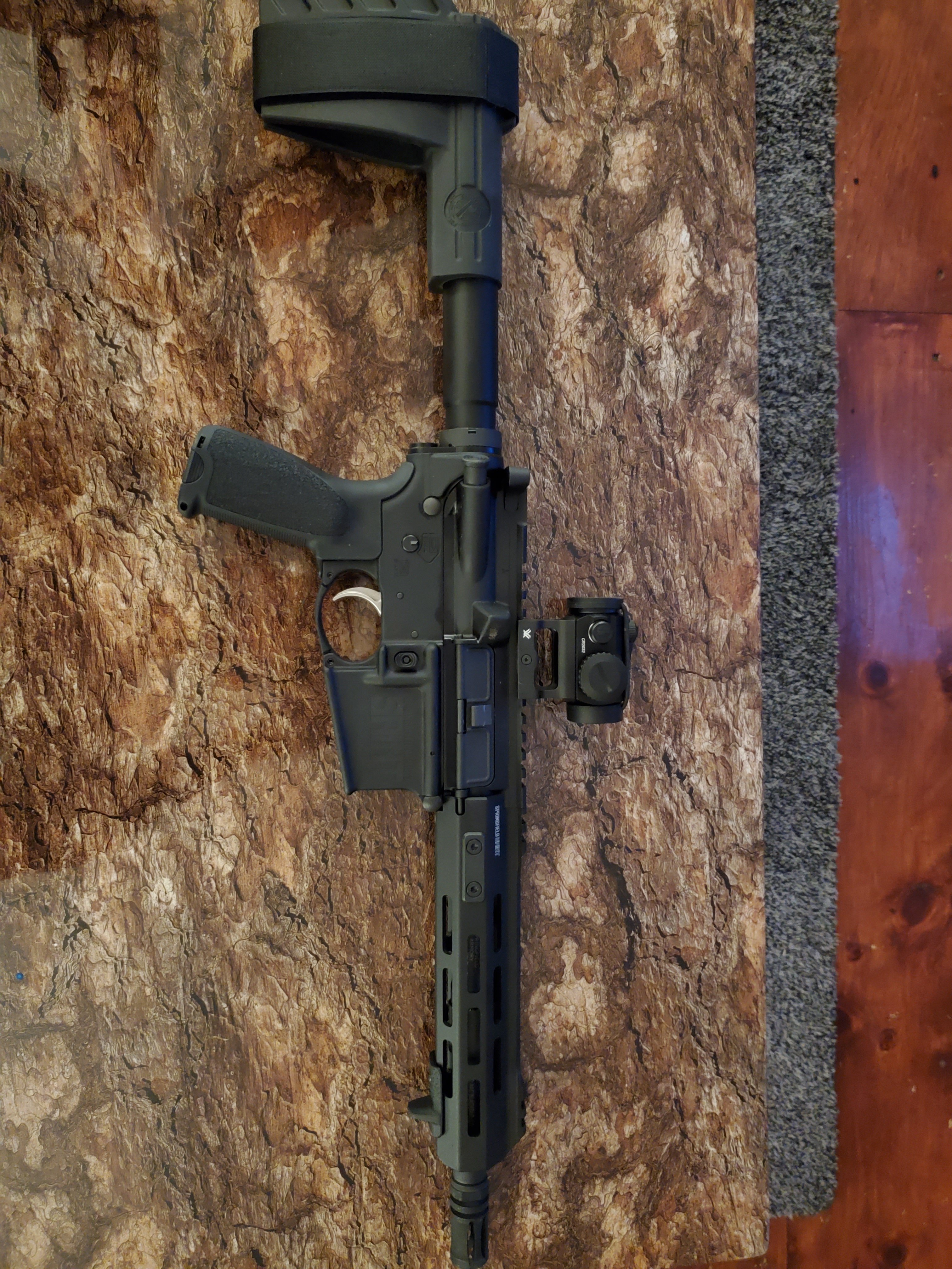

I don't have pics of the casings today I was shooting elsewhere but they do have the casings and ill be there tomorrow so I can show you then. I can also send a picture real fast of my gun because I'm rather new to this so idk anything about the gas system stuff.

Just looked online. Says its a "pinned gasblock"

Ok that’s a Saint Victor I believe with an adjustable gas block. Have you pulled it apart to clean and check your pressure tube and how it mates up with your BCG?
