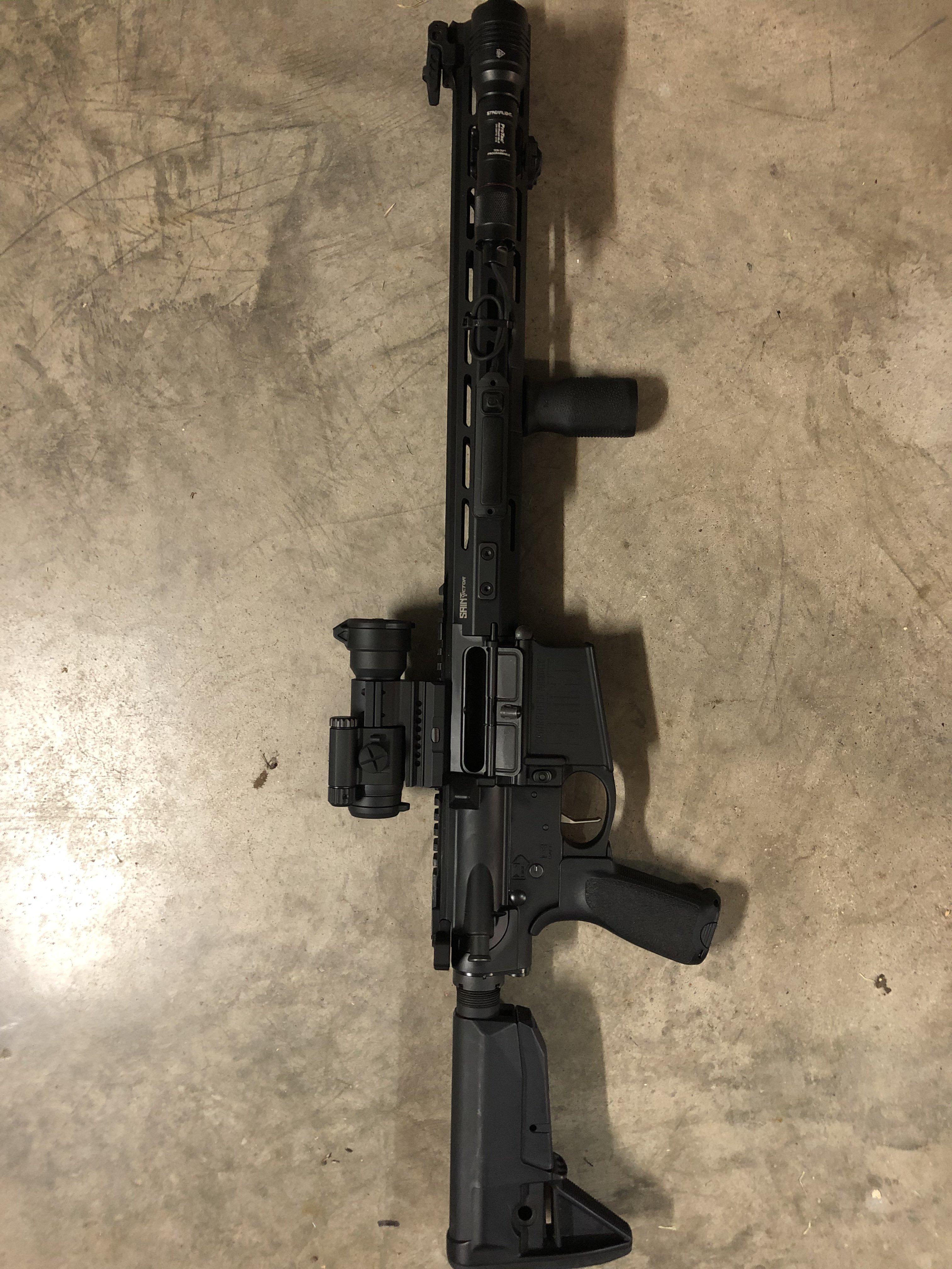

Forum member @Mr.Brooklyn asks the following in his profile post:
"Has anyone else been having problems with the Springfield Saint Victor 300 Blackout jamming? I just purchased this firearm brand new and immediately I began having these issues my first time shooting it."
I decided to post his question as a forum thread (I hope you don't mind Mr.Brooklyn), as I just also recently purchased the Saint Victor 300BO pistol (haven't taking it to the range yet), and I am now also curious if others have experienced problems. I know @Keystone19250 also had the 300BO Saint Victor before selling it. Has anyone else with the 300 Saint Victor experienced these issues? Could it be needing a gas block adjustment even though not running with a suppressor (at least in my case, yet). Any (and all), help appreciated, asking for a friend ;).

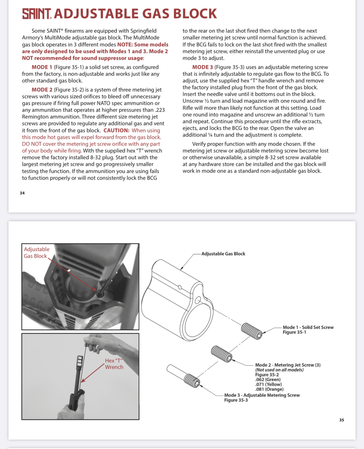

From the manual: here ya go !!!
easy peasy !!

In looking through my Pistol accessories, looks like I got the "Adjustable Metering Screw" and should/could follow the Mode 3 directions. Mode 2 color Metering Jet Screws appear to be for Victor (& other ), models that firer at higher pressures than .223 (such as full NATO spec ammo (like 5.56)), and I'm guessing that's why I didn't get them with the 300BO, for the Mode 2 option.
