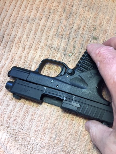

I love 45ACP and enjoy reloading. I have owned the S/A XDS for five years now and put thousands of factory and reloads down range during that time without a single failure or malfunction. On Jun 20, 2020 a squib load snook up on me and presented me evidence of the great engineering and manufacturing genius of Springfield Armory. The squib load, or I should say the one that followed it, took my XDS out for sure. The results, one destroyed weapon but no injuries. Keep your head on a swivel at the range, things can happen fast. This could have been catastrophic, but the results were much better than one could anticipate. Photos attached

Good point, I am going to reach out to S/A to determine if the damage is too great, but a solid option.
Thanks for sharing. Curious on ammo, if factory would like a lot # and manufacture.
It was not factory ammo, this was a disaster of my own making. Just glad the weapon was well engineered and manufactured to cancel out some mistakes people make, including me. I did not pick up on the squib load and thought the following shot just did not load correctly. A quick tap and the breech locked and the disaster happened. Speed drills can sometimes desensitize you to squibs and misfires.
