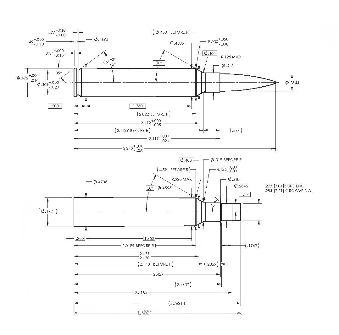

7mm Backcountry Cartridge Specs
  • Overall Loaded Length: 3.34 inches
  • Bolt Face: .472 inches
  • Case Length: 2.417 inches
  • Shoulder Angle: 30 degrees
  • Bullet Diameter: .284 inches (7mm)
  • Throat Diameter: .2846 inches (.0006 inches over bullet diameter)
  • Recommended Twist: 1:8
  • Max Chamber Pressure: 80,000 psi
So it's a higher pressure 7prc w/ smaller body and tab longer case length (2.417 cs 2.260).
Now another 277fury wannabe.
Says you can reload case, but rumors state dies won't resize properly? Maybe to much spring back?I'll stay away from reloading the 277fury and the 7backcountry. Getting all brass case and staying below 65k, then I'd reload.
The .277 Fury has both all brass and hybrid cases.
