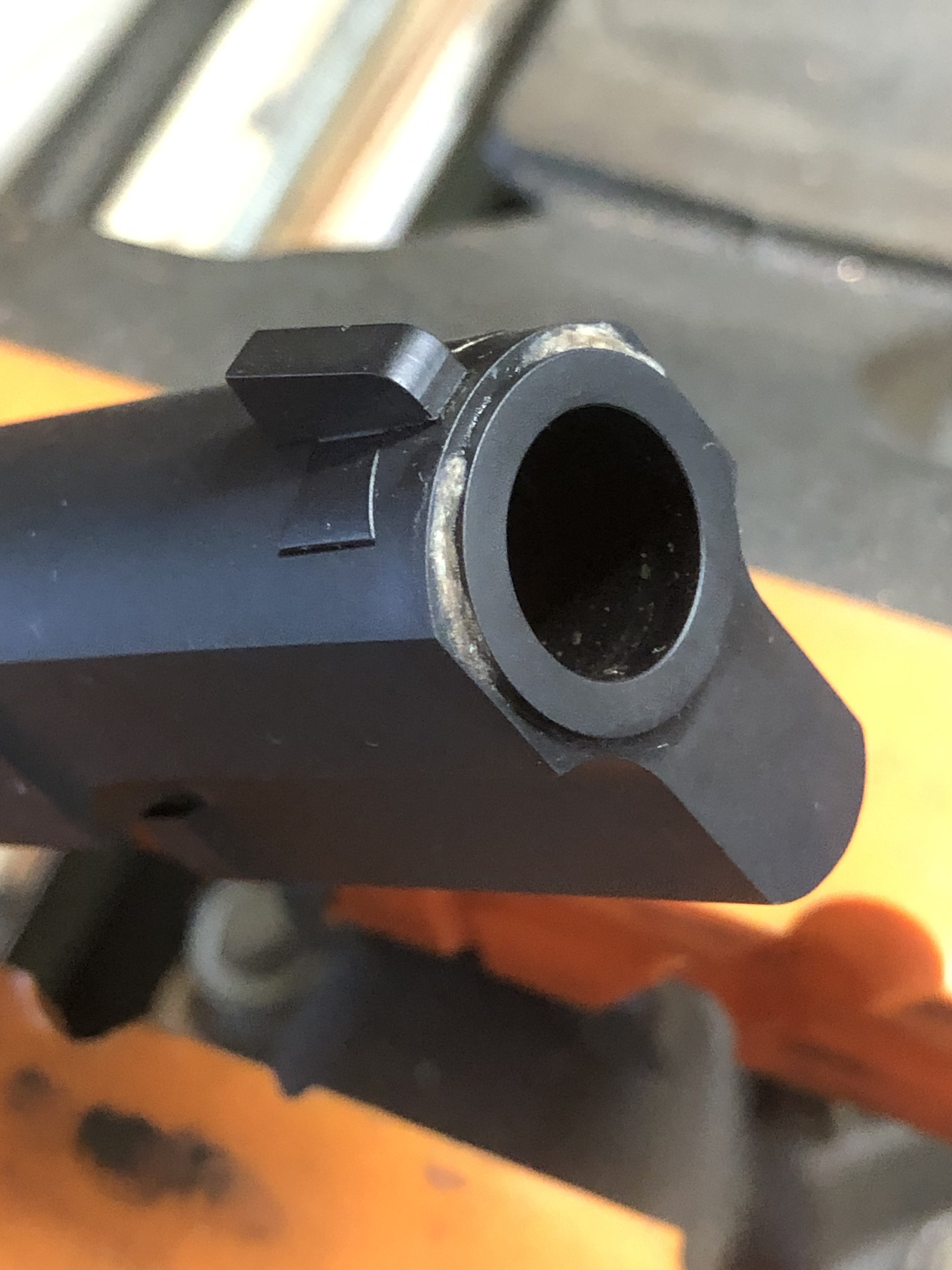

Its been a while since I had the SA-35 to the range due to a surgery. I ordered a set of XS sights for it so I got it out of the safe to get it ready. On the end of the barrel was this white corrosive looking stuff. I cleaned the powdery stuff off with Hoppes. I assume it is some sort of adhesive that Springfield used to adhere the barrel bushing since it in non-removable. Anyone seen anything like this before?
I doubt an adhesive was used as a means to hold the bushing in.
It looks like some kinda grease or maybe carbon deposits. I get grayish white powdery carbon residue sometimes on muzzle devices when shooting suppressed.

With the original FN/Browning soldering was the way the bushings were designed to be put together, but others took short-cuts by using Lok-Tite.

Thanks for the info all. I removed the hardened material from the face of the slide with a stiff nylon tipped screw driver. It seemed to chip away and then used Goof off to clean the residual with no effect on the blueing. I received the XS sights today so its time to get the front sight off and see what is underneath that needs cleaned
