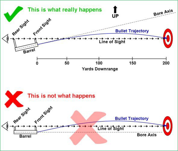

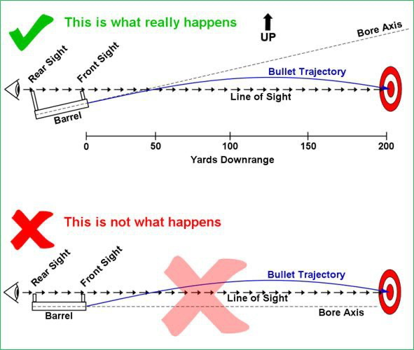

...In order to do this, the barrel is pointed upward (by adjusting the sights) at the POA slightly so the bullet hits the POA at the desired distance.
The bullet doesn't "rise" - it's falling as soon as it exits the barrel. It's the angular difference between the sight axis and the bore axis that, depending on the zero, makes the bullet cross the sight axis twice:
With a 5.56Nato round, when the POA/POI match at 25 meters, that round's ballistics make the bullet rising to meet the POA at 25 meters....it continues upward and will hit an inch above the target point at 50 meters, 2" high at 100 meters, then starts dropping back to the same height at about 300 meters. This has been proven at these distances (25/300 zero) with Nato ammo for decades, with the GI spec sights on an AR rifle (or M16). The above are estimates for the 50 and 100 meters POI's, but I've heard they are close.

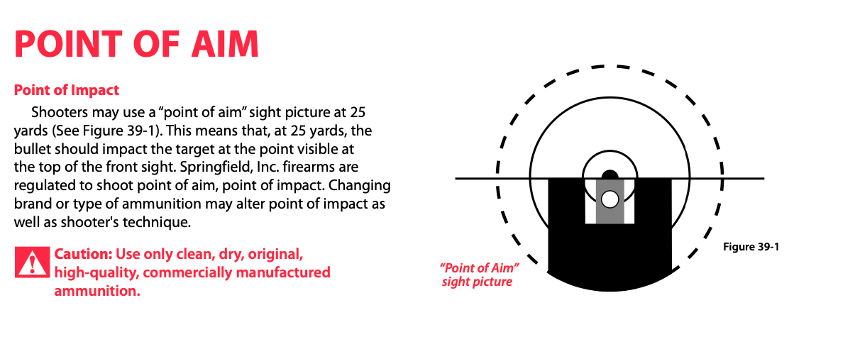

Night Fission's website only states that their standard sights will regulate to what the handgun manufacturer regulates to. For the XDm, for example, we see the following:
^ Image taken from XDMAN.com 's gracious hosting of the current and past XD Owners Manuals.
Note that the distance cited is 25 yards - but it doesn't mention bullet weight (length) or load specifics. This is because for the vast majority of shooters who would use this particular handgun, pulling a sub-3-inch group (i.e. tight enough to be able to be zero'ed from) at that distance is going to be much more about shooter skill than it is about the cartridge's nuances. ;) This is ostensibly why Dawson Precision (more in a minute) asks shooters to zero at the 20 yard line...because most shooters fall apart rather fast as they start to really push yardage.

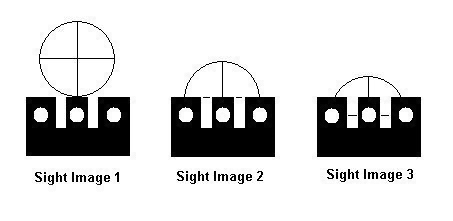

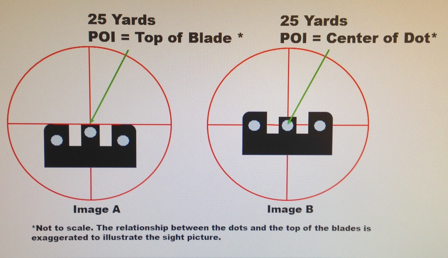

[ Towards this, modern defensive/duty-caliber handguns -from full-size to sub-compacts- zero'ed at the 25 will be able to engage "POA/POI" easily from 3 (think the late TLG's version of Dot Torture) to 100 yards (not uncommonly pushed yardage in "walk-back" drills or contests). ]
Similarly, you'll notice that instead of just using language, SA's technical writers shows a visual. This is important because language often gets in our way when we talk about the zero:
* Image stolen from all over the Interwebz.
^ ....in which both "Sight Image 1" and "Sight Image 2" are both often referred to by various shooters as "6-o'clock hold," and both "Sight Image 2" and "Sight Image 3" could be called "POA/POI." Because of the imprecision (sorry, no pun intended! :p ) of language, a picture here literally says a thousand words, and tends to get folks' thinking aligned much more quickly.

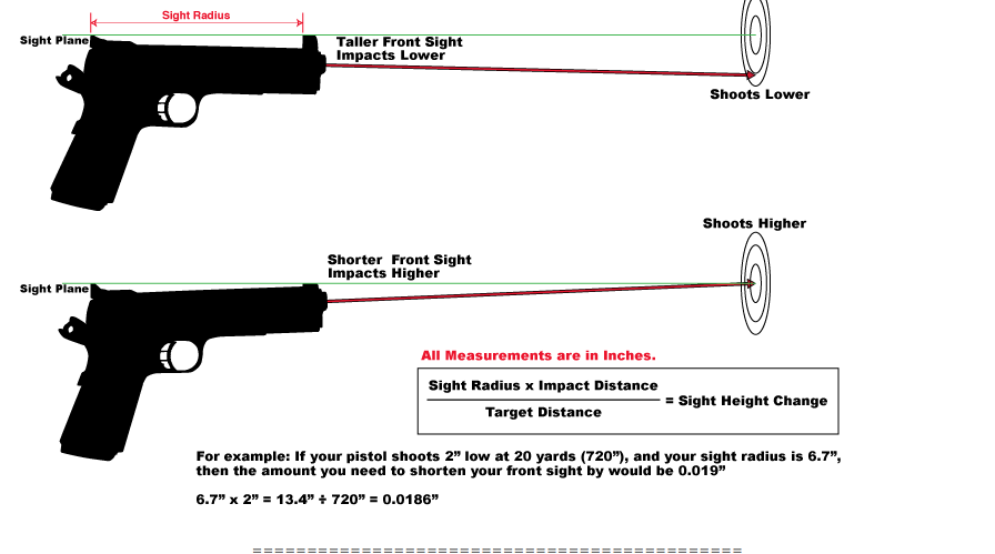

Dawson Precision, whose sights are very highly regarded in the handgun world, gives good insight into this matter with their "Perfect Impact Policy" -

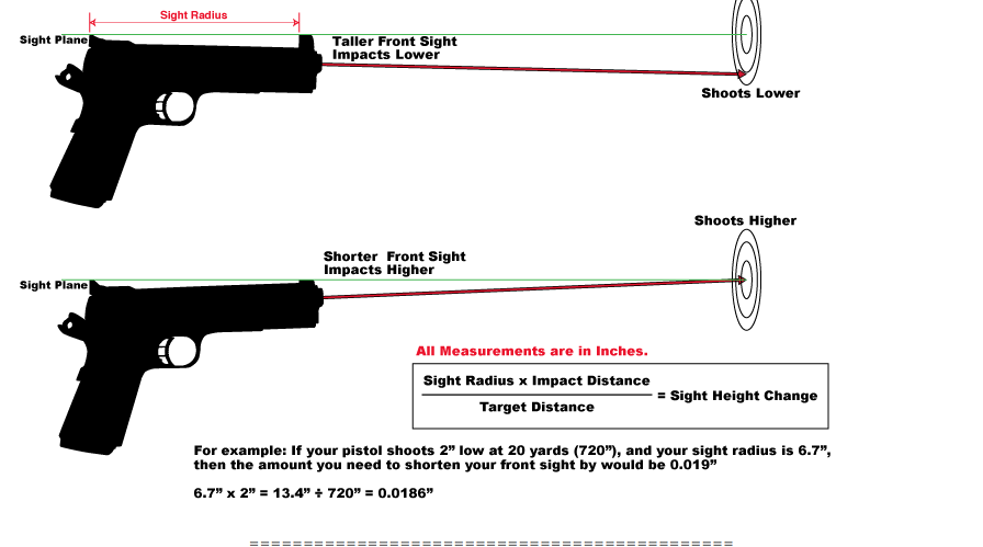

....and their online, interactive, sight height calculator:
As you see from the Dawson sight height calculator, typically, altering sight body dimensions to raise/lower to either correct or refine POA/POI is done by changing the height ratio between the front post and the rear notches. Here's another, possibly more intuitive view of what's going on within the calculator -
* Image taken from 1911Addicts, but it's again all over the Errornets!

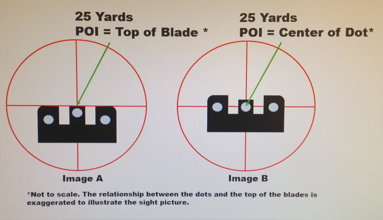

And the question becomes even more muddled when folks aim by "aligning the dots," versus the actual sight bodies:
* Picture taken from ARFCOM thread - https://www.ar15.com/forums/Handgun...nt-sights/13-186208/?page=1&anc=bottom#bottom
^ Here, note the discrepancy between sight blade alignment and dot alignment.

TSI, you are absolutely correct in saying a bullet does not rise aerodynamically. However, when the barrel is angled upward, that bullet rises to its apogee, then starts falling back. I was being intentionally literal for the point of the description. Point well corrected. One might describe a bullet shot from a firearm and compare to one dropped simultaneously with the firing. If the barrel is parallel to the ground at firing, the fired bullet and the one dropped from your hand (from the same height) should hit the ground at the same time...
A fantastic real-life illustration of bullet trajectories is Hickok45 shooting a .45 auto at his gong at 80 yards, with John (his son) filming and zooming in on the gong. You can see the bullet arcing to the gong before hitting. It is quite striking how sharply the bullet falls from its trajectory. In my example above, I believe I over-estimated the 9mm arc mentioned. It might hit zero at 25 meters (with elevated sights) and re-cross the POA plane at 75-100 yards. Those slow bullets drop fast!
^ Ah, I see what you mean. ;)
I just didn't want less sophisticated readers to imagine that the bullet is somehow defying gravity after it leaves the barrel.
