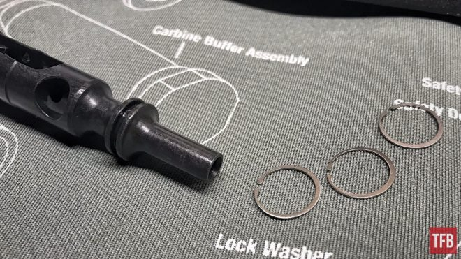

Great article Talyn, every time I do an
in-depth cleaning including a BCG disassembly I make sure those 3 gas rings are spaced correctly.
It’s great to know the process for replacement including the test to see if the need to be changed.
An easy way to tell if the gas rings need replacement is to remove the BCG from the upper then extend the bolt fully and stand the BCG on the bolt end on a flat surface and if it collapses under its own weight the rings are too worn and need replacement.

First and foremost, even at this late date and with our ever expanding hobbyist understanding of the AR15 platform, this article continues to propagate the myth of gas-ring alignment (@Keystone19250 , I hope the following helps! :) ). Both the late William Larson (iraqgunz on M4Carbine.net and the man behind Semper Paratus Arms) as well as SOTAR's Chad Albrecht have repeatedly tried to point out the fallacy behind this claim.
Similarly, as @Jfal noted above, the Brownell's Smythbusters series featured the following:
In 2010, M4Carbine.net member P2000 also made a video in which he aligned the rings and proved that the gun still functioned as-intended, and while this video is I believe no longer available, there have been many others in its wake. And although the video link is no longer valid in this old thread - https://www.m4carbine.net/showthrea...o-which-disproves-the-gas-ring-alignment-myth - you'll see that among the other members who attest to the fact that alignment is a non-issue is no other than Jack Leuba (aka Failure2Stop), who, aside from his military background, is also the Sales Director at Knight's Armament.

A lot of good points and more videos that I’ll work my way through but in reality everyone has their opinions on everything and I respect that.
My take on @Talyn article is it was basic instruction on one component that needs to be monitored. Is it critical that the three gas rings remain spaced out and don’t “ever” become aligned up? Probably not and I’m not saying I’m anal about making sure they stay spaced out but it works for me and I enjoy making sure I’m doing what I feel is the right thing. My current AR runs like a beast so I figure I’m doing something right.
