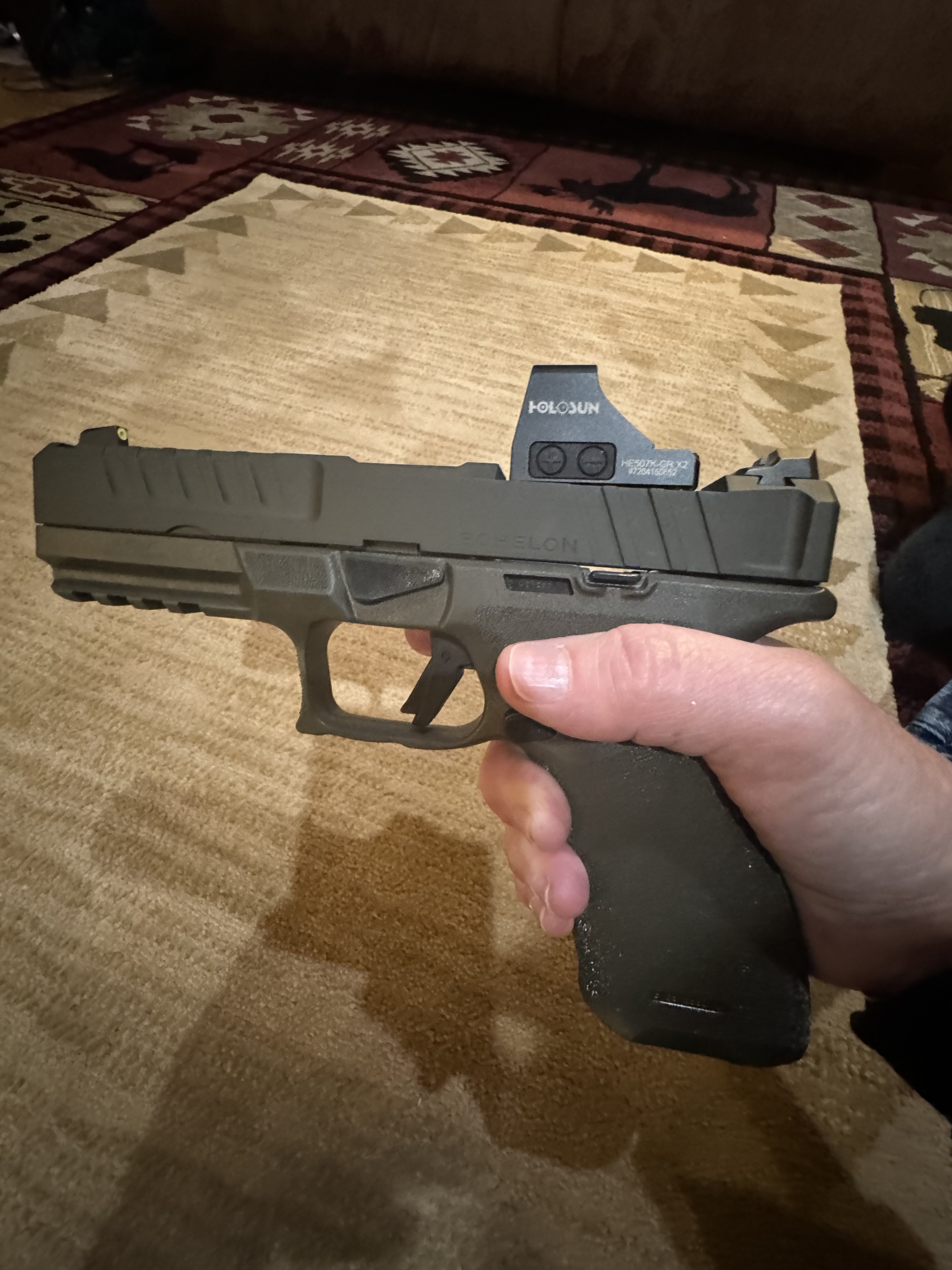

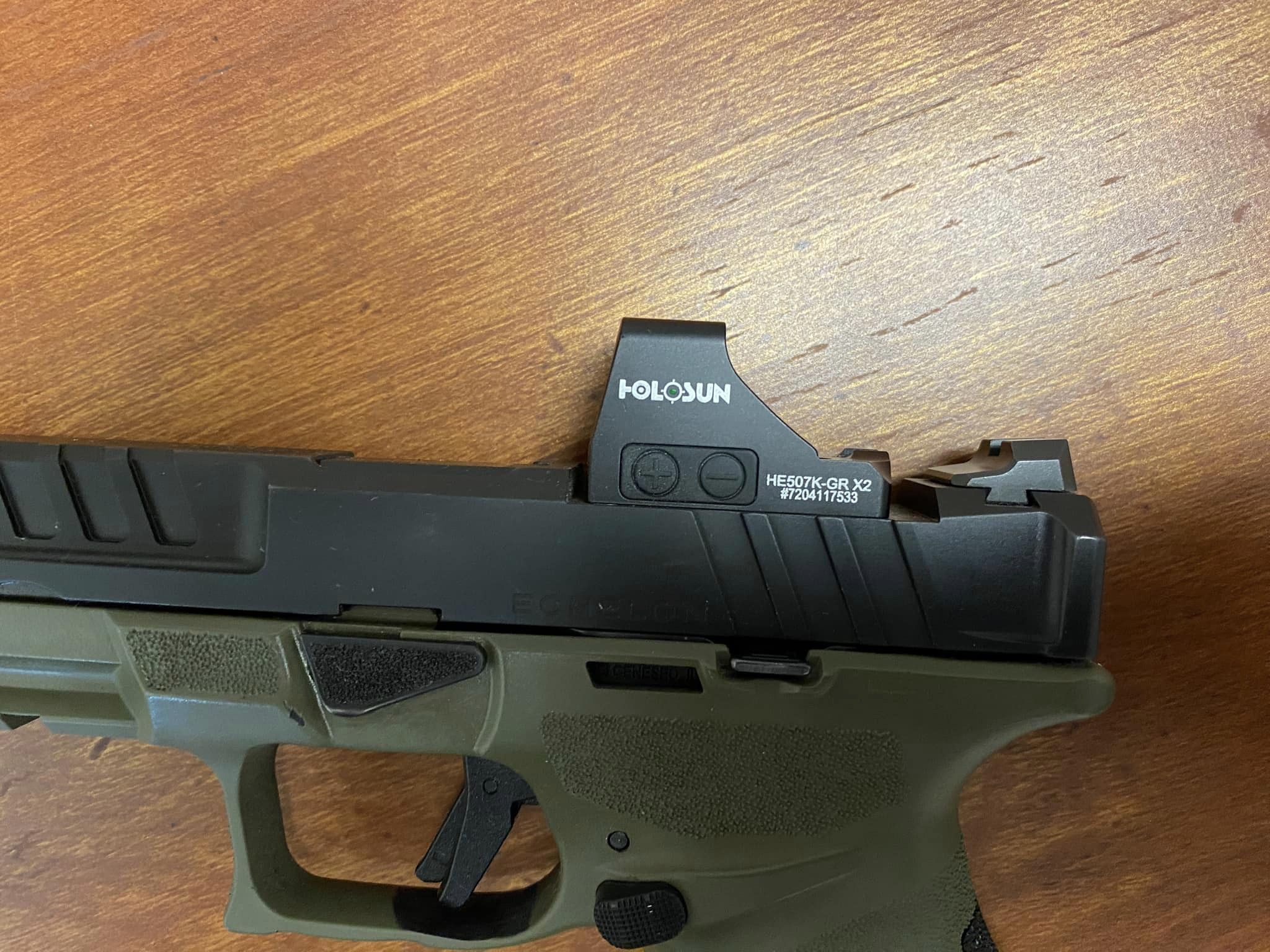

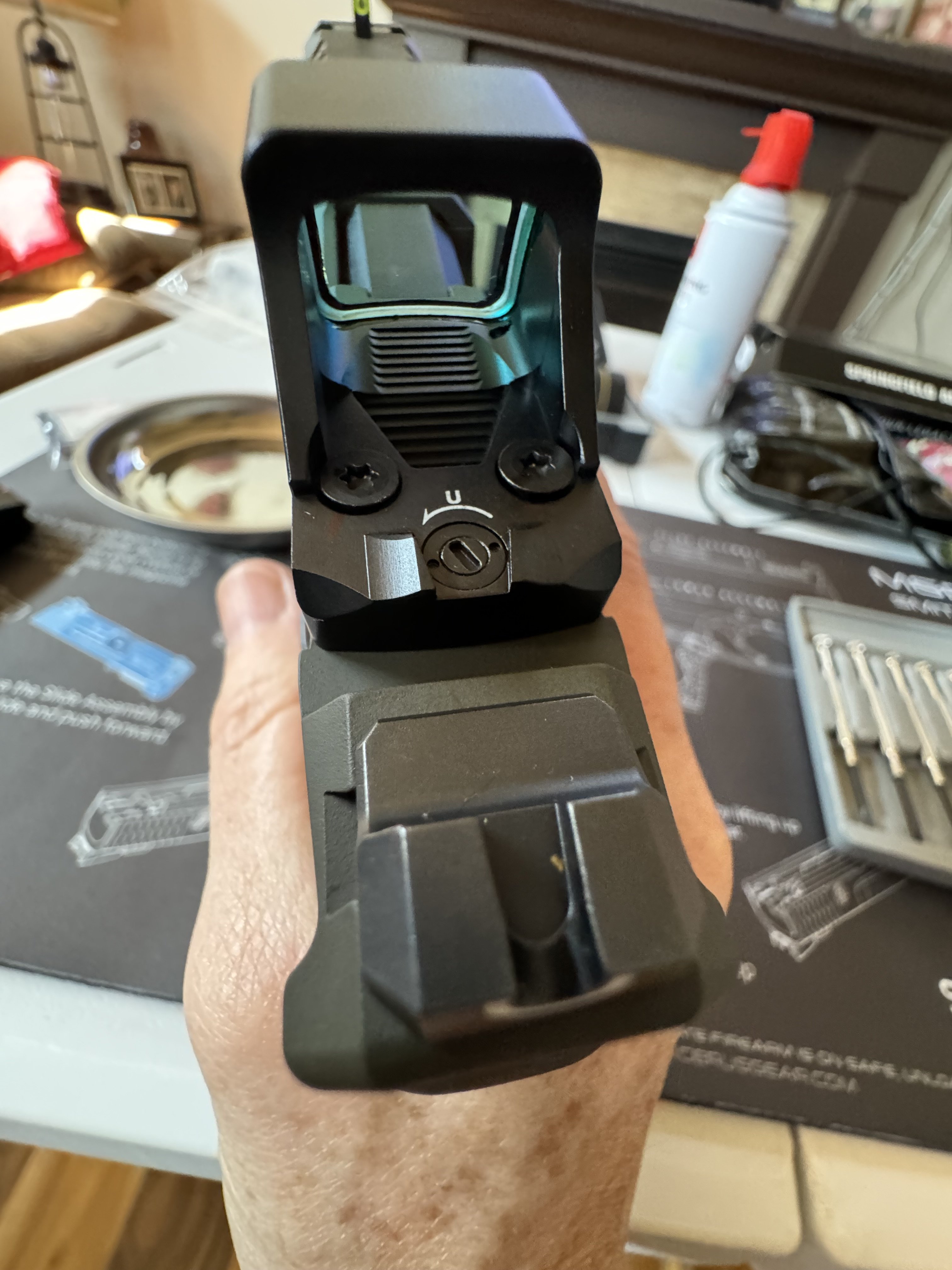

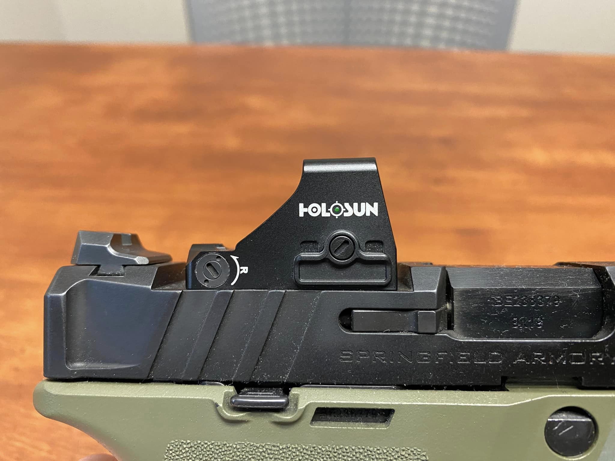

So, I didn't think it right to hijack the thread I originally posted my optic on my Echelon...so, here goes:
I installed the dot using the pin set and screw set that was on the chart in the owner's manual.
This was the result:
I noticed, as many of you did, that the rear of the optic was not flush with the slide. So this morning I removed the rear pins and it fits just fine...except that the screws are not flush and the optic is slightly loose.
So I researched it a bit and found a thread on Reddit where a few guys had that same issue, but solved it by grinding down the screws a bit with a Dremel. They said as long as the screws are ground down evenly and flat (no burrs), it worked well.
I do not own a Dremel, or a clamp/vise to hold the screws to be ground, so I am not going to dink around with it anymore. I know a good gunsmith in Moorhead I will take it to, and he can do the dirty deed. Maybe he has screws that will work without having to mess around with a Dremel. He does have a really cool shop.
As always, I am open to suggestions and advice 😎

Shorter screws will take of that problem. Have had to modify screws with a fine grit file and chase out the threads with a needle file.
This is on ongoing problem with many red dots. Pistols are all set up for different lengths of screws, so there is no certainty that the screw that comes with your optic are the correct length. You’ll also find that screws from Holosun are pretty crappy. There are some resources for better quality screws such as:
Thank you Simon! I just ordered a set after reading up on the reviews. It will be significantly cheaper than what my gunsmith would charge. Although I don't mind supporting his business, I would much rather fix it myself if I can.

FOLOW UP. So to add insult to injury, I just checked on the Archon screws again and it turns out they are for the Holosun K cut, which checks out, BUT not for the EPS Carry. Wanna guess what yours truly was mounting? EPS Carry screws are 6mm long, not 7.3mm, which accounts for the 1mm I had to take off the one screw to work. Wow!
