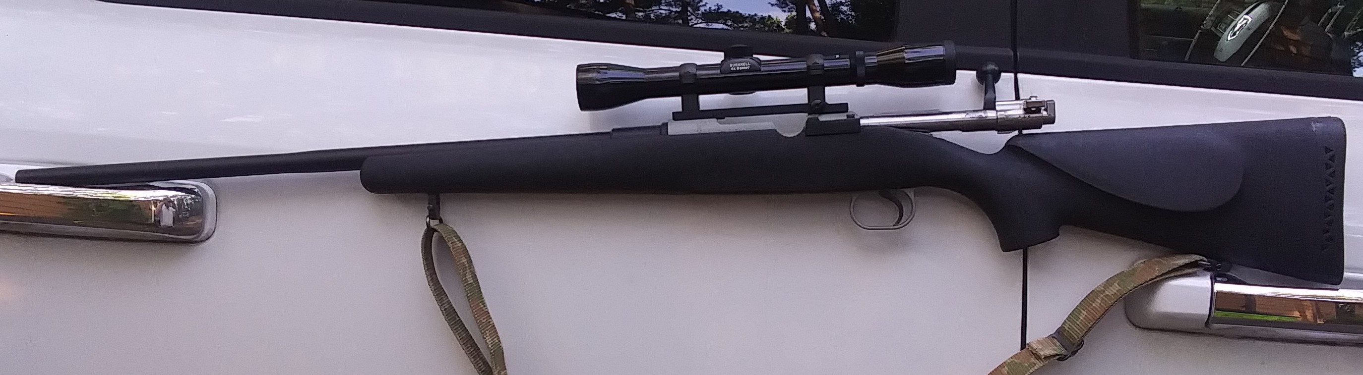

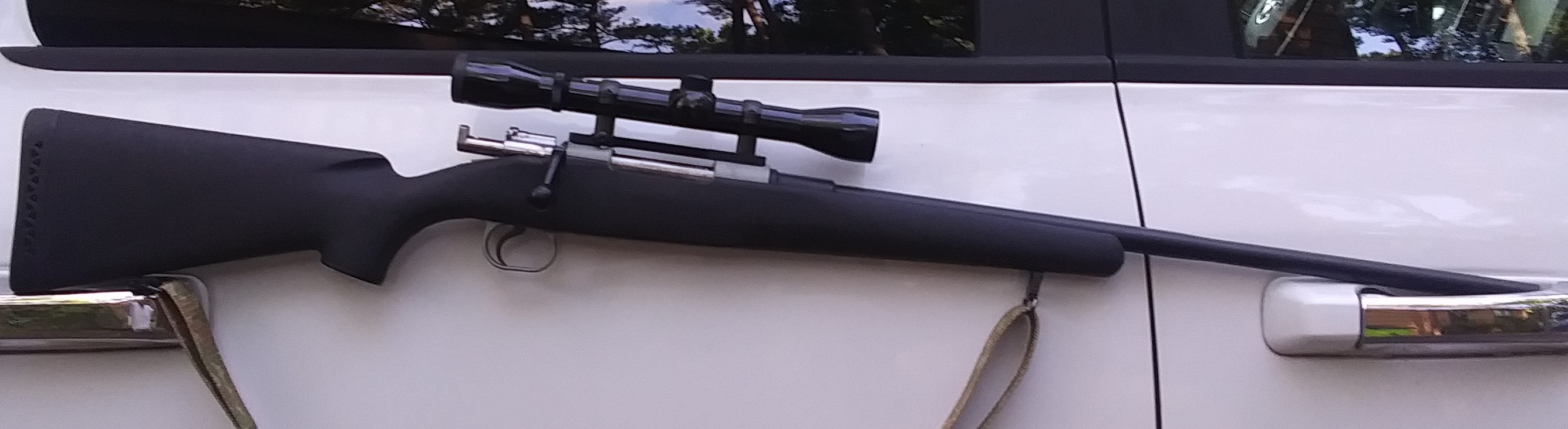

This is just a primer, this rifle was bought already modified and I've done one necessary modification, that now dictates another.
Anyway, here's how she looked when I brought her home.
4 power Bushnell scope, Leupold base and rings, unknown maker composite stock, and Multicam sling.
The stock isn't even a small ring specific one, the inletting is too large to properly fit the receiver, but the mounting bolt holes line up, so it's ugly, bit it works.
Anyway more pics, and the continuing saga to follow.....

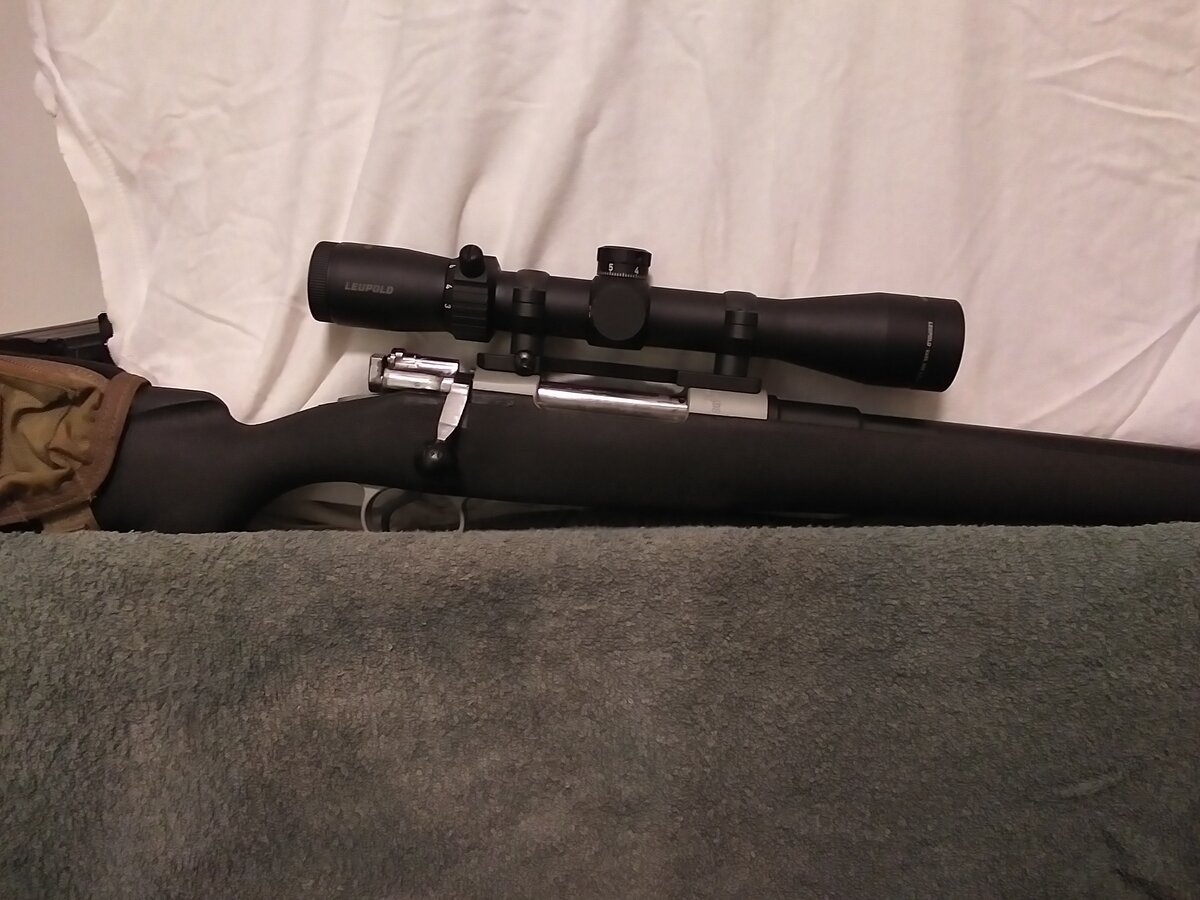

Well, I replaced the Bushnell with this.....
Little did I know what I was in store for......
I still think boresighting feels like an unnatural act lol, but I got it figured out.

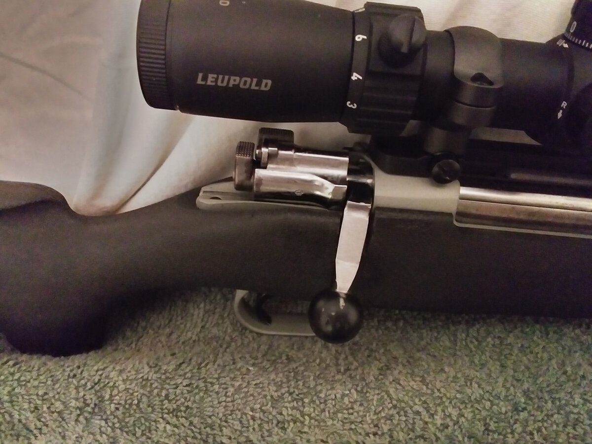

The Leupold required the bolt handle to be relieved, so, hand tools and patience got the job done. Only to reveal that with the standard bolt knob it makes bolt manipulation a tad close, so the next modification will be cutting, and threading the knob to fit an aftermarket knob that'll add an inch or two to the handle length.
Here it is so far.....
I cold blued the bare metal, and broke all the sharp edges.
Other to-do's are widening the barrel channel forward of the chamber to free float the barrel.
