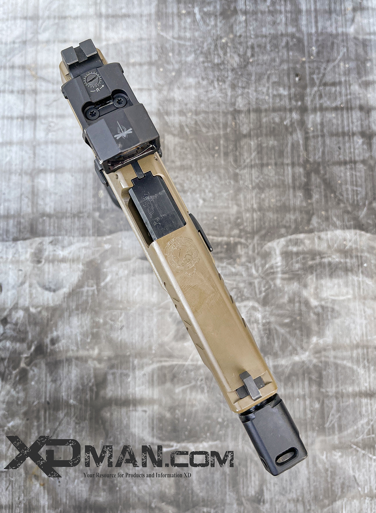

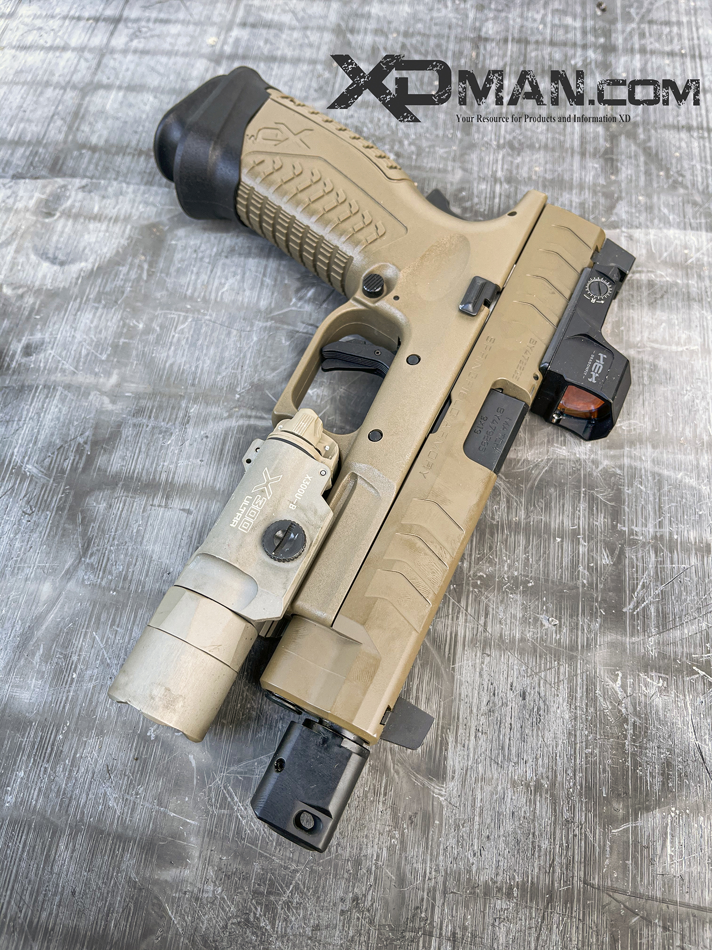

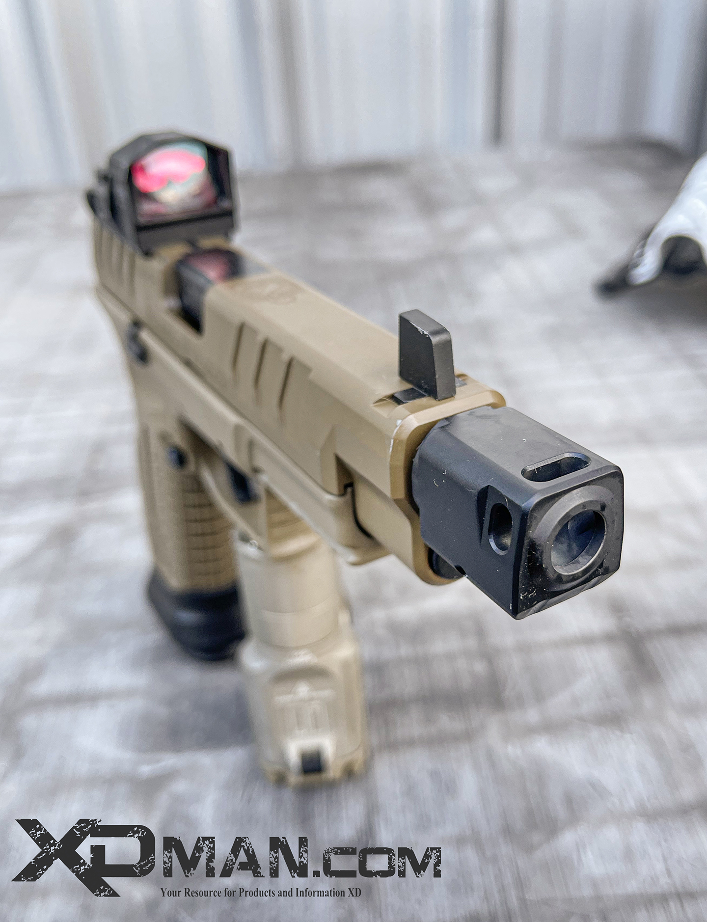

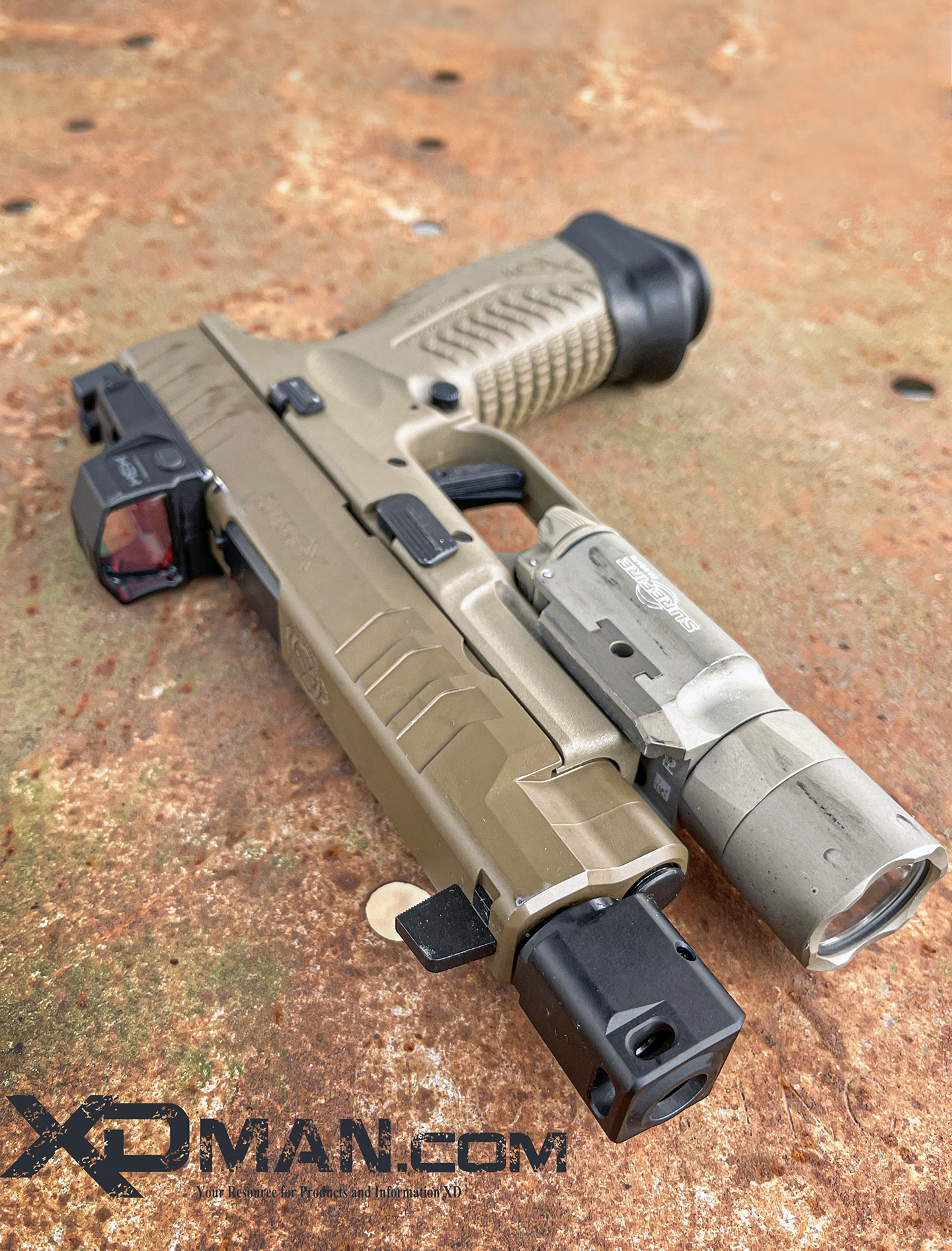

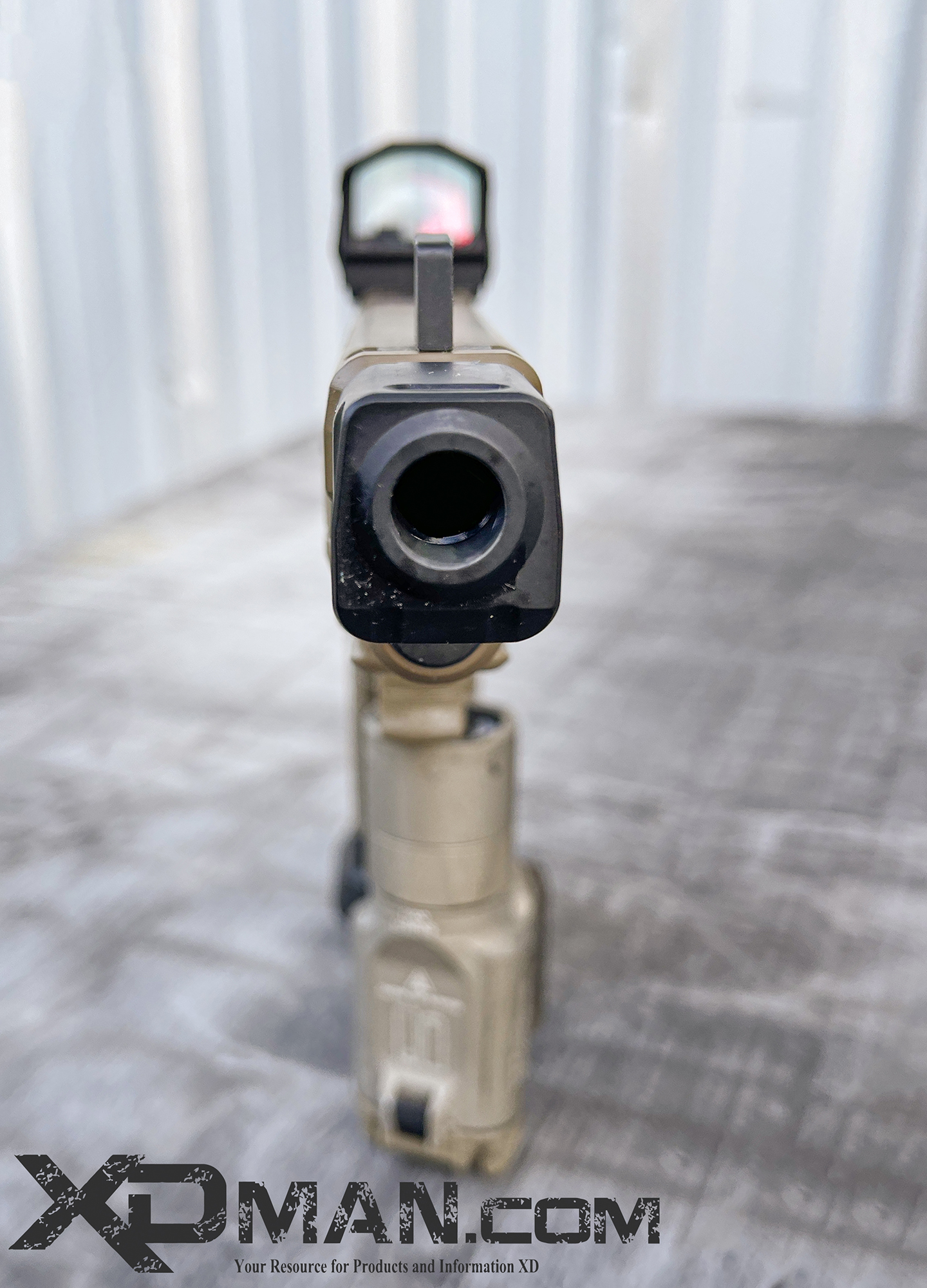

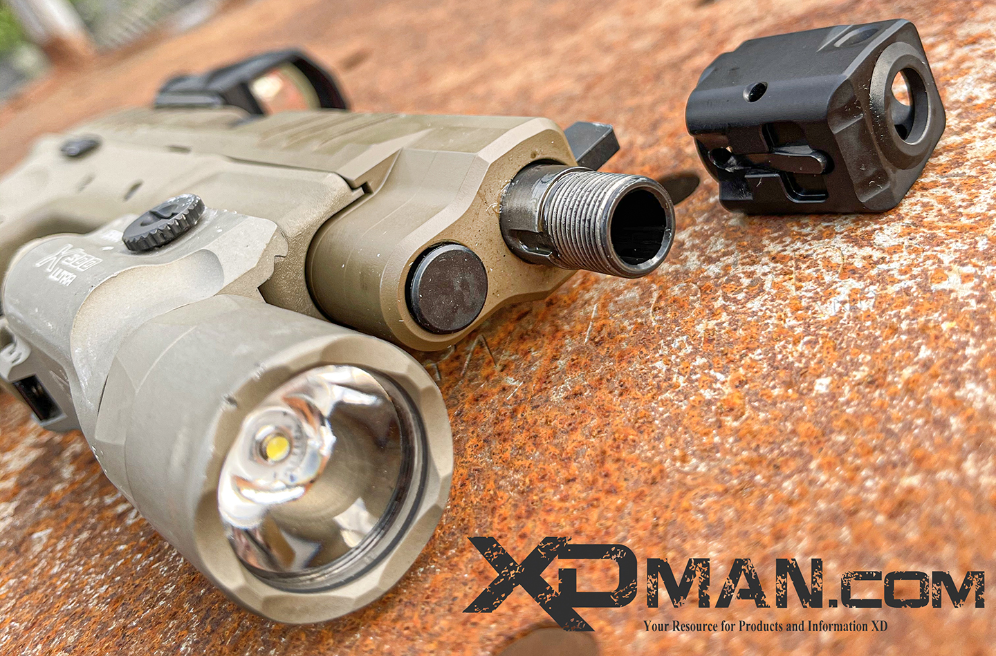

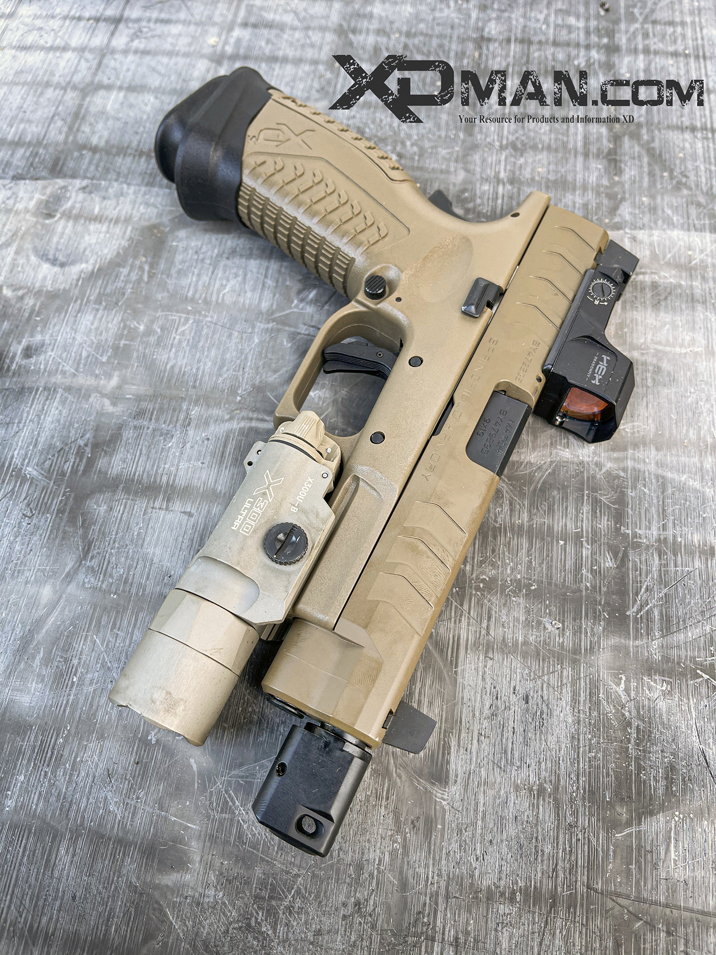

I finally had a couple minutes to go ahead and cut a notch into my XDME barrel. As soon as I got an RDP Hellcat in my hands, I removed the Muzzle Break and tried it on all my other threaded 1/2 x 28 guns. The break made the 4.5 XDME about the same size as my favorite 5.25 XDM. I love long slides and really the muzzle break on this pistol just made it shoot better. So to make the mod permanent I modified my barrel to cut the notch in for Springfield's muzzle break locking system. I like the way it looks, feels and functions. And as an added benefit my gasses are now vented up, away and slightly ahead of my Surefire X300. I am able to shoot the pistol with the light longer with out all the carbon build up on the glass. Hopefully Springfield will decide they need to make this an option. Oh before you decide to do this mod make damn sure you use a competent gunsmith, and realize that this will void your warranty on the barrel.

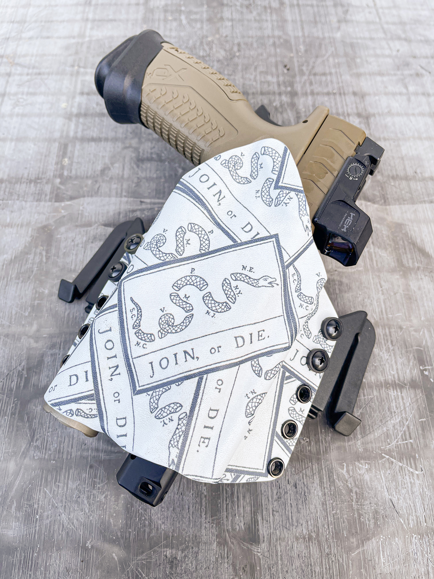

My EDC still fits in my Sindri Tactical holster ready to when ever I need it.
All SAFETY precautions were taken to get the photo, I did not point it at myself.

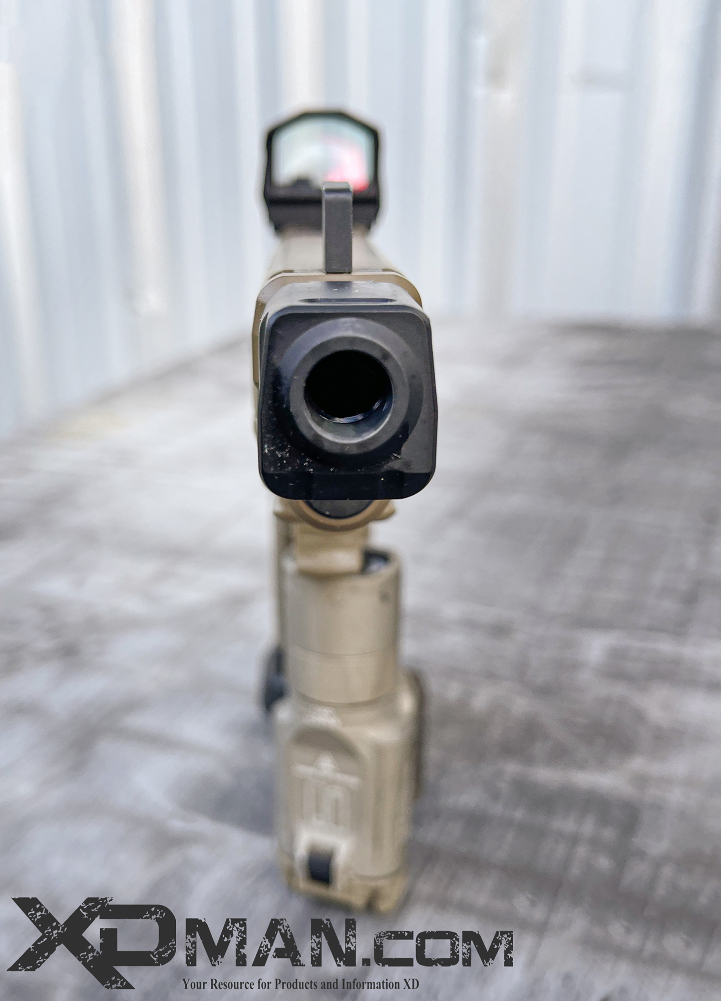

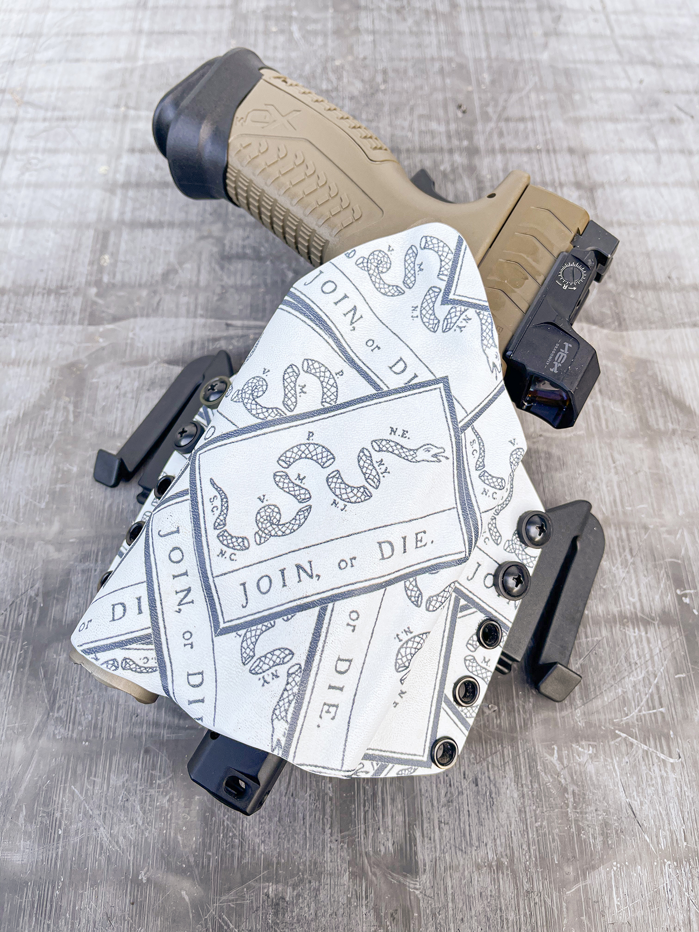

Remember I said you need a competent gunsmith, you have to notch the barrel to basically the same depth of the threads, plus you have to index the notch. The notch needs to be exactly at the 6 o'clock position or your break will sit crooked on the barrel. I guess you could always say its like an an AK47 slant break......Its supposed to be crooked.
Now what would be cooler than the Fonz, how about a dovetail cut in the muzzle break, extending the sight radius?
I finally had a couple minutes to go ahead and cut a notch into my XDME barrel. As soon as I got an RDP Hellcat in my hands, I removed the Muzzle Break and tried it on all my other threaded 1/2 x 28 guns. The break made the 4.5 XDME about the same size as my favorite 5.25 XDM. I love long slides and really the muzzle break on this pistol just made it shoot better. So to make the mod permanent I modified my barrel to cut the notch in for Springfield's muzzle break locking system. I like the way it looks, feels and functions. And as an added benefit my gasses are now vented up, away and slightly ahead of my Surefire X300. I am able to shoot the pistol with the light longer with out all the carbon build up on the glass. Hopefully Springfield will decide they need to make this an option. Oh before you decide to do this mod make damn sure you use a competent gunsmith, and realize that this will void your warranty on the barrel. View attachment 18098
