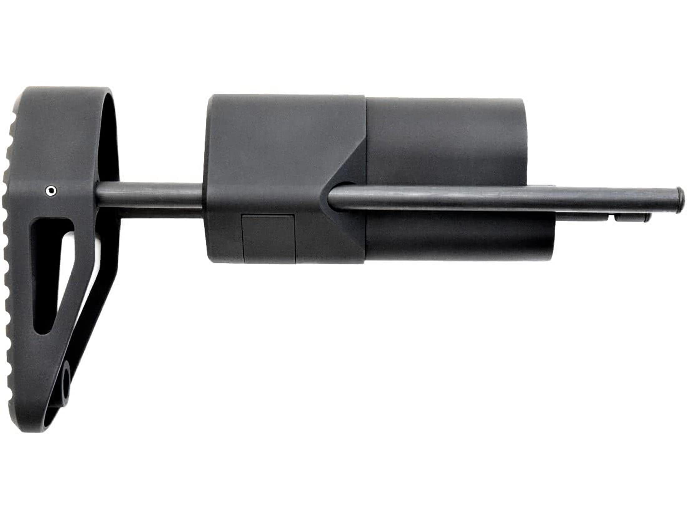

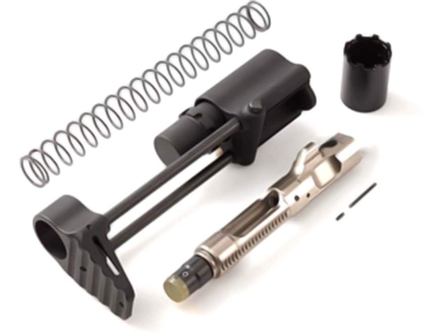

https://www.midwayusa.com/product/1024818739?pid=461437 is offered in 3 barrel lengths.

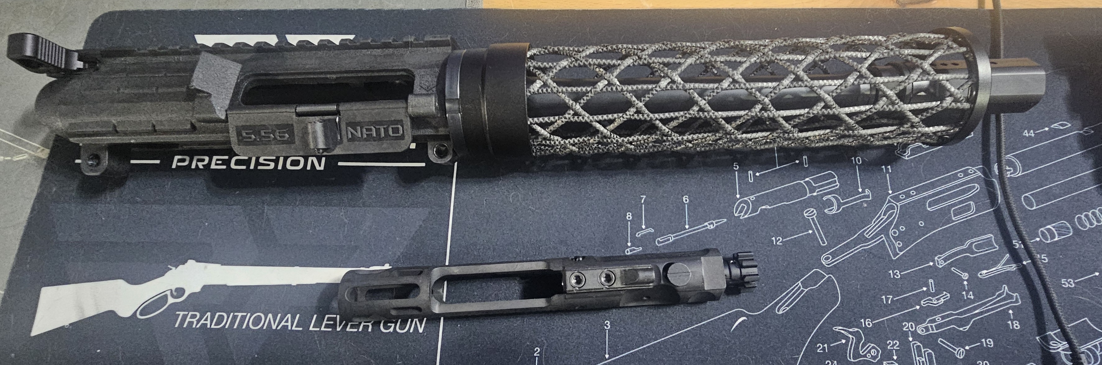

tentative build
working on a pistol version build and clearly unsure of rules of so. I'll add pics/links of what could be possibilities?
I will state this about the radial delayed blowback in 5.7 compared to the ps90 and the ar57, there's less sight movement on the rdb than the other 2. No experience in the hk version, but the rdb is very smooth. I'll be getting pistol versions in 9 and 45 also. I'm using a carbine length tube that DOESN'T accept stocks (it's made the same as a pistol tube, but longer). I'm using a flatwire spring w/ 3oz carbine buffer. I might try as far down as 2ozs as that's even less reciprocating mass.
