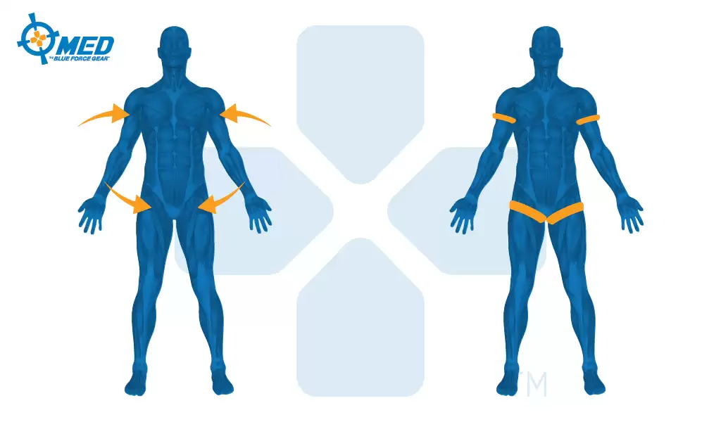

Tourniquet Placement
Tourniquet placement and usage techniques in a non-emergent environment differ but are beyond the scope of this post...
Here are the four locations for tourniquet placement:​
^ BFG is good stuff. Thank you for posting that. (y)

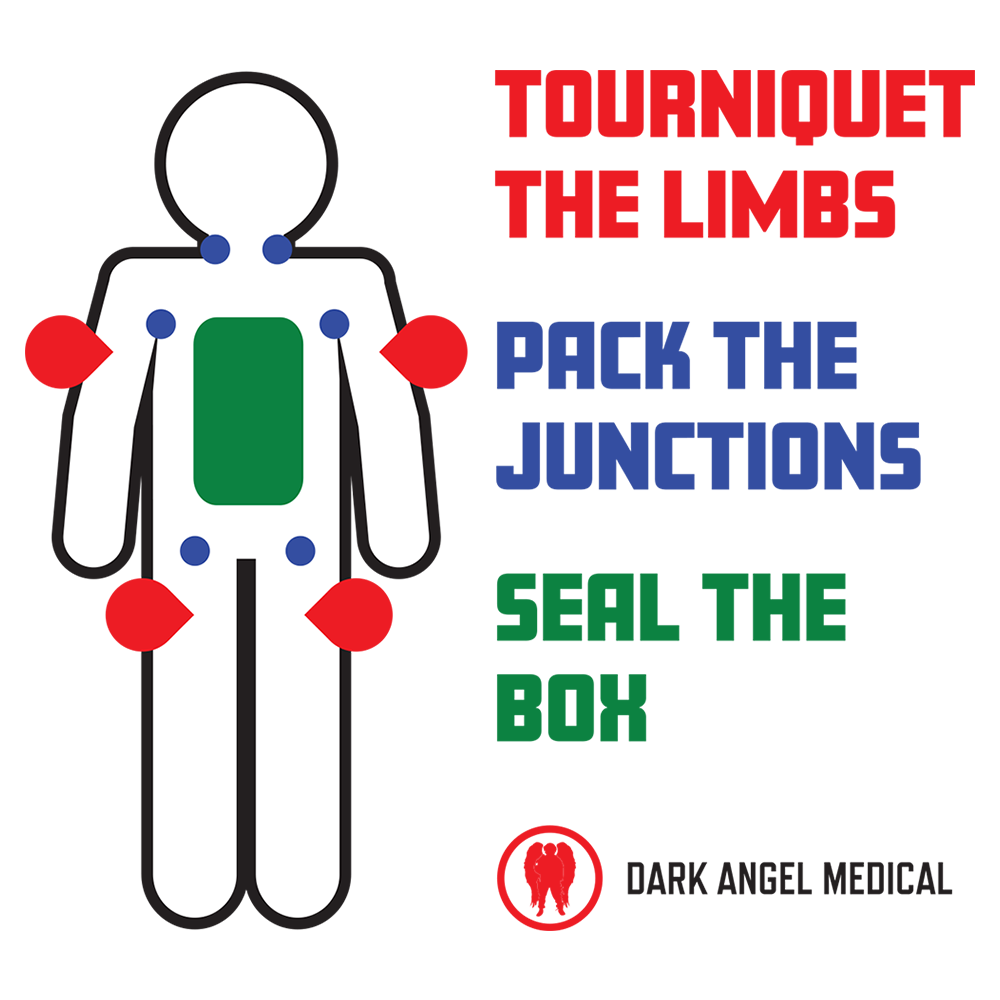

Same for the following entry appearing in the Dark Angel Medical blog:
And unlike what we previously were taught, TQs will work just fine on "two bone" compartments, such as the forearm and lower leg: NAR - two bone compartments [graphic images in this post]
