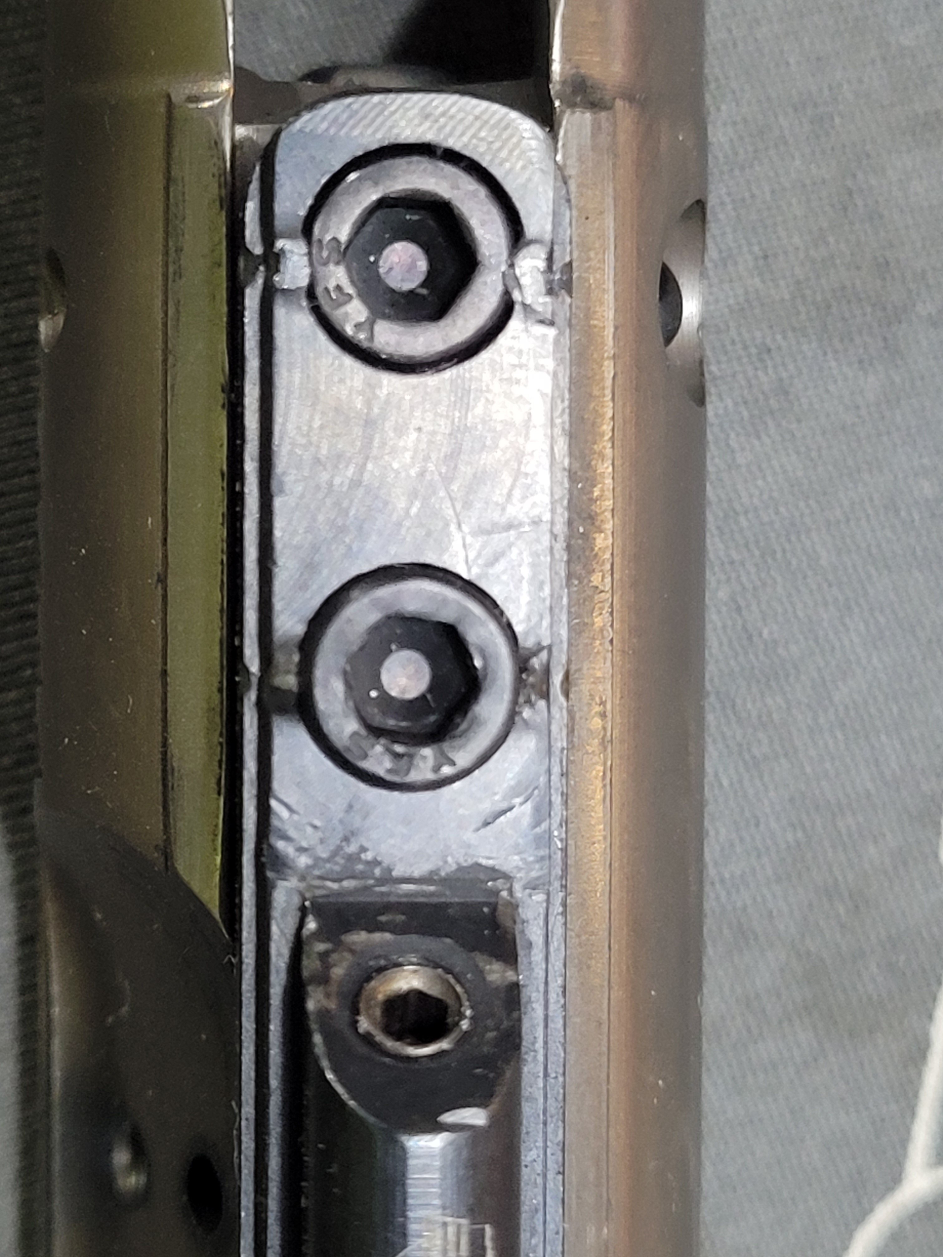

@Rusty Shackleford - my thoughts mirror those of
@TEXASforLIFE 's - just because it's staked ( and the quality of that we'll set aside for now, for the sake of keeping this reply simple
), it doesn't necessarily mean that it was either installed correctly to begin (i.e. was it torqued correctly, was it cross-threaded, did they use sealant, and if so, what, did they true the mating surface of the gas key, etc.) with or that the hardware used was not itself somehow defective (i.e. is it the proper hardware to begin with, was it a defective batch of hardware the wasn't hardened properly, etc.).
Overall, I have the same advice for you that I gave to
masterchither in the XDTalk thread, below:
New Sig PM400 tread pistol. 1st cleaning after 300 rounds. Possible issues with bolt carrier key. It wiggled just a little bit. My question is that normal to wiggle just a little bit? I was able to tighten it back. Is that something to be concerned, or necessary to contact Sig?
www.xdtalk.com
As I noted there (same screen name as here, albeit with a different Avatar), what you decide to do here can be based off a simple matrix of whether the gun is "hobby" versus "serious use" and whether you are more or less comfortable performing your own mechanical work.
Even as a beginner, I believe that the videos and resources that I cited in that thread should be sufficient guide to help you effect the necessary repairs in a definitive manner. Stoning the replacement key is a value-added step that few folks I know actually pursue, and while a specialized staking tool will make the job easier as well as more fool-proof, staking using standard hand-tools (including those that are self-fashioned: there's more than one top-tier gunsmith that I know who love to use old, broken punches for staking, and their stakes look delicious....) is absolutely Kosher, as long as it is performed properly.
In all honesty, the only specialized tools that I think a beginning AR-hobbyist actually *_need_* are the proper torque wrenches for the various fittings. Everything else can be "redneck-engineered" to some degree or another.
