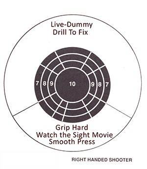

Our solutions-based updated pie chart looks like this:
Unlike the classic pie chart, the updated version gives simple advice for correction, if the shooter is willing to invest in a few dummy rounds.
The drill can be shot slow or fast, on close or far targets – whatever skill you are trying to master. Try the updated chart and the live-dummy (or live-empty) drill on your next range trip or use them to help a buddy shoot better.
