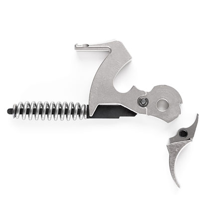

good price and pull weight, but hate having too replace the hammer! easy to do, but i've done well by replacing the springs, cups and trigger only with about the same amount of money. springs are low-cost way to improve/reduce pull weight, but getting rid id the ole "marlin flop" is nice! don't own a henry or a rossi in 45-70 or any henry for that matter. maybe someone with more insight that uses lever guns more often than i will post

After reading this , I decided to get my 1970 model 336 out and check the pull weight on it. 5 pull average was 3 LB 6 OZ . I don't think I will be spending the money . The new models must be really crappy in the trigger department.
i don't have any levers that old. the r92 pull weight is around 5.5# and the 2 1895's from factory were about the same. the sbl got an upgraded trigger/spring/cups from various places and now is sub 3# or less (haven't checked it lately). kept the 26" cb model all factory.

The sbl trigger I replaced with a ranger point precision only got rid of the trigger flop. Changing springs and cups reduced pull. The shoe is a little wider than og. The price was good as for reason of posting. I keep all parts that get changed and saved, tagged and stored to hopefully not lose them? I removed the adjustable rear sight on an XDM. The pin that holds it on (10mm) is shorter than the 40s/w model of the same (both are 5.25"). Not sure what that deal is? A buyer wants the og site, but I need the correct part before that happens. I would use the 40, but my son likes it too much. He called "claim" (TWD reference) on it.
